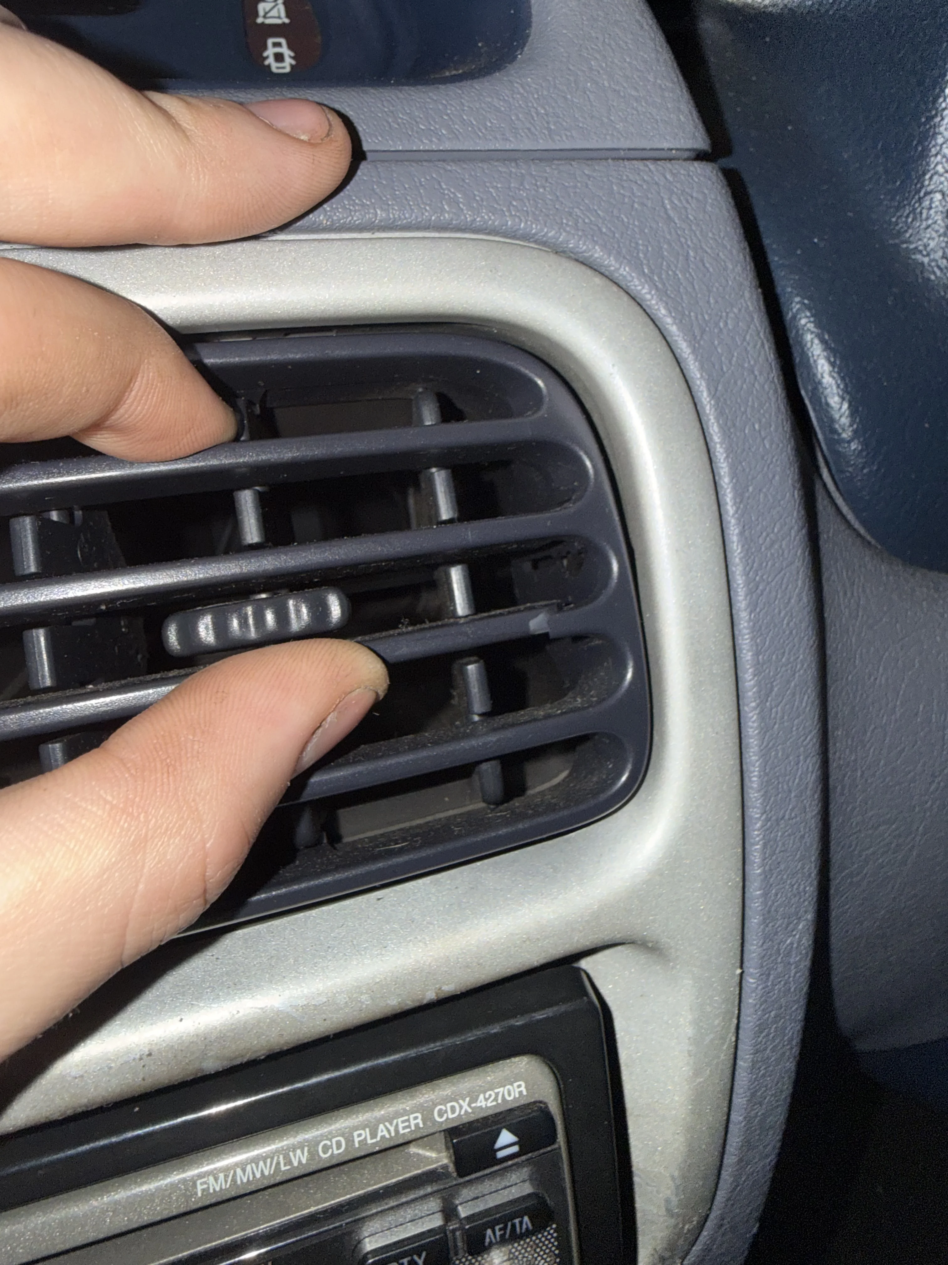

Where does everyone get the centre air vents from and how hard are they to change? One of my stupid friends has snapped it when he was sat in it. Lesson learnt with that one.

definitely, i have told them multiple times be careful it isn’t the most durable thing but i get ignored. Didn’t even say sorry for it either.
I’ve just ordered some 3D printed ones for it. They will do, i may look into getting some off a breaker. I’ll see how good the new ones are. When i took them out they exploded, they are definitely not durable

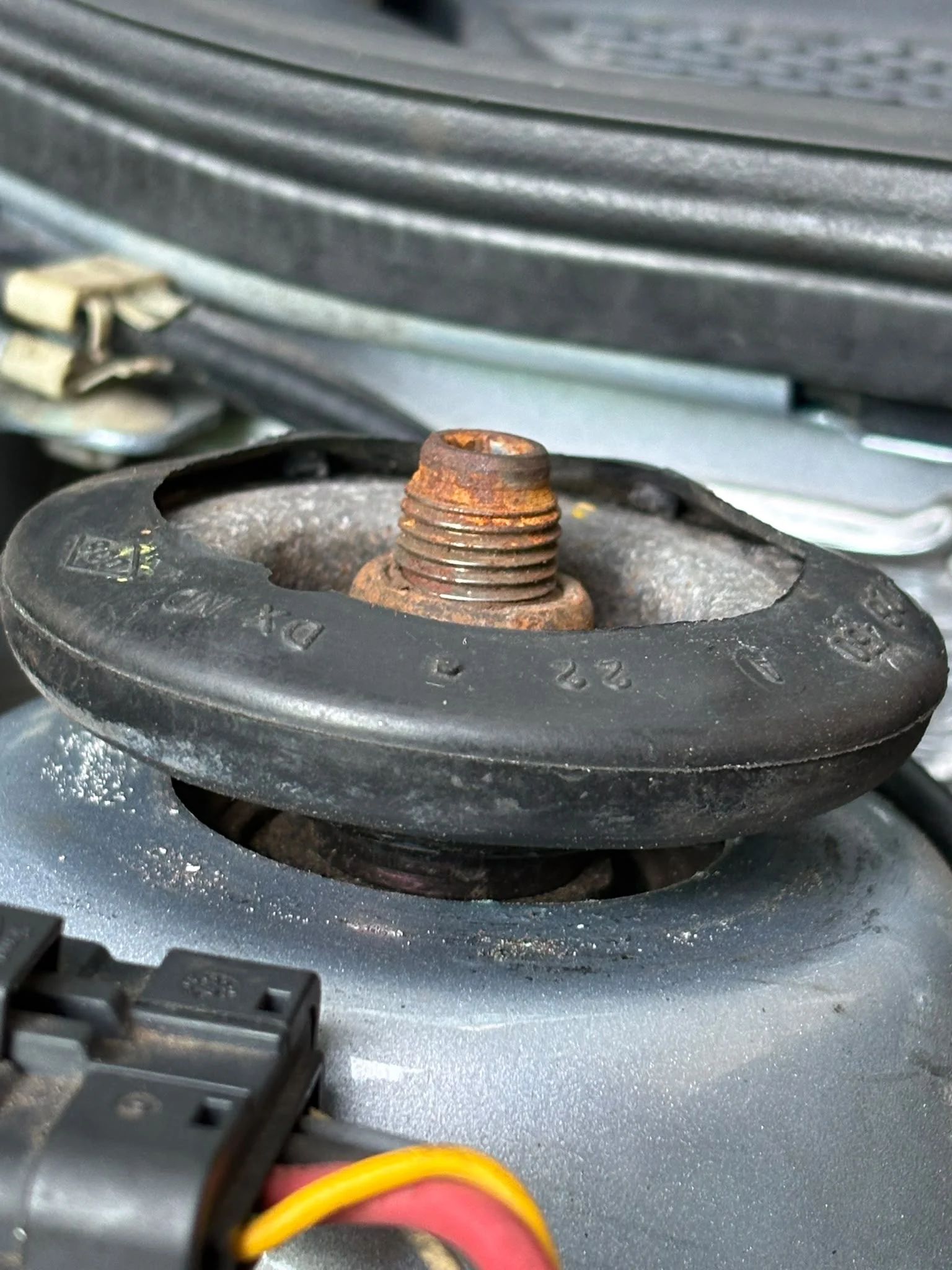

Yet again, even more issues with this cursed Clio. It's been away at Cormorant Motorsport having the 'new' box, clutch, both CV boots and was meant to be having its MOT tomorrow. That was until I had these sent to me:
As you can see and hear, them top mounts are completely ruined meaning no Mot for this car anytime soon. The specialist decides to take one shocker off to inspect it on his own back and apparently someone has cross threaded the nut onto of the shockers and misses out something on the top mount so they are ruined and need replacement. Yet more parts to change on this thing, great. Im going to have such a great time removing these.

Is there much difference between the normal 172 and 172 cup shocks and do we reckon I should change the springs too while im there?

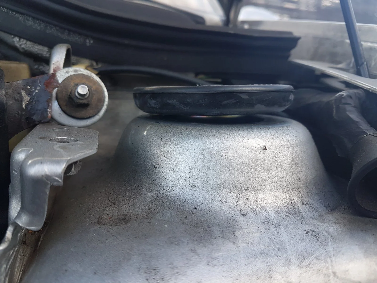

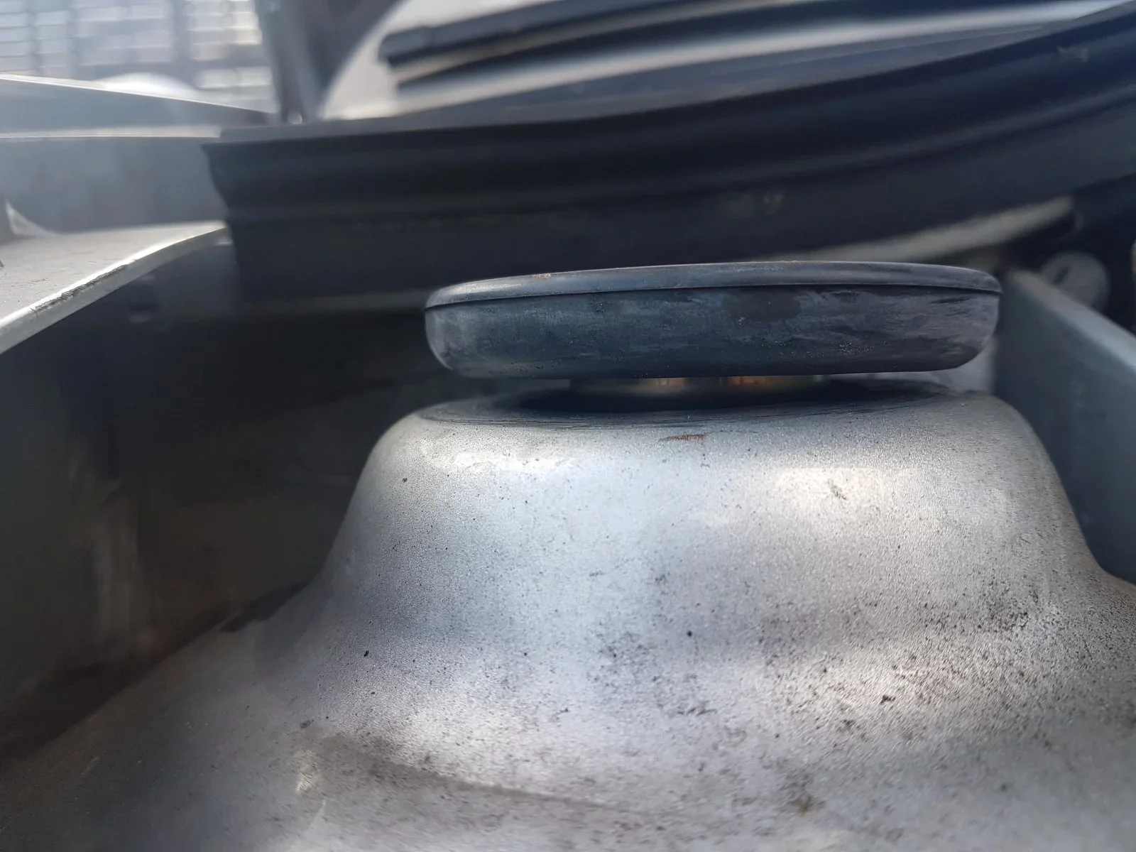

That top mount is not an mot fail being honest, advisory at best. You will fit new ones every other year if using standard ones
On the new style top mounts the gap is massive. Dont get me wrong, yours will be knackered but £20 a side and half hours work.

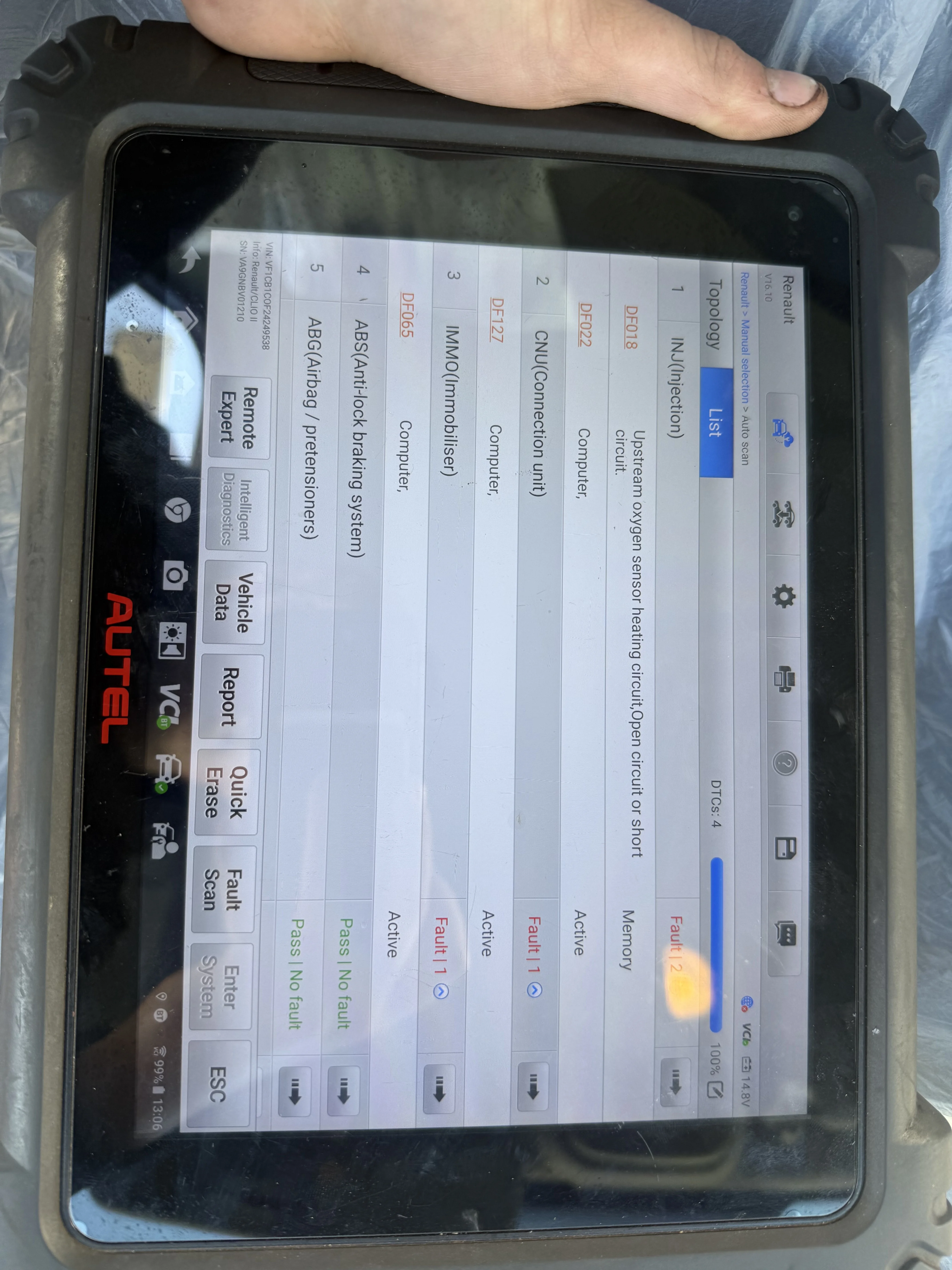

These are the fault codes it’s giving me:
Anyone have any ideas on what can cause them issues? Obviously that’s not Renault specific code readers so it’s a bit vague. No EML has come back though.

Today, i checked over the car fully and it’s highlighted some issues. Firstly the NSF shocker and top mount is ruined, OSF isn’t too bad but that side is bad. The threads are so bad it’s in need of a new shocker and top mount.

I could re-thread them but i was advised it would be easier to get new ones. Having said that i may just re-thread them now.
The specialist exact words were “Someone’s cross threaded this and just sent it with a gun. It’s really bad”
They are incredibly bad now after he forced them back onto the car. I’m 100% not touching the other side, the top mounts ok so it can be left alone.
