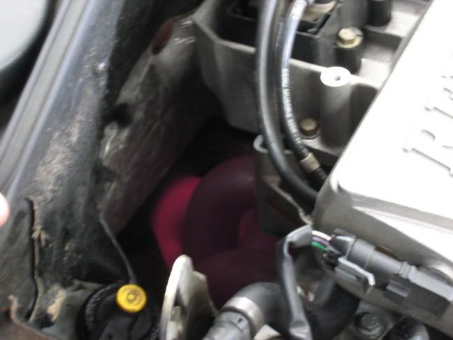

the 172 uses a 4-1 manifold
the 182 uses a 4-2-1 manifold which is awesome
Quote: Originally posted by Clio172.fi on 15 June 2005
My Mk1 172 uses good looking 4-2-1
2000 Model that is.
you sure???
all mk1 and mk2 172s have a 4-1 manifold
got a picture??
thats the Catalitic converters, the mk1 has twin CATS
the manifold is a 4-1 on the mk1 (the manifold is the bit between the engine and the CAT)
Thanks! (still embarrassed by my first ever post in here :D )
