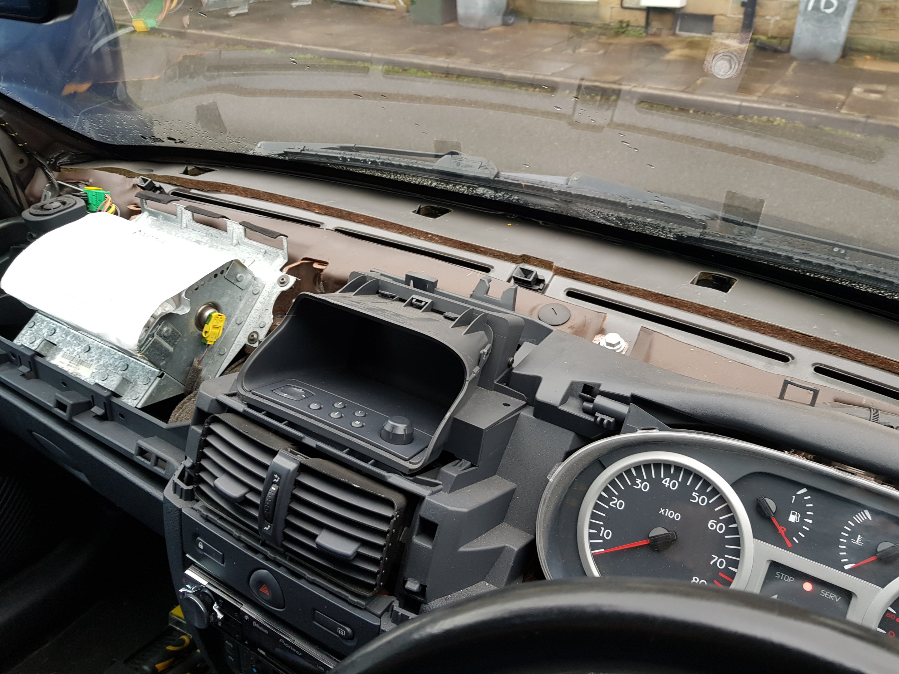

Removed dash, all seems connected just fine. I can get it to say 'softer' when I press + or - buttons. Apprently previous owner had it In standby mode and screen hasn't come back on since.

There's no standby mode that I know of that stops it from coming on with the Ignition.
You can try removing the earth for half an hour to reset all the system, but I'm pretty certain there's no standby mode. Be nice if there was as I hate having to turn off the screen everytime I turn on the b*****d car.
I'll check later when I get in the car whether she says louder and quieter still with the screen off.
Yeah, I don't think there's a stand by mode.
I don't understand how it's giving directions, but the screen isn't on ? Directions to where ? lol!!
Have you taken the CD out and put it back in again ? Other than that try the connections on the actual unit & the back of the aerial on the roof.
Makes me think the screens blown and he's just managed to click through to get directions
  Megane R26
No idea where it was guiding me to! Was on the way home from picking it up. Buttons are lit, screen isn't. I've reset ecu, had dash off and unplugged everything and re inserted the CD.
Must be the screen. Will be fun tracking one down.. ?
