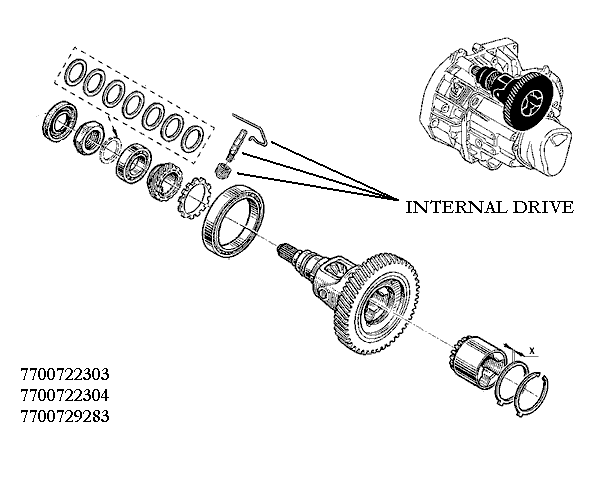

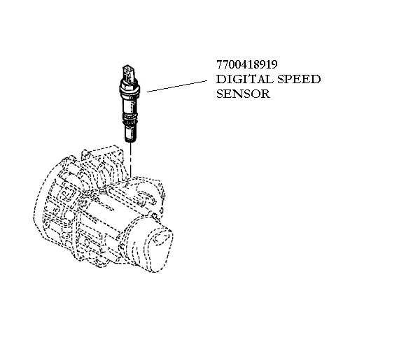

does any one have any photos of exactly where the sensor is....

Theres 2 parts.
Theres an outside pick up sensor that is screwed onto the bellhousing - this slots into the internal speedo drive which is powered by the diff. If its the internal one at fault its a gearbox out job im afraid. If its the external one just unscrew it and fit another.
99.9% of the time its the internal one !!

Theres 2 parts.

Finally got around to fixing my speedo!!
Ordered the external sensor from my local dealer for £18.99 (Cheep I thought)
While speaking to the dealer he said that there are fitting these all the time at the moment and is very common.
Fitting is a piece of Piss the old one just pulls out and the new one just pushes back in, Very easy 5min job just wait till the engine is cool though unlike me!!!! :)
