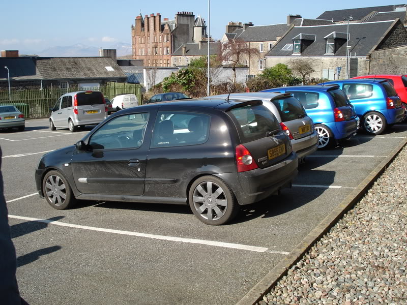

I mean it used to bounce a lot, like the front end "bobbed" about, it completely stopped it doing this with the eibachs. Also when i say bottom out i dont mean it scraped the road, it just felt like it was reaching the end of travel on the dampers! Was fine driving about on smooth roads, but I found it almost dangerous pushing on over bumpy back roads, whereas now it remains controlled and is much more forgiving! Just it doesnt sit as high!
Pic here... http://www.n3bcars.co.uk/images/cliorims1.jpg
  Suzuki Swift Sport
ps I think it sits lower now the springs have settled, that pic was just after they were fitted!

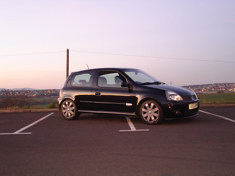

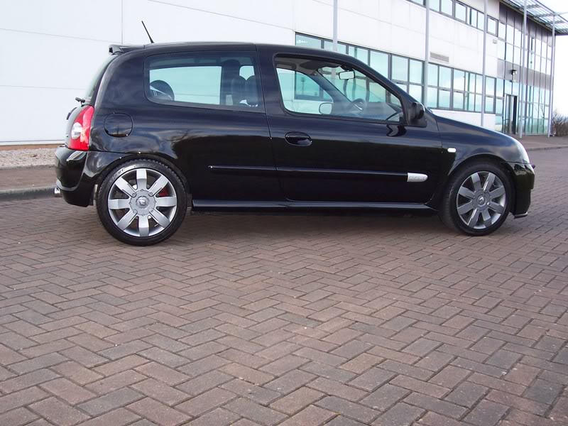

My old 182 on eibach sportlines:
  clio 172 FF
that top pics quality!!
is that fully settled in those pics?
eventually how much did it lower ur car do u reckon?
its looks a lil higher in sum of those pics than others
