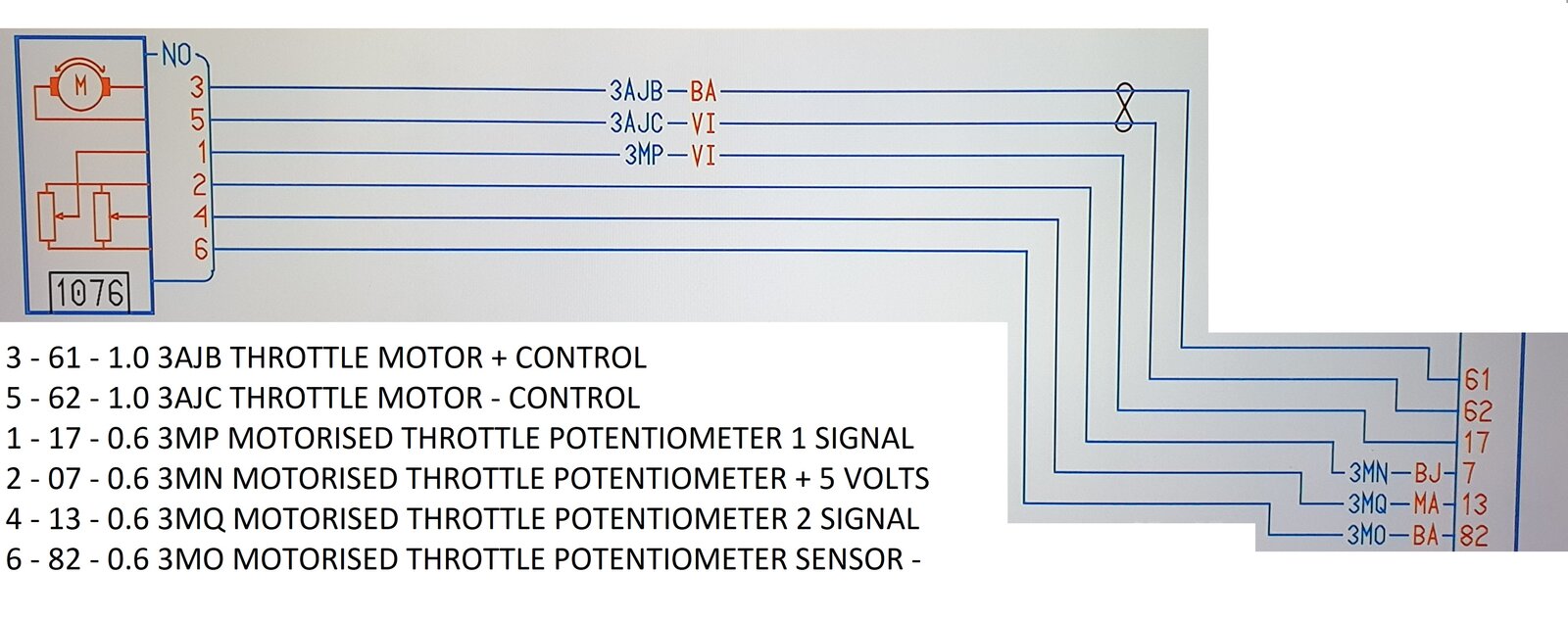

Hey guys, bit of a Q
I have a bit of a mismatch ITB kit, have the Gen90 and some Bike ITBs, the plug on the TPS is a three-pin jobbie and obviously, the OEM is a six-pin.
Deducing from wiring diagrams I get to this.
I'm on the thinking I won't need pin/wires 3-61, 5-62 and 2-7 from the OEM Body?
Failing that i'm wrong, I'll have to identify the TPS that came with the kit and see if any other fit/work or find an adapted loom..?
Thanks
  Clio 172
Hello, if your TPS is 3 wire only you need only 1 potentiometer like 1 5 6 or 4 2 6 check the wiring with a multimeter and with ignition on and you wil have 5 V beetwen 2 (+ ) an 6 (-) and the other 2 wires will be Signal from potentiometers. (1 and 4 )
