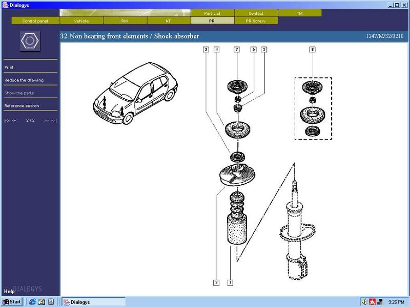

Mine are shot, how easy are they to change? Can it be done on the car or do the struts have to come off?
Forgot to add - front ones.

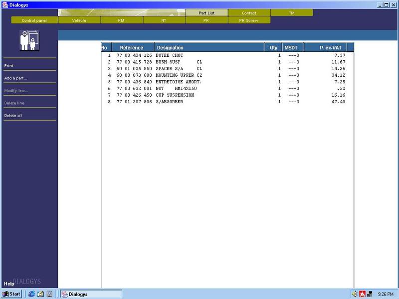

The struts have to come off, not too hard as long as the lower bolts come off freely. Heres a useful diagram and part numbers the kit you will need is number 8:
