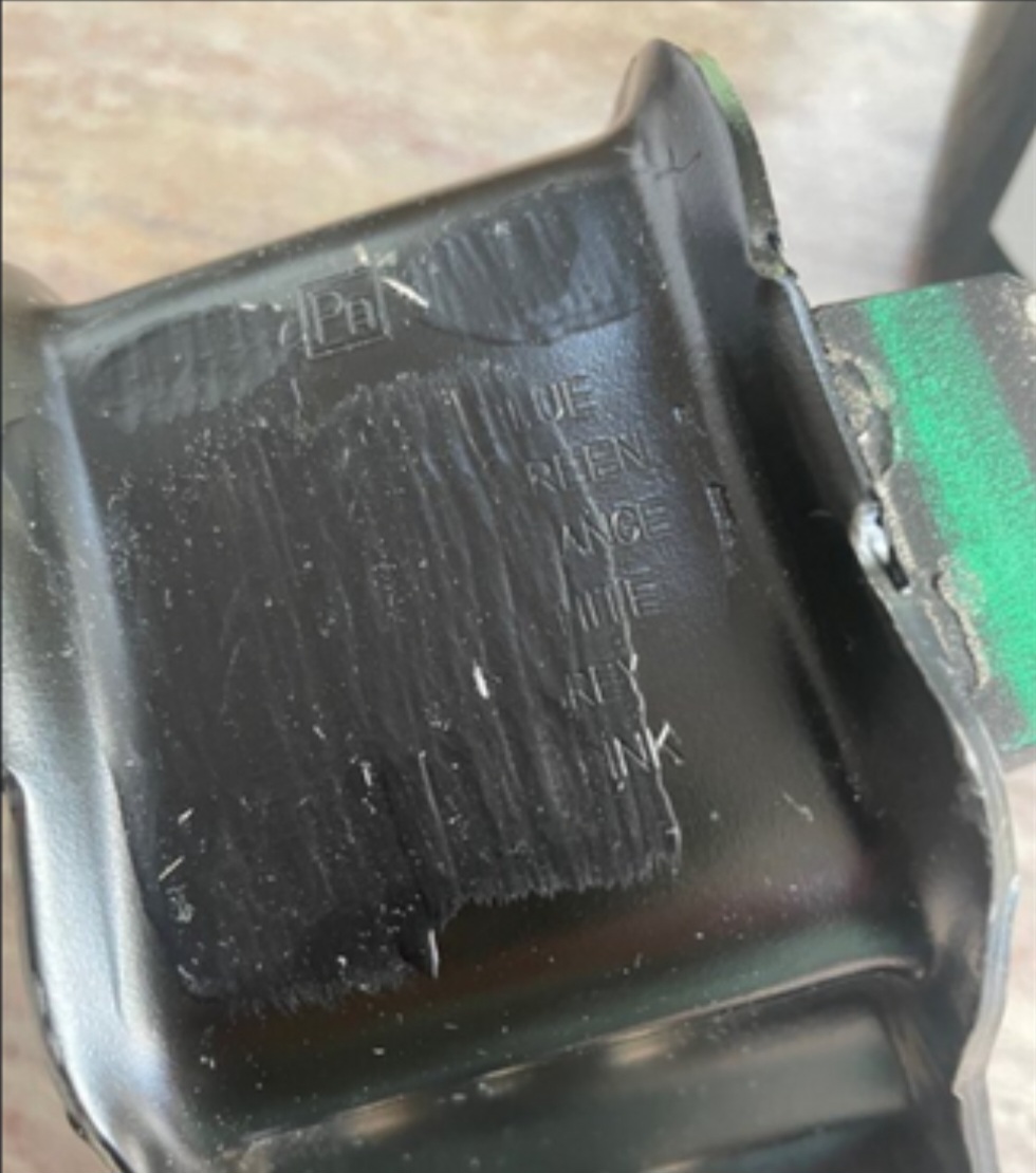

Hi @RS200SGP - if you can find Hutchinson mounts they are apparently the OEM manufacturer for the genuine Renault ones. You can usually even see on the upper engine mount where they have ground the Renault part numbers off :D

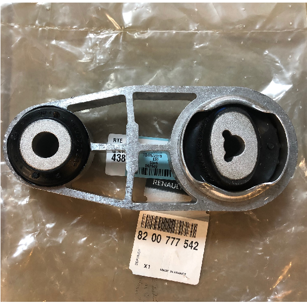

I am currently running them on all mounts apart from the upper torque arm which is a Febi Bilstein, as I couldn't find a Hutchinson one in stock. I am also running the metal Meg 2 version of the lower torque mount rather than the regular rubbery Clio 3 one. Links to mounts below:

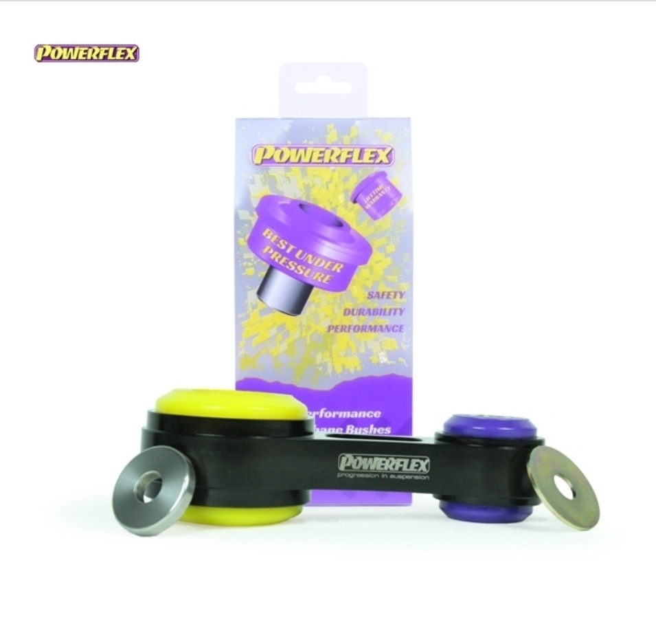

Re: powerflex, I ran one of their lower torque mounts for a while but reverted back to stock. Thus is the one I tried:
While it resulted in a lot less engine movement, it also came with a very noticeable increase in cabin vibration. And in my old age I found it too much for a daily, but YMMV.
From what I have read the powerflex insert that results in the most cabin vibration is the upper engine insert (even the softest yellow one), followed by the lower engine mount. Supposedly the upper torque arm insert results in reduced engine movement and minimal cabin vibration, so I might try that one next and see what that is like. Not sure what the upper gearbox insert is like but basically any stiffening of the mounts via powerflex will result in some level of increased vibration, just depends on your tolerance level! But depending on how shagged your current mounts are, even new fresh OEM ones will make a noticeable difference in my experience.
