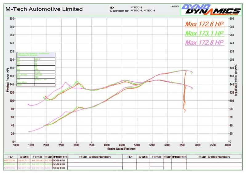

I took advantage of the free rolling road at the RTOC Festival on Saturday and got a heathly 173bhp.
That's with a cone filter and custom st/st cat back.

They have just uploaded them on FB.
And I stand correct its 173.1 bhp.

Good figure :)
I use their rollers sometimes myself, always get sensible figures.
Looks like your roller sync was a tiny bit out though, so its probably slightly over reading on the torque, just by a couple of lbft, wont effect BHP though.
It is considering i was expected 150-160.

They ran that in the wrong shootout mode by the looks, it was run in 4f which is 4 turbocharged 4 cylinder. Calculations are similar to shoot 4 though....

I thought the calculation was identical on a DD between 4f and shoot 4 and its only the ramp rate that is different isnt it Paul?
