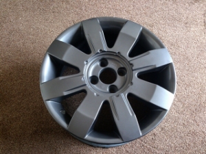

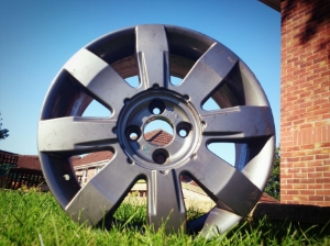

I refurbed my Anthracite 182's myself. The colour is close to the original. Majors scuffs I filled with Chemical Metal then sanded down flat, then etch primered any bare metal, primered fully with normal primer, wet sanded primer flat then painted with Anthracite paint then lacquered.
BEFORE:
AFTER:
