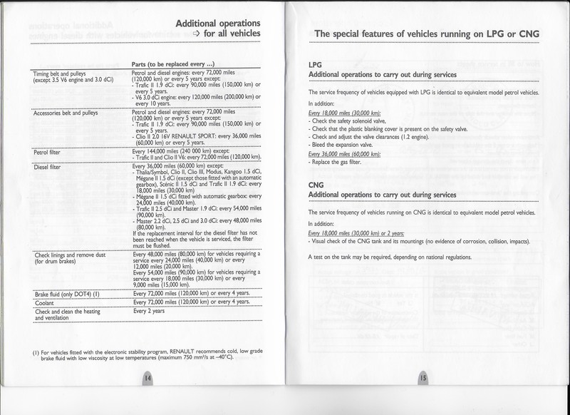

Personally I don't see it as a problem leaving it another 12 months / 3k miles and get all the belts done together. It's 5 years for both the belts , 72k miles for Cambelt etc.... and 36k miles for the Aux belt etc..........

I used to think that it was 3 years for the Aux belt , but according to the service book its 5 years or 36K , whichever comes first .

Aux belt has never been 3 years on any documentation from Renault that I've ever seen, just people on here think it's 3 years.
Personally I'd wait until 5 years.

Just had a little read and it looks like they changed it from 72k to 36k but time is still 5 years.
My bad
  PH2 172
Totally correct.
If you want to play safe on the Aux, every 24K if you are doing the miles, otherwise 60 months is fine.

I started a thread asking what it was a few years ago, no one had anything to say 3 years, and a lot of well known specialists on here all said it was 5 years 36k, I think it's just the fact most people do 36k in 3 years.

Proof.
