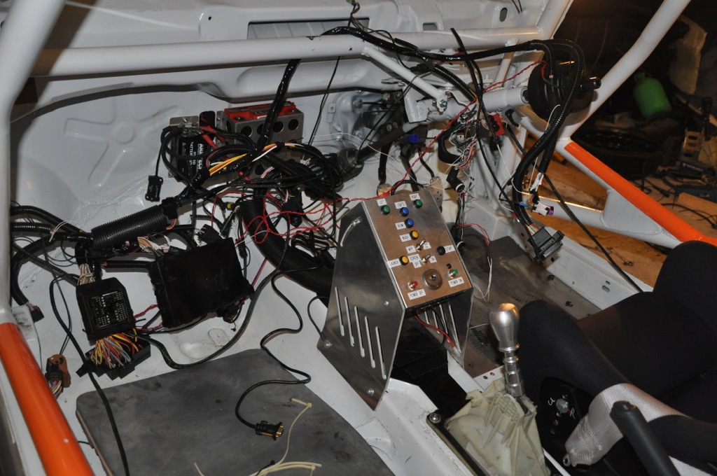

James, just thinking mate, have you found anything else that can be removed from the loom within the engine bay?
No worries :) I'm not running any standard loom anymore as started from scratch, it's the easiest way to do the dash/engine part of the loom as pairing the standard one down is very limited. I swapped to the 172 cup engine loom last year as that gets rid of the bulky ABS connector and associated wiring. Doing a new loom is a really time consuming job but the weight I must of saved by removing all the old loom, fuse boards, UCH etc is well worth it. The standard loom even when modified has to retain the two fuse boards, UCH and unless you are a wiring whizz then the std ECU too, its the method I went down when my car was originally built but the loom was a real mess
Now I have started from scratch then so much less is required and this is all the wires I need plus a few other that weren't in the car last year (Pit to car radio etc)

Yes did it all myself apart from the first couple of days being shown how to do the basics by Jay :) I had never done any wiring before so if I can do it anyone can! The most difficult thing is making it look neat and that take a lot of time.
UCH is Renaults version of a PDM (Power distribution module) so it is full of little electronic modules that do the job of traditional relays and flasher relays etc :)

The UCH is the black rectangular box in the dash its also seen in that first photo I uploaded and is in-between my old switch panel and the fuse board/connector if you can see it
Yep gotcha, found that on my wiring tasks, wasn't sure which it was but now I know.
