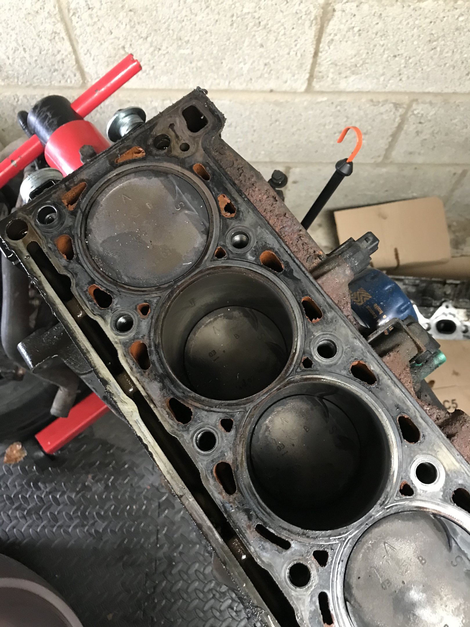

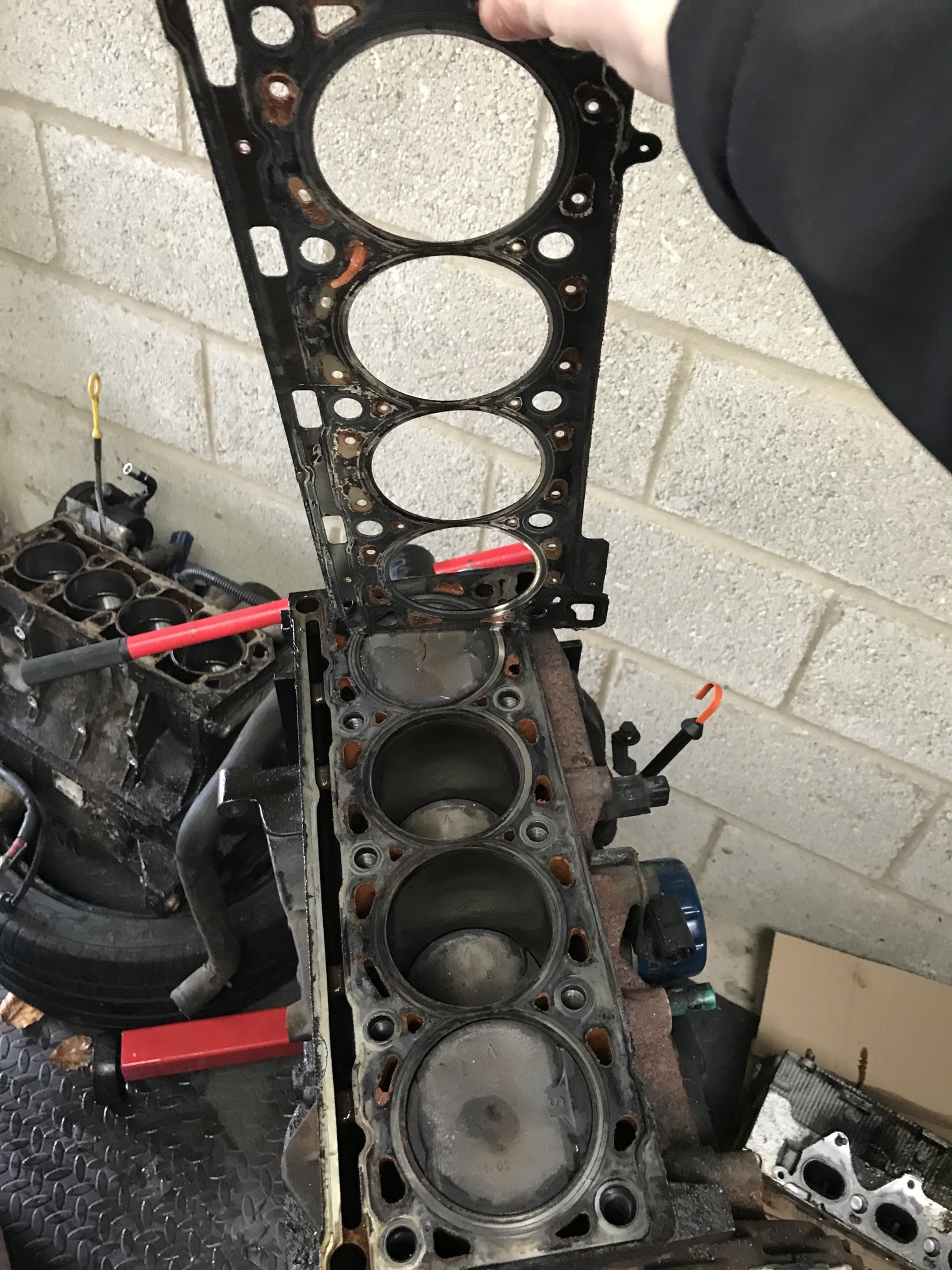

Got the head off today and it’s all abit rusty inside! And evidence of k seal too. Should all be okay once I’m done with it.

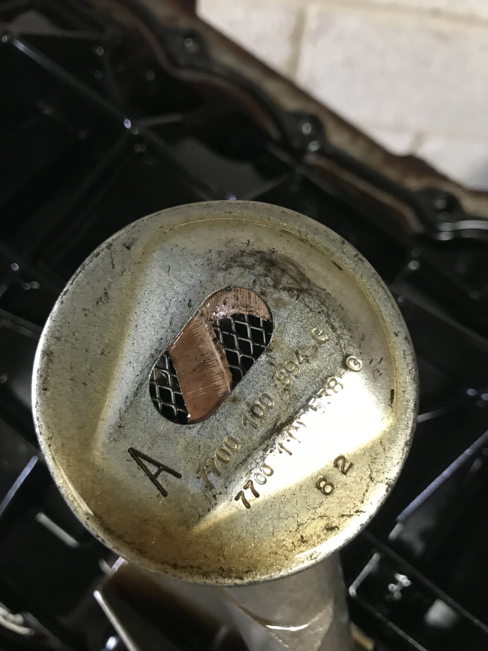

And found a nice big piece of sealant in the oil pickup which was nice.
