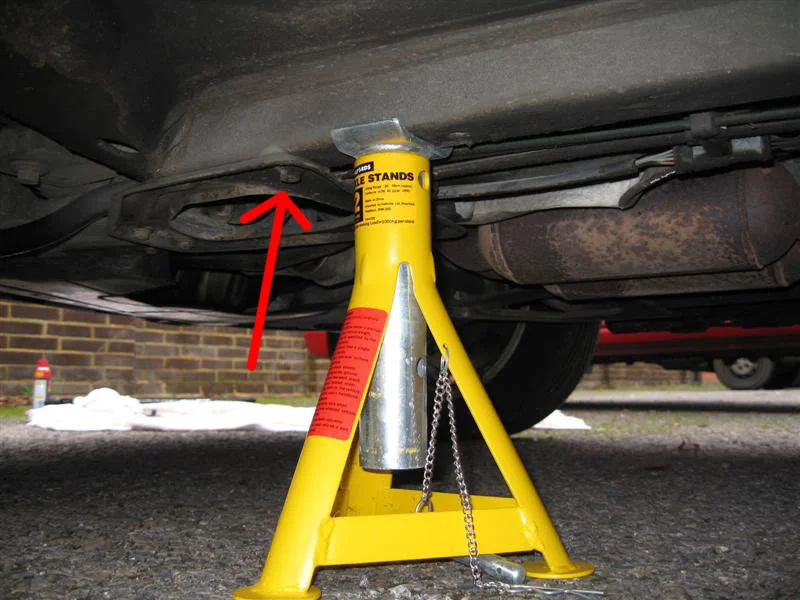

Front I go here on the support bolt -
Back- just go off the sill as its light or the rear beam.

I did try that bolt but was worried. Ended up finding the guide and have used that rail bit.
R3k1355
Absolute wetter.
Jack under the bolt and a stand under the chassis rail, I leave both in place while working underneath for security.

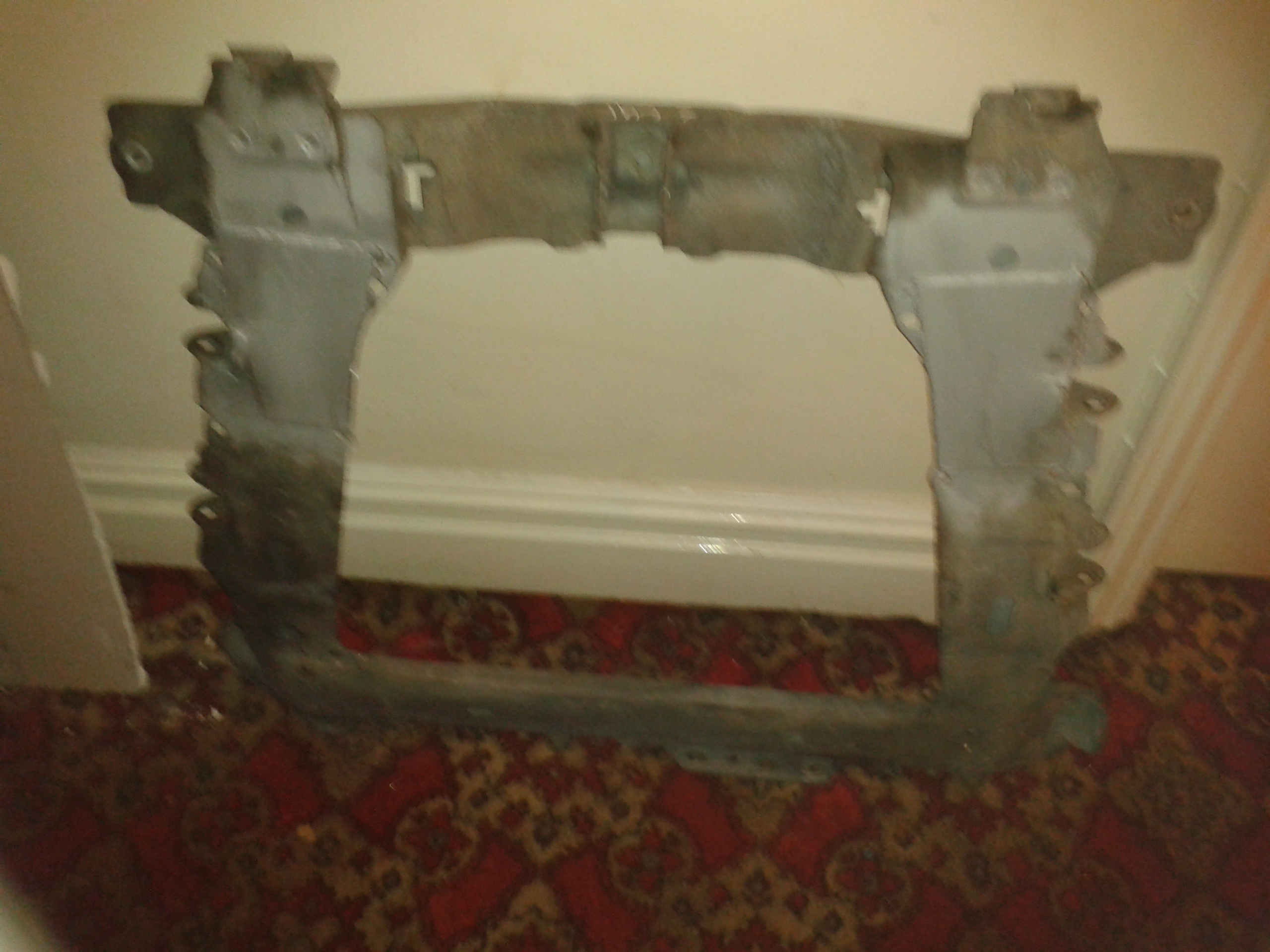

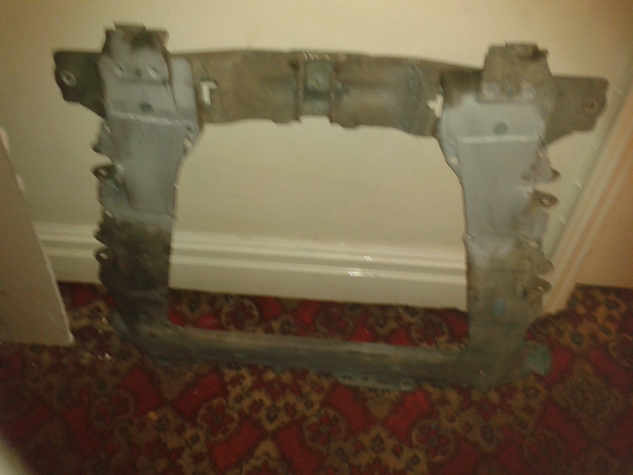

Has anyone ever centre jacked from the front with the subframe? Needing a solution to a single garage :expressionless:

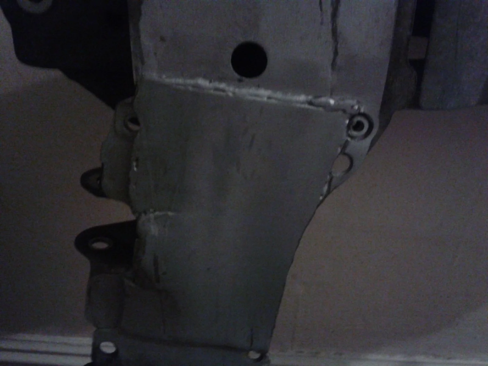

I have had a subframe reinforced with plate for this purpose.
I`ll get round to fitting it once painted it & the weather is a bit warmer, along with black polybushed cup wishbones, ARB & rack bushes.
SUBFRAME 2017-01-07 18.36.21.jpg SUBFRAME JACKING POINT 1 2017-01-07 18.35.51.jpg SUBFRAME JACKING POINT 2 2017-01-07 18.35.58.jpg

Yep, as above. Jack at the front chassis rail, axel stand on the jacking point on the cill. Move to the other side and repeat. Rear, jack on the rear beam, 1x decent axle stand in the centre of the rear beam is enough.
  330i. E30 Touring.
I was going to go with the stands at the rails shown in post 7 where the axle stand is sitting.
Can do that, but i prefer mine on the cills. Gives the car a bit more stability, especially if you're doing any work that means you need to give it a bit of welly.
That's where I put mine. Always been sturdy enough for me.

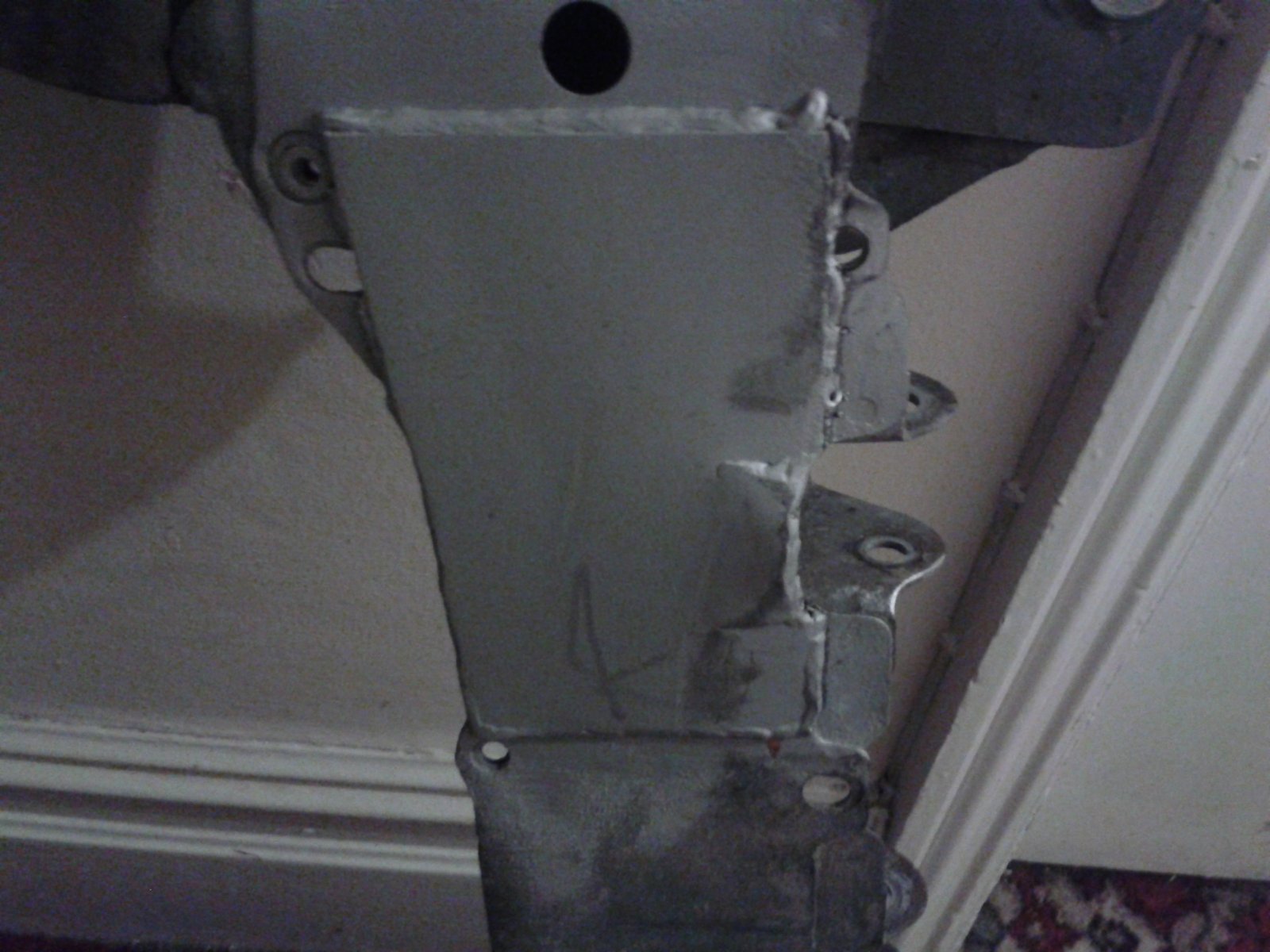

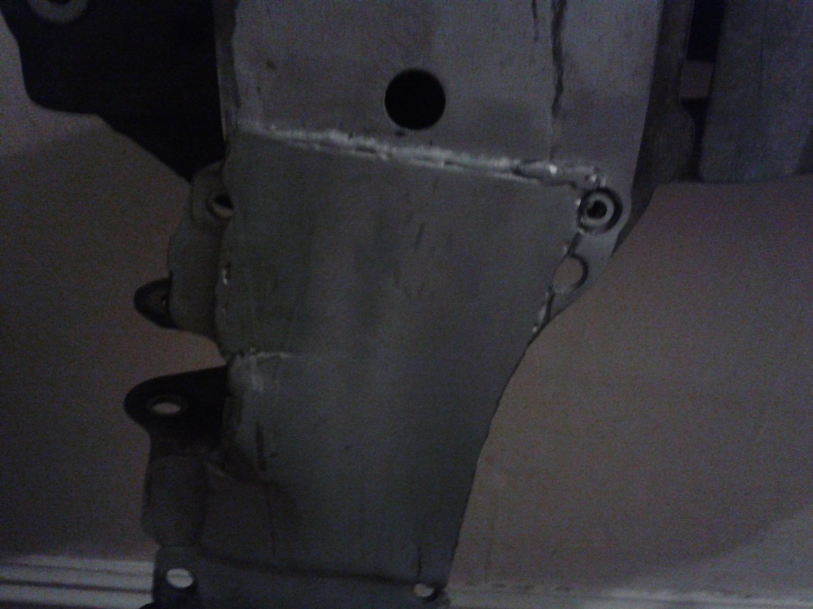

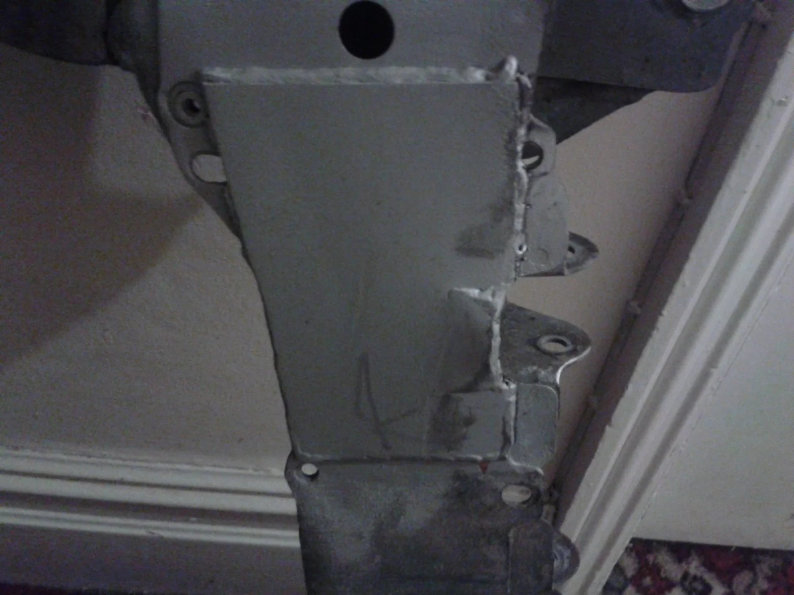

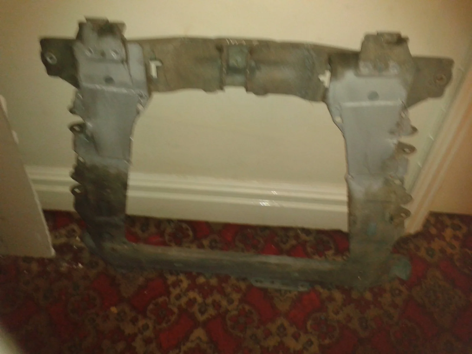

My apoligies for the poor photo.
I had plates welded to the front subframe and can get 3 wheels off the ground at the same time.
  PH2 172
Looks great- how much it cost you to get done?
About £30, + a subframe, as it was one of several little jobs I gave them at the same time..
All PH2 subframes are the same if you are looking to pick one up, before someone starts some nonsense about Cup`s being different.
