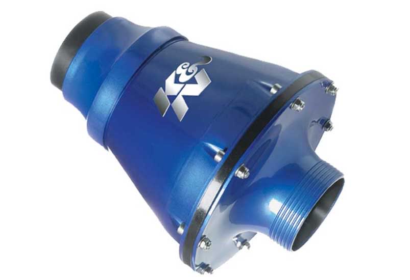

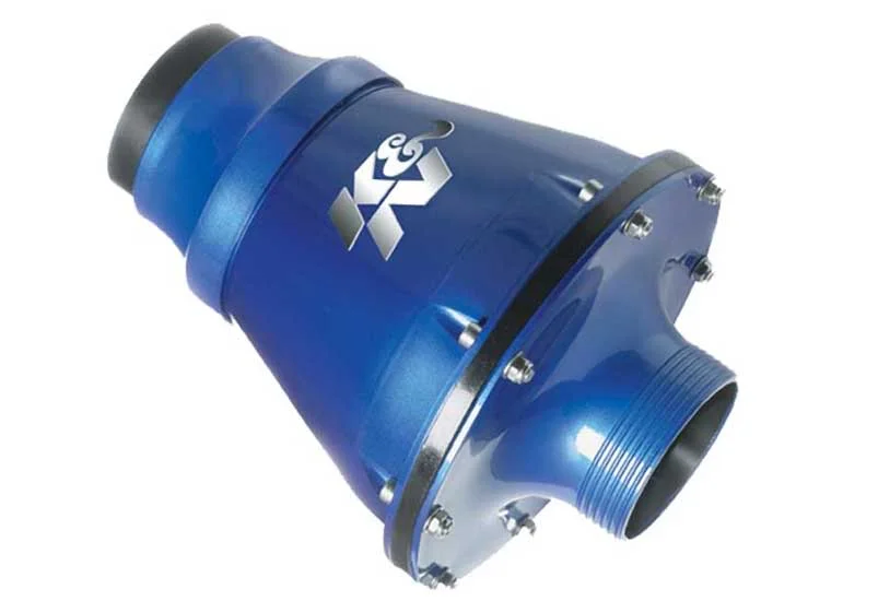

A pic for anybody who hasn't seen a k+n apollo .

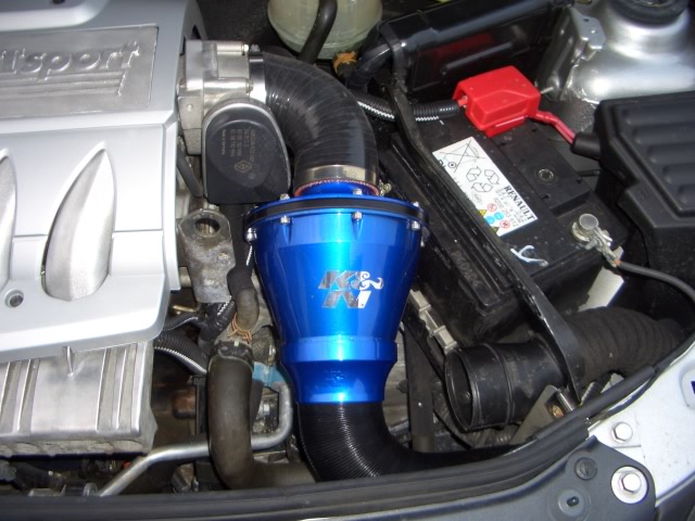

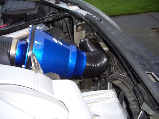

here is mine in my 182 .
the sound is awesome from these things and i very pleased seems as it was free:):)
are you sure there was nothing blocking the flow inside the apollo...
because the air feed shouldnt be a problem anyways as mine currrently has no air atall as im going to puta new 1 in and the unit gets plenty of air
