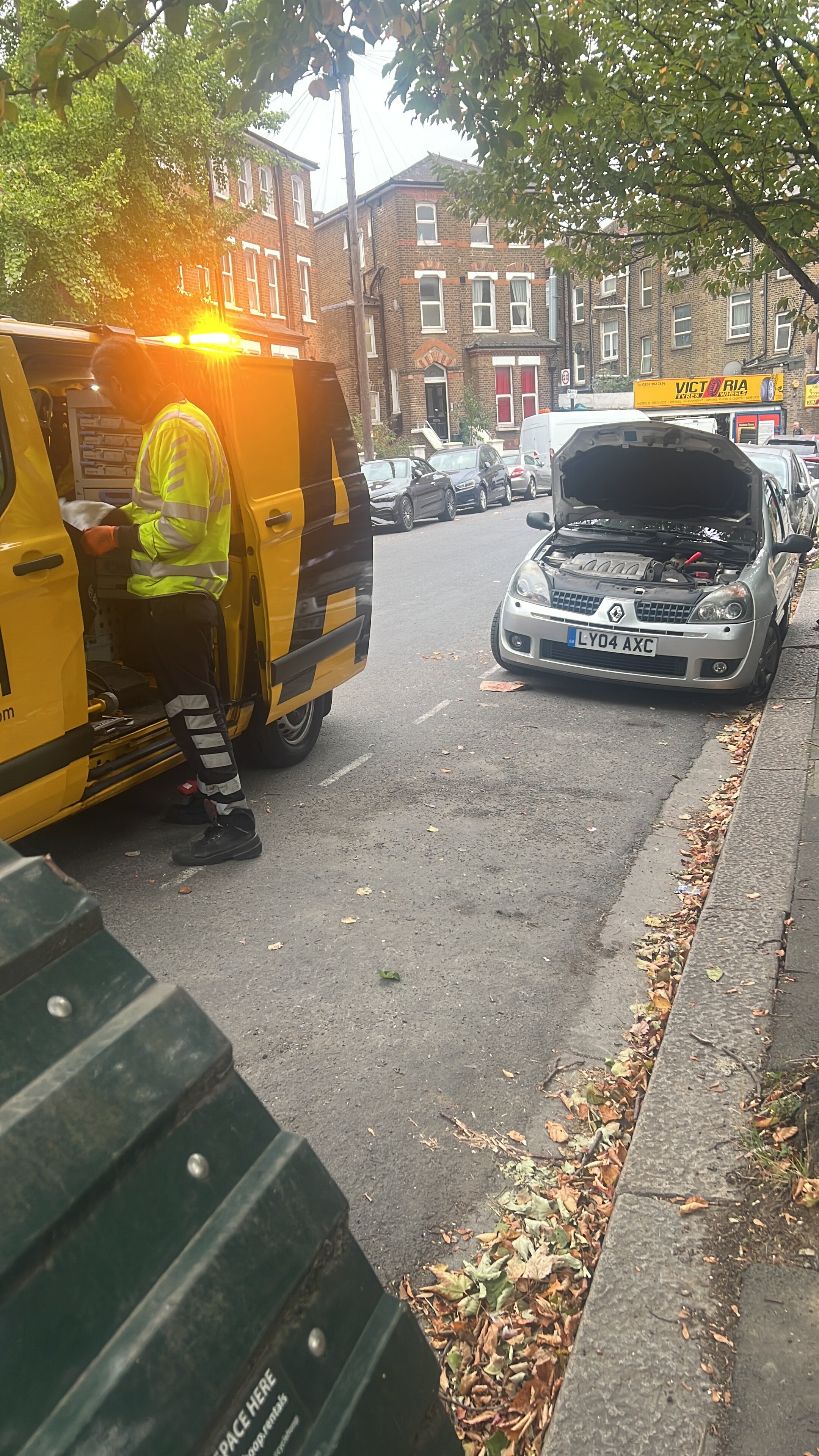

Hi all,
Had the aa out this morning for my 182 that won’t start. Turns over but won’t fire. Mechanic doesn’t think it’s fuel as no ignition after squirting into the air box. My spark plugs are new and no codes or immobiliser related things. Anyone had similar? I’m thinking power to the spark plugs but I’m not a mechanic just after an idea of how big of a bill to expect 😬

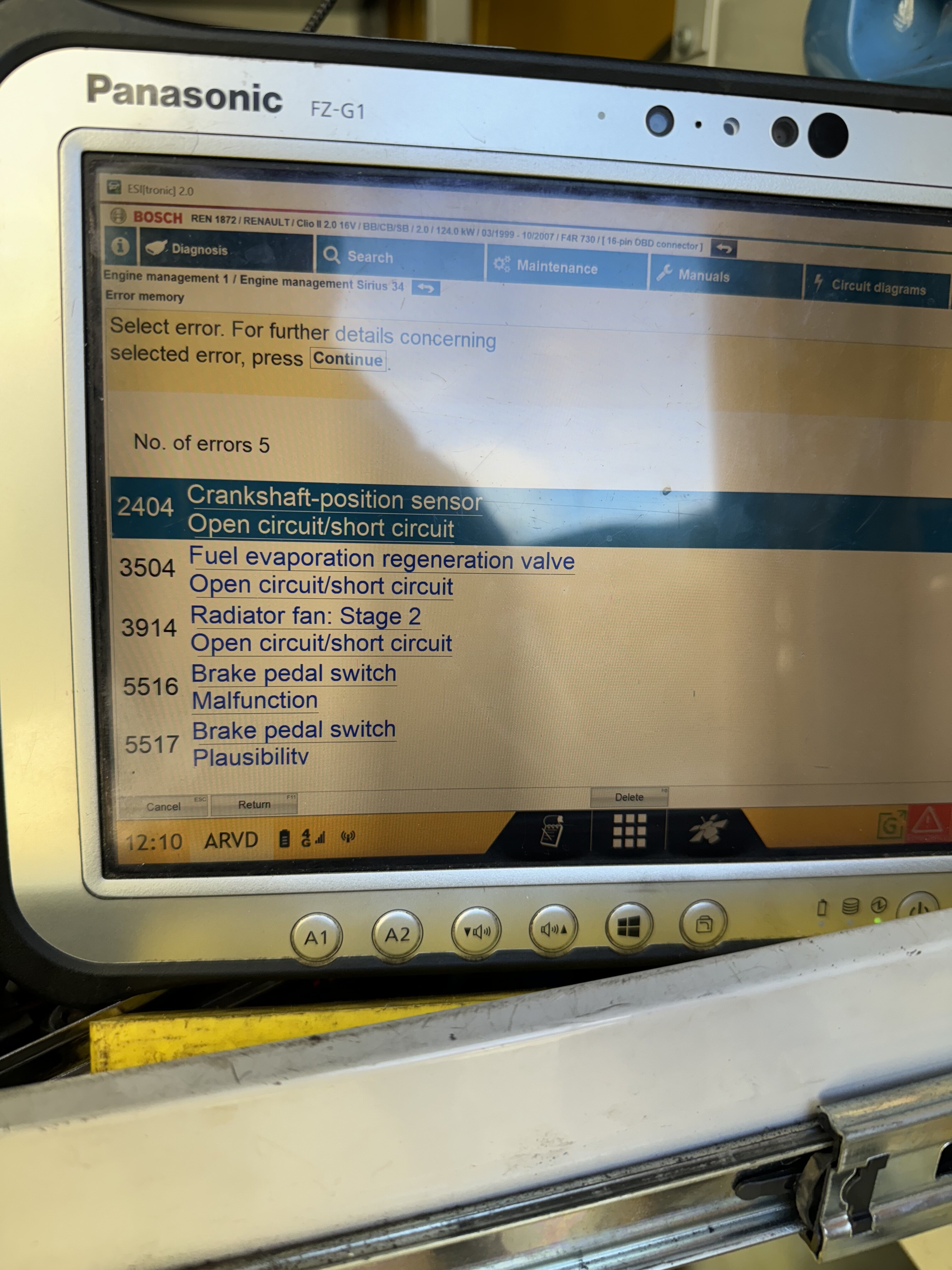

Cheers all. No the rev gauge goes to 0 when it cranks and stays there. will it wander about if it’s that sensor? Thanks for the
Replies trying to work out if a mobile mechanic can sort it or I need to pay to get it towed 😢

Also the AA guy should have plugged his obd reader in to confirm that’s the issue.

Yeah it would at least confirm the fault.
Not sure if the 182 comes with the updated CPS, but it’s really an easy fix and shouldn’t need a mechanic to sort, it’s literally a 20 min job of taking the airbox out, removing the two 13mm bolts from cps which is situated above the gearbox under a water pipe, removing and unplugging the sensor and refitting the new one, putting back together is the reverse of the removal.

ha I think I probably got that wrong then as you can tell I’m not too clued up on this. Is there a chance it wouldn’t have thrown up a fault code if it failed. As he didn’t say there were any faults detected when he plugged it in.
