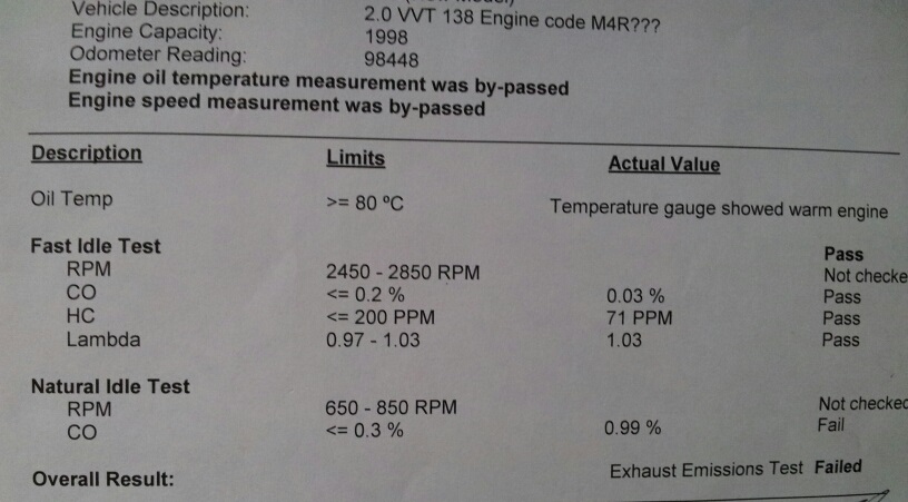

Right i just got in and had a proper read of the Fail and they have the engine down as a M4R which is the 138 thats in the scenics if i remember right, not the F4R in clios, so am i right that the emission tolerances are different??? Pretty annoyed since i trusted this garage and they cant even get the right engine for my car.
Dunno if this helps or if its even correct tolerances.
Can someone tell me if the Limits for each category are correct for a 182 in the pic above, spoke to the garage today and they said the engine doesnt matter and its to do with the year for the emissions limit, yet the other car in our house is a 54 plate also and the limits are higher and its only a 1.8 mg zs.
Basically want to know if their talking utter s**t? I dont want to be spending money i dont need to if they have got it wrong.

They are normally the same for most cars after 2001-2002 that it ! Mg should be the same really mate ! Have you asked them to try the exhaust after a good beating ?

looks like they have only done a BET test even with the figures you got you still wouldnt pass a full test on idle needs to be below 0.50% for co.

get them to check the emissions on a non mot program so you can see what the hc and lambda are doing on idle if they wont then
take it for a drive and get them to do a full cat test on it see if it will go through as i gives more time to take a reading.
some cars take a while for the readings to settle from fast idle test to idle test.
if the cat was on its way out it woudnt of past the bet test they would of had to do a full test 3-5mins of warm up then a fast idle test if it fails then a 2nd fast idle test. yours past the fast idle test fine and is a very low reading same with the hc and lambda spot on.

BET test is a basic emission test has a lower limit to pass and is a lot faster to do.
​if it fails the BET test then you carry out a full cat test where you input the car and get the correct values for the car normally higher each part of the full test take longer to do and also include a warm up time get two chances at fast idle test and a longer time for the car to idle for readings to be taken.

Just found my MOT certificate from when it was done in Feb, the RPM limits are different to yours at 2500 to 3000rpm for fast idle and 450 to 1500rpm on natural idle. The CO, HC and ^ Limits are the same.
Not sure if it helps but my HC reading was 13ppm compared to 71ppm on yours. I know it's well within the limit but seems a largish difference to the untrained eye.
