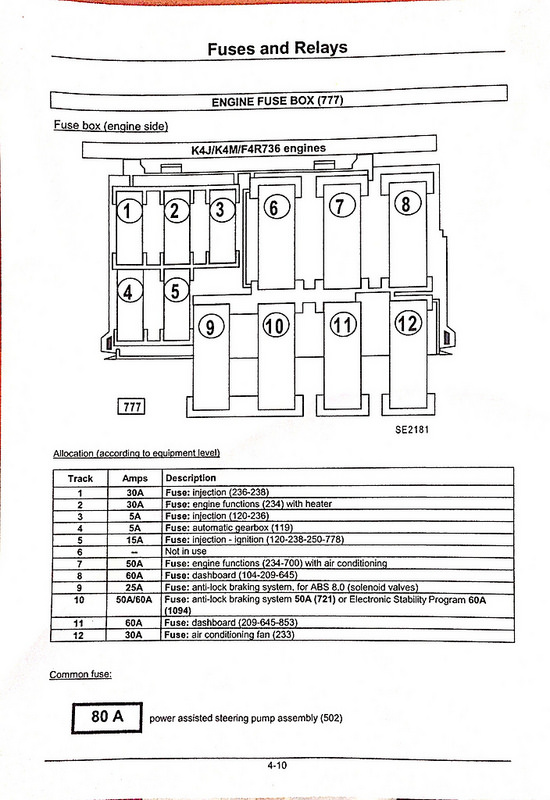

Try removing the relays in the engine bay fuse box mate (individually) and making sure the terminals are clean and refit. I’m pretty sure that there’s one that has something to do with power supply etc, but I’m fucked if I can remember which one.
Try and start the car after you’ve checked each relay as well.
As for the power supply/earth/comms - do you have a multimeter? If you do I can give you some guidance. I’d come up and do the checks for you, but my dad is currently having cancer treatment so I’ve got to be ridiculously careful about what I do, as I’m taking him for treatment.

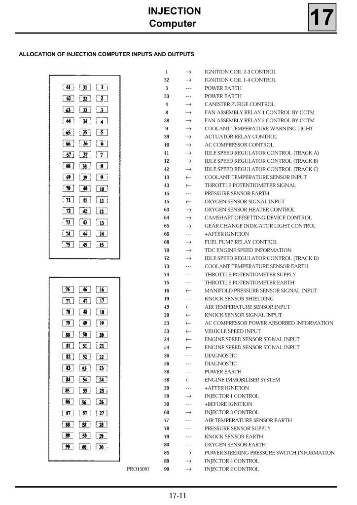

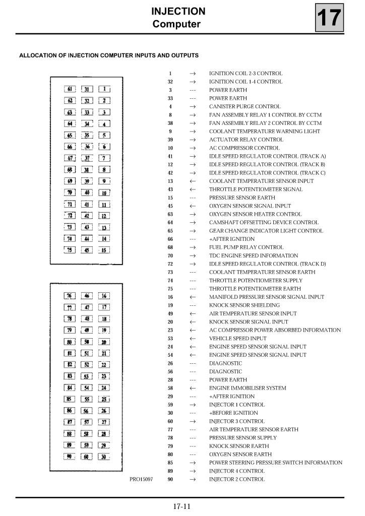

For anyone else trying to read that wiring diagram, here’s a brief description:
A lot of sensors are earthed internally within the ecu, so for example, pin 1 & pin 32 ignition coil control is earthed internally - this is indicated by the arrow going towards the writing in the description.
So guess what! All the ones with the arrow away from the writing are outputs.
The ones with - - - indicate voltage supplies/earth/comms.
This. I think it's relay J but may be wrong. Also pull out and clean the fuses as well as the white connector below.

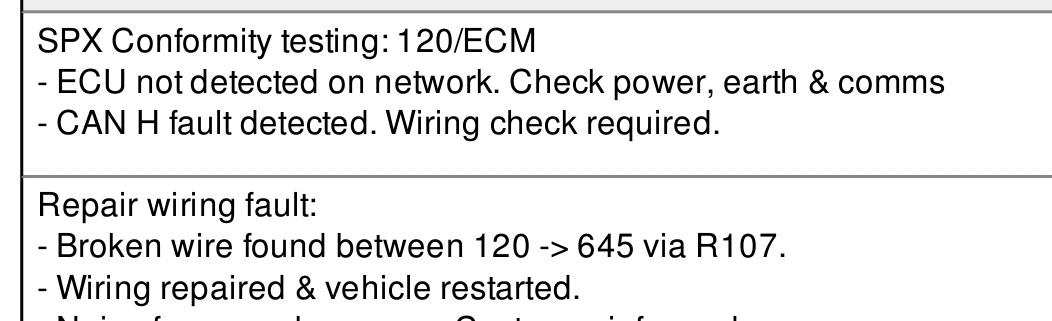

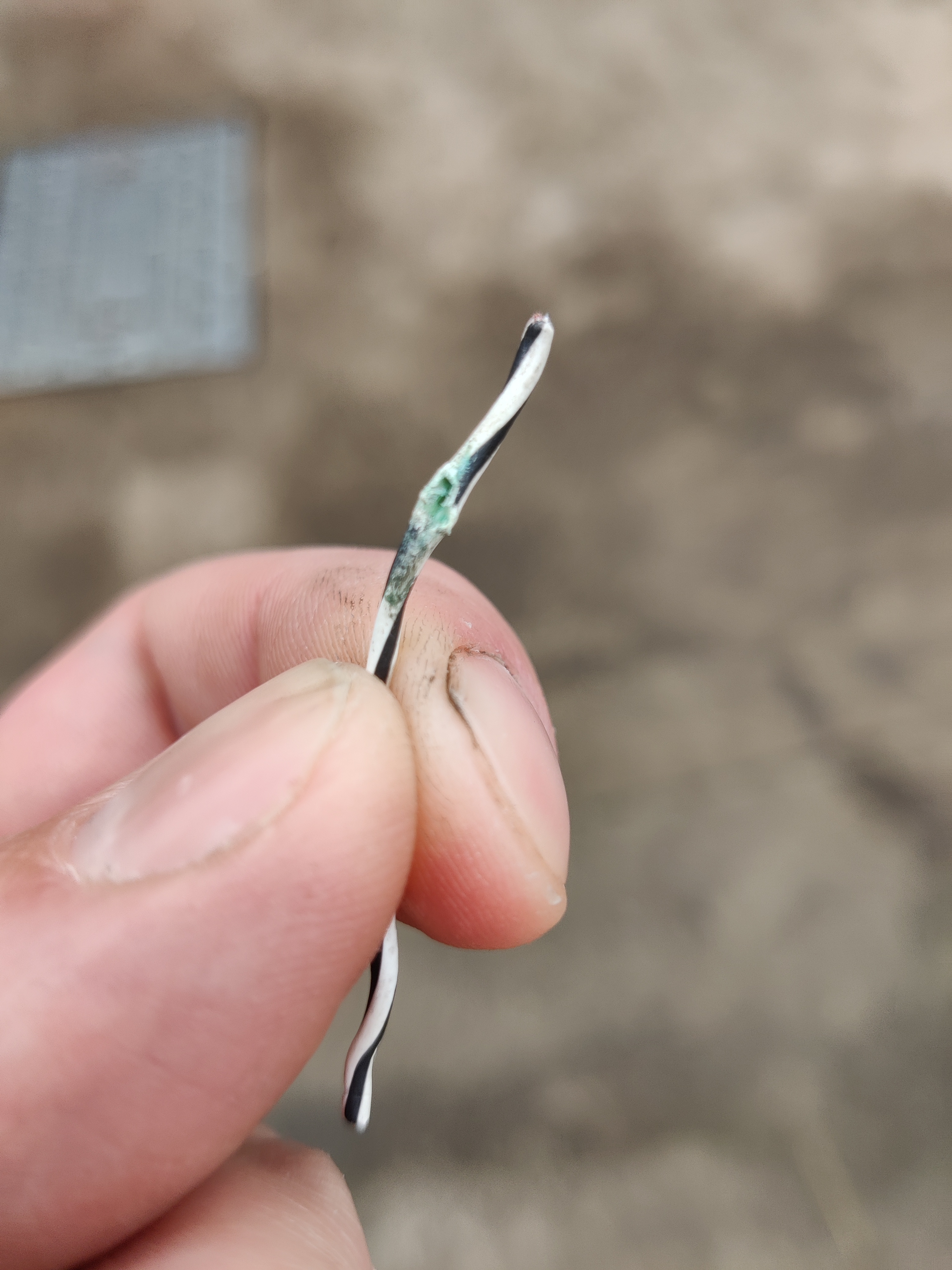

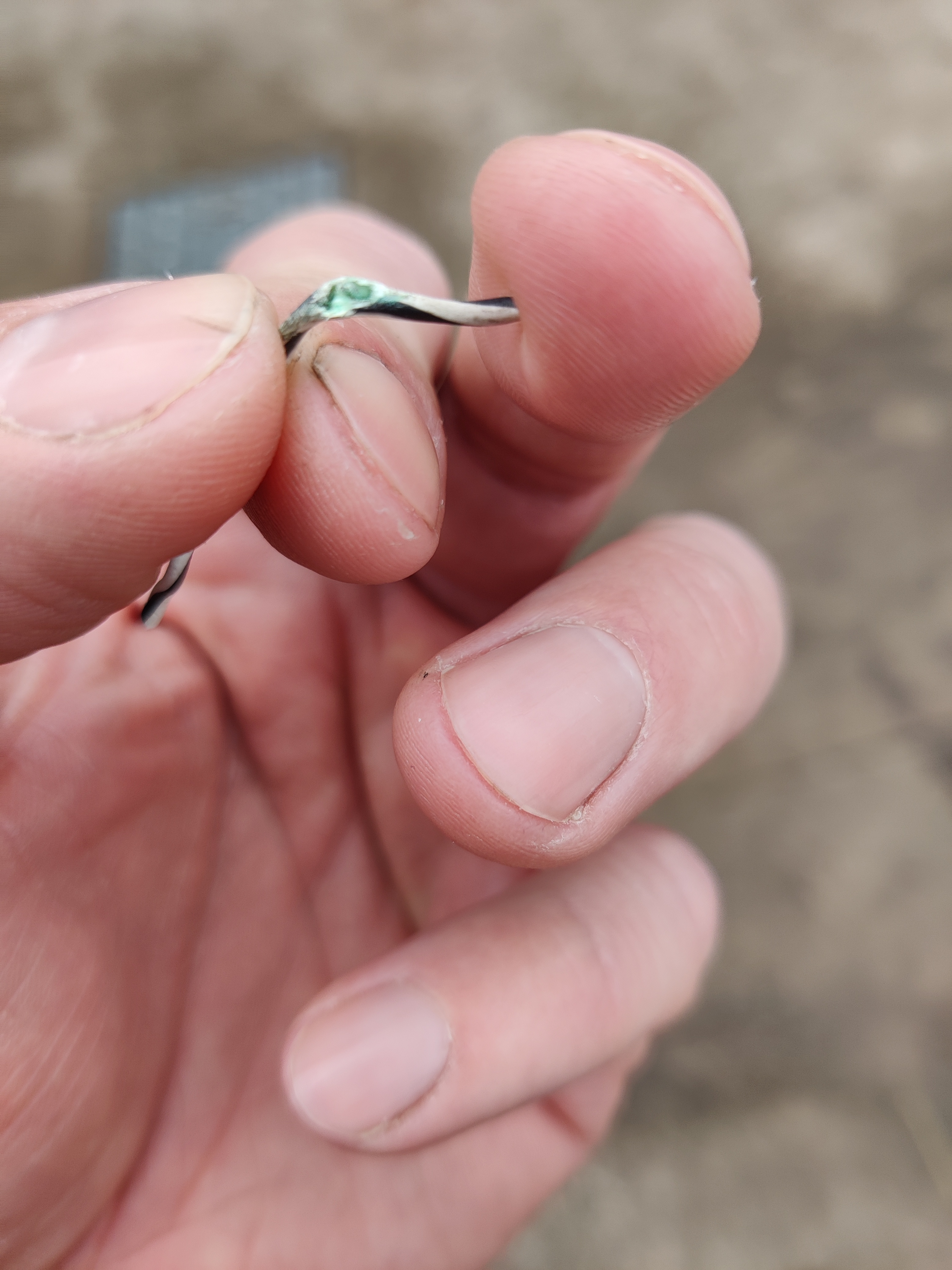

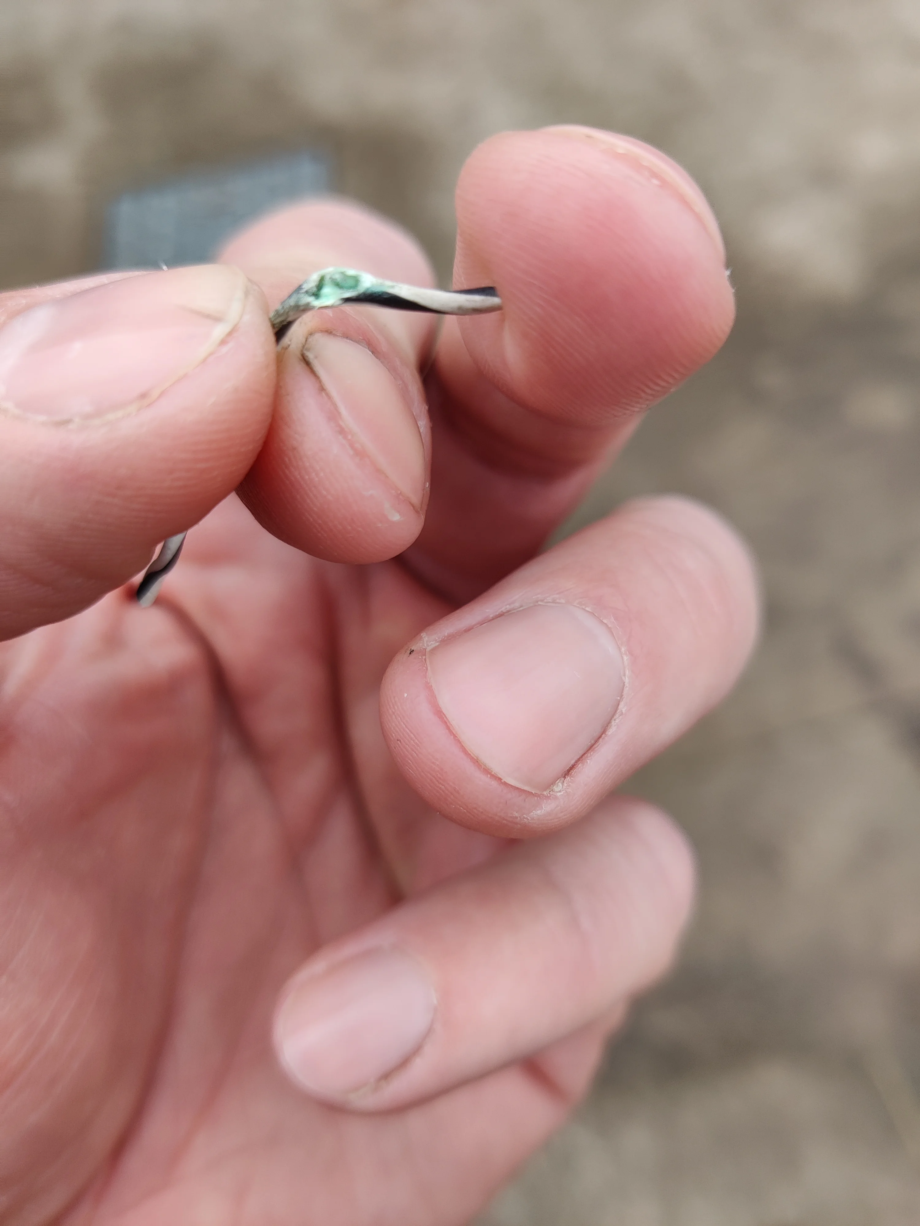

One faulty wire in the end, the sleeve of the wore had a tiny hole in it and the wire inside had deteriorated to nothing basically. It looked like green powder.
It's much bigger in the pictures because I'd been fiddling around with it.
Mick found the issue and replaced the whole cable for me.
Issues noted by Mick.
