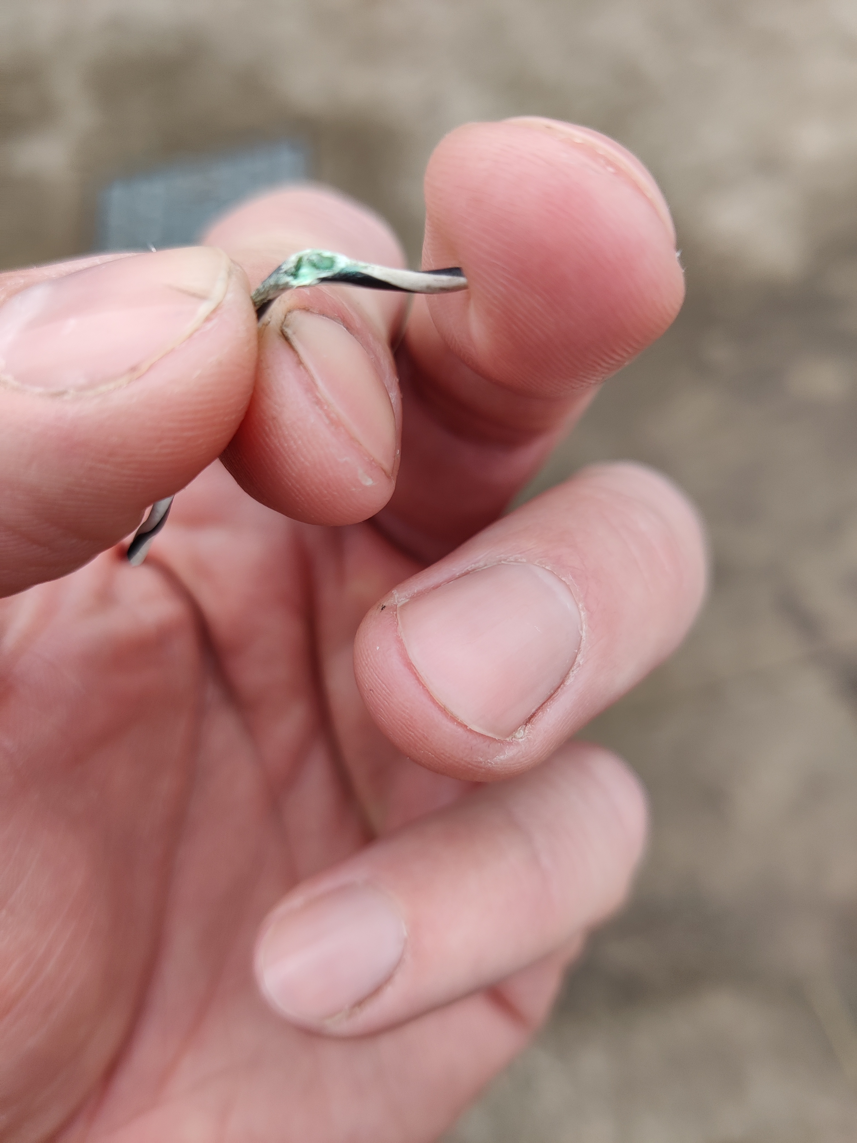

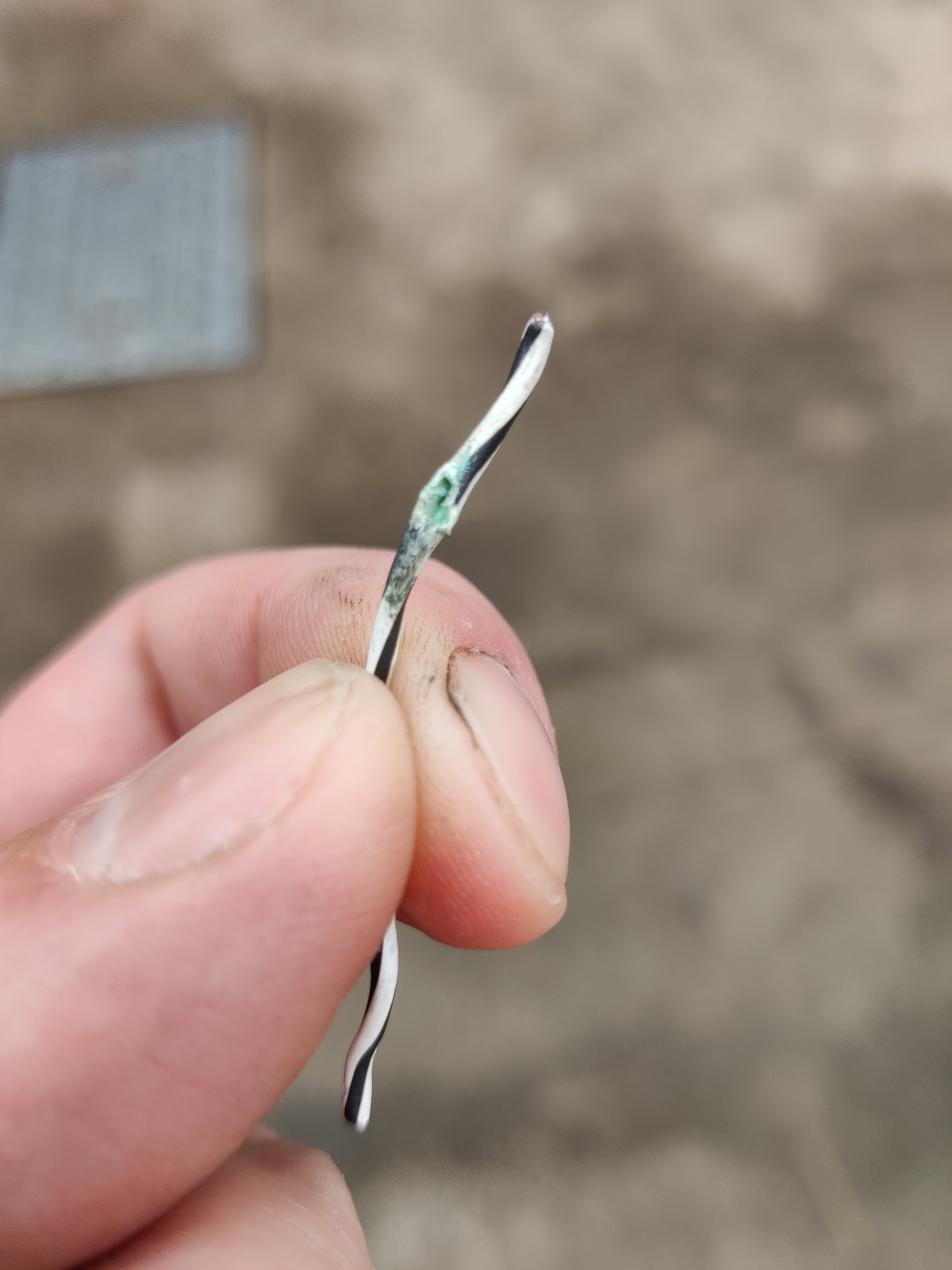

One faulty wire in the end, the sleeve of the wore had a tiny hole in it and the wire inside had deteriorated to nothing basically. It looked like green powder.
View attachment 1535342View attachment 1535343
It's much bigger in the pictures because I'd been fiddling around with it.
Mick found the issue and replaced the whole cable for me.

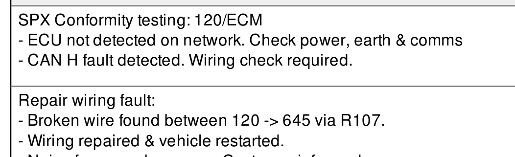

Issues noted by Mick.

Hi Darryl - can you tell us exactly where this wire is in the car and what it is connected to?
Darryl_1983
  RB 182 Cup
I believe the wire that was damaged was one of the several wires connected to the ECU behind the battery in the engine bay. You'll need to remove the tape/shielding to uncover the group of wires. I can't really give much help to be honesty, as Mick sorted the issue out for me.

hi, hope you see this! i have same problem and was told it could be the black and white twisted wires for the immobiliser in the loom from engine bay fusebox to ecu which go under battery.
Do you know if was one of these?

Sorry, but I've posted everything I had at the time in the post above. See post #40.
Hopefully that info helps.
I've no longer got the car, so don't have the paperwork either to double check to see if there was more information
