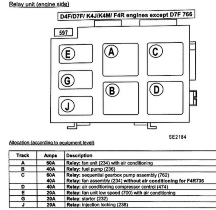

In the engine bay fuse box, you'll see 3 brown relays. The middle one is the starter, swap that with the top one which is the fan and see if it does anything.
That noise at the end just sounds like the throttle body shutting off.
If it’s not the relay could it be the exciter wire?
I reckon this.
If you have skinny wrist you can get your hand down between the exhaust manifold pipes and feel around for the single wire with a spade connector.
I think its the middle 2 pipes of the 4
E and G
I’ve just been out and swapped the relays - no change.

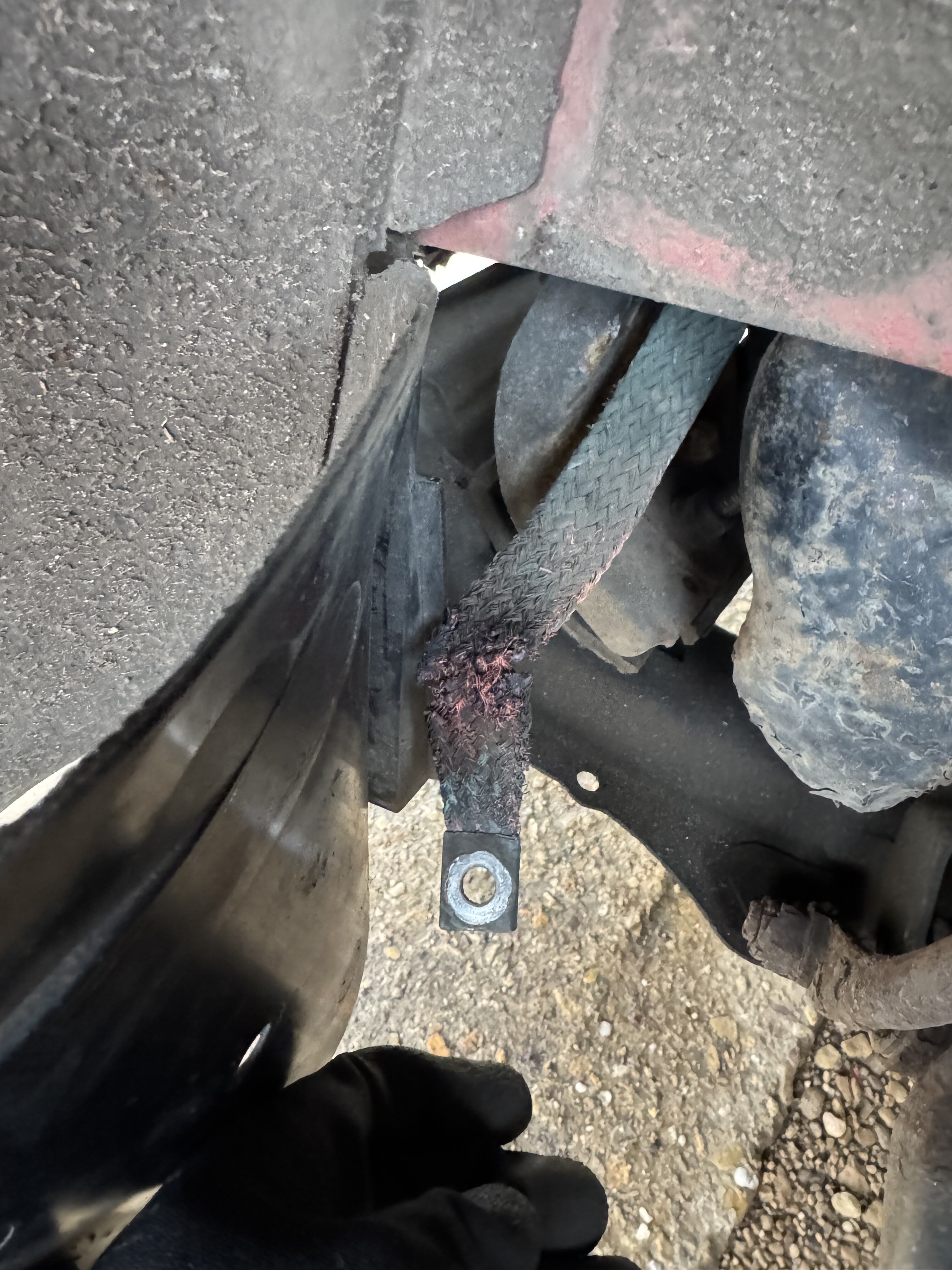

So after the new starter motor was fitted it done the same thing. Obviously, much swearing followed this.
I had to go buy some new jump leads as mine seem to have disappeared, once I had the battery earth connected to the engine it fired up first time. This caused massive relief, followed by more swearing at not having done this first 😅
Anyway, I whipped the passenger wheel off and this is what I found..
New Earth strap is now on order 🤦🏻‍♂️
