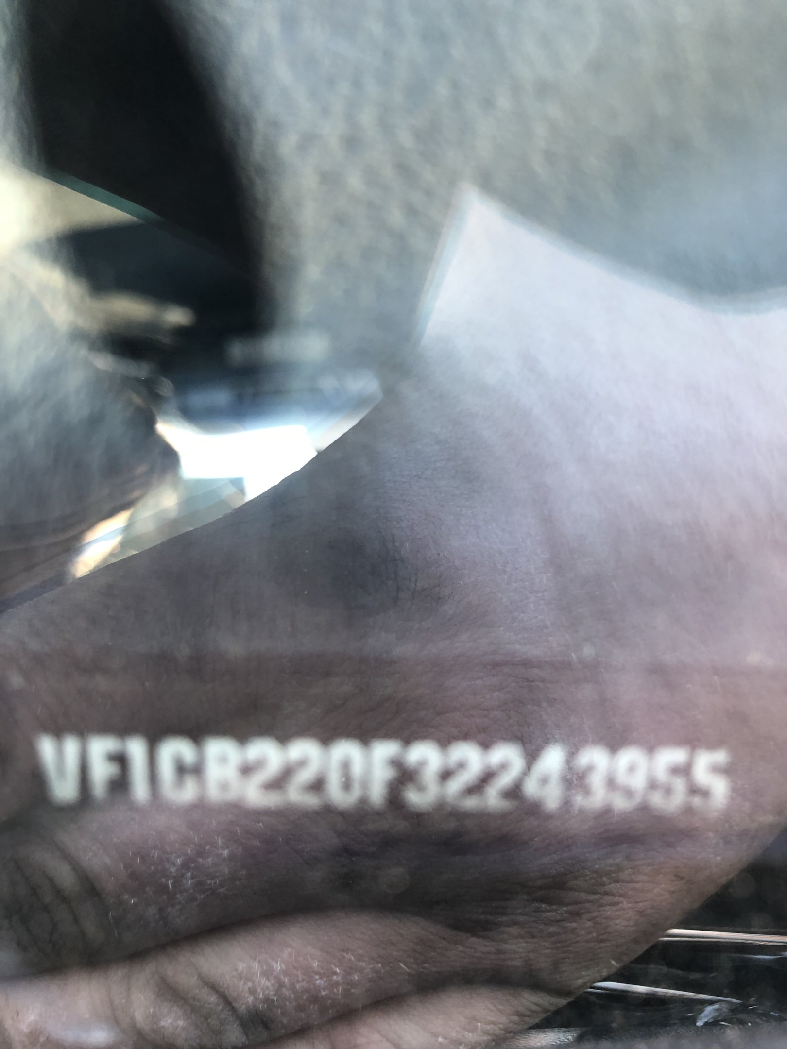

Hi need new suspension for the car not sure if it’s a 182 or a 182 cup I have measured the bolts at 60mm not 54mm
My vin I will attach in a picture is anyone able to tell me if this is a cup or not?

If you've got 60mm bolt spacing on the front strut it's got the Cup suspension (or at least the shocks and hubs)
So you need to replace it with 182 Cup suspension items
IIRC Cup springs are no longer available?
