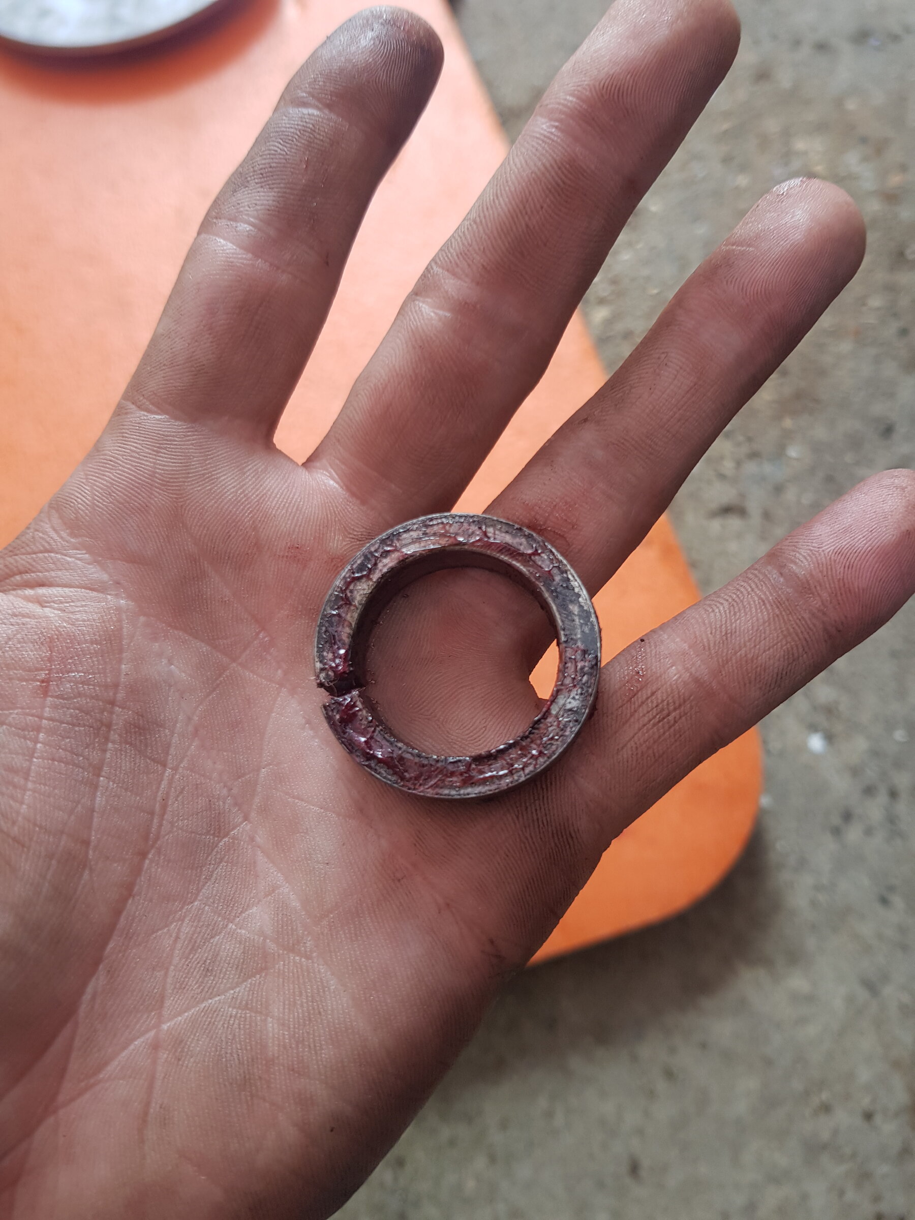

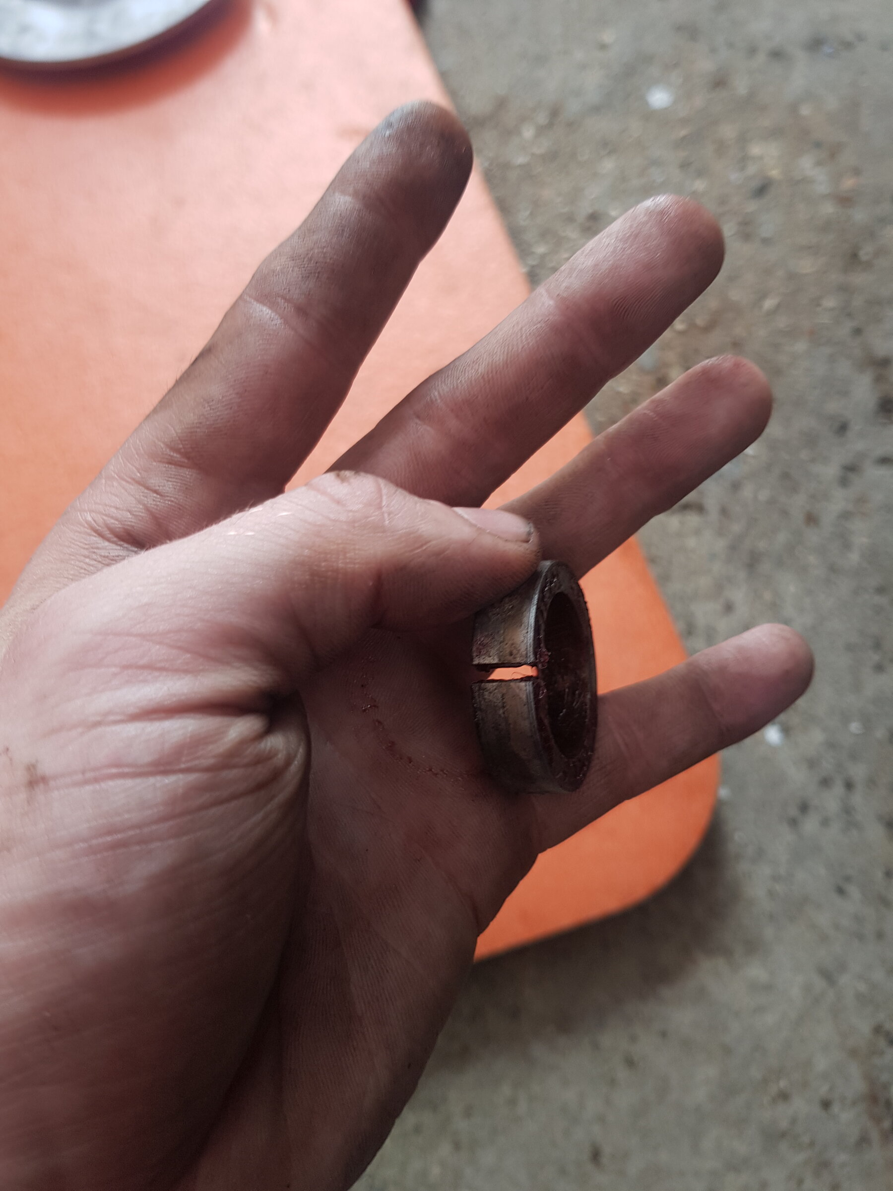

The issue seems to be a split washer/spacer thing that is sat on the stun axle. If I don't put that in, everything seats fine. With it in, I'm too far out.
What is this piece? Should it have the split in it? And why don't my discs seat properly?

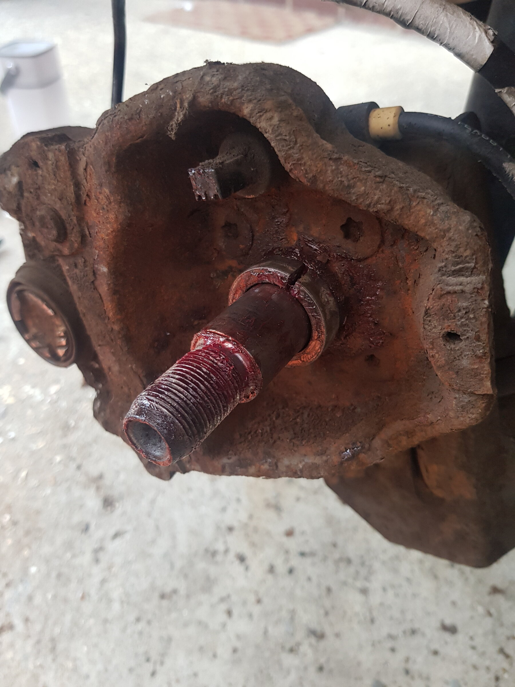

Just to confirm, without the spacer my hub looks like the attached. That all good? Looks to be a machined flat surface at the base of the stub axle.

Bit hard to see with the grease but I think it should be slightly rounded at the base.
The shims should only fit one way, won't fit the other way, self explanatory really.

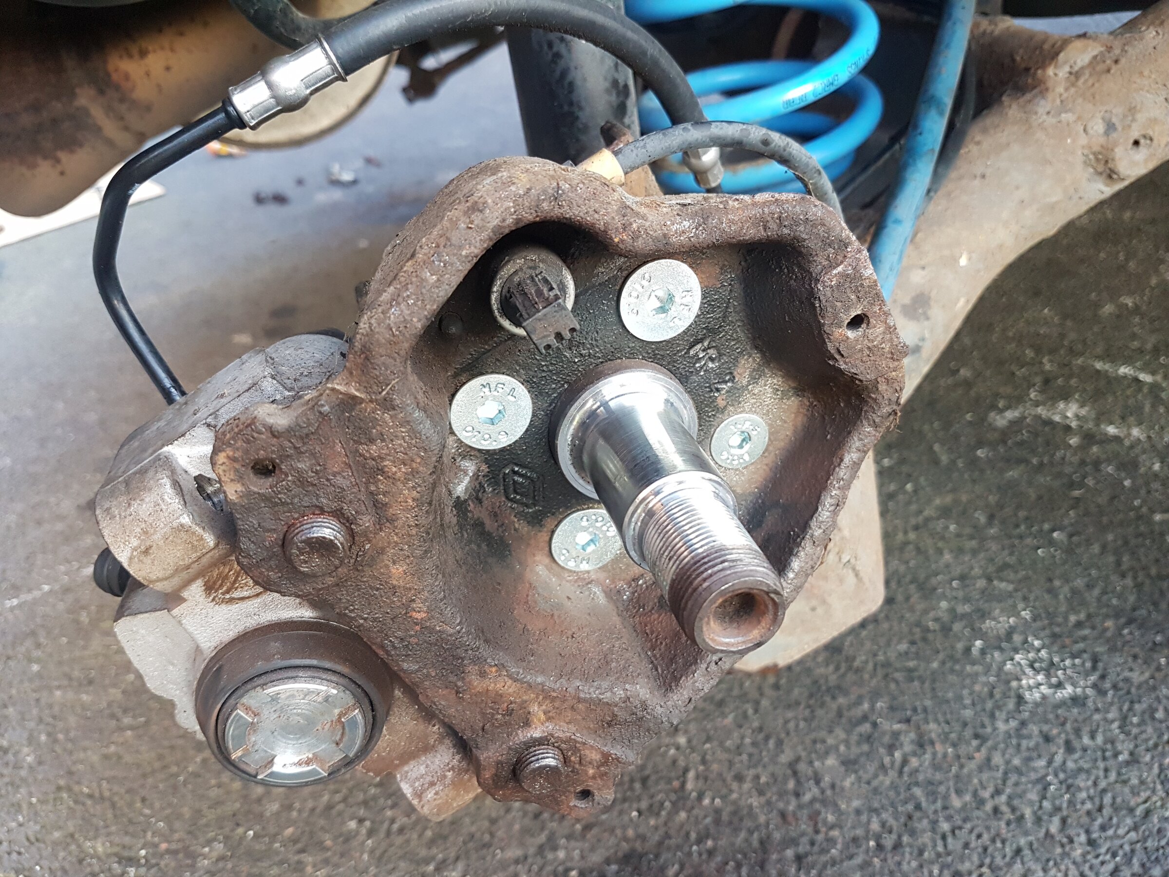

This is what mine look like, can kind of see how it's slightly rounded at the base.
