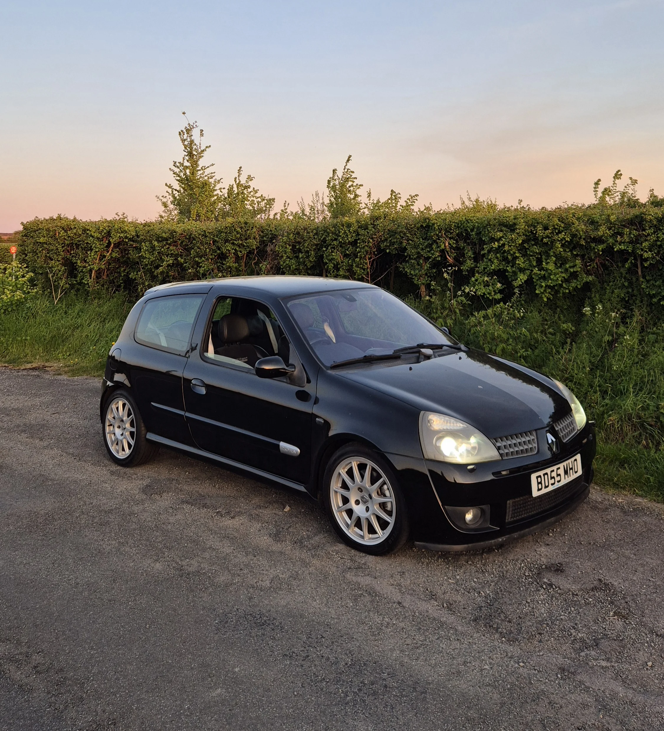

And on my drive with the missus looking happy because it has two exhausts.
Black Gold, both Cup Packs, 122k Miles, no history and a crunch in to 3rd gear. Serv, ABS and Engine light on.

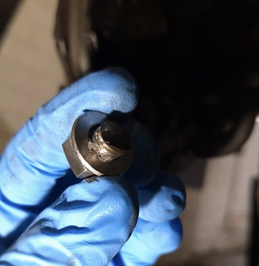

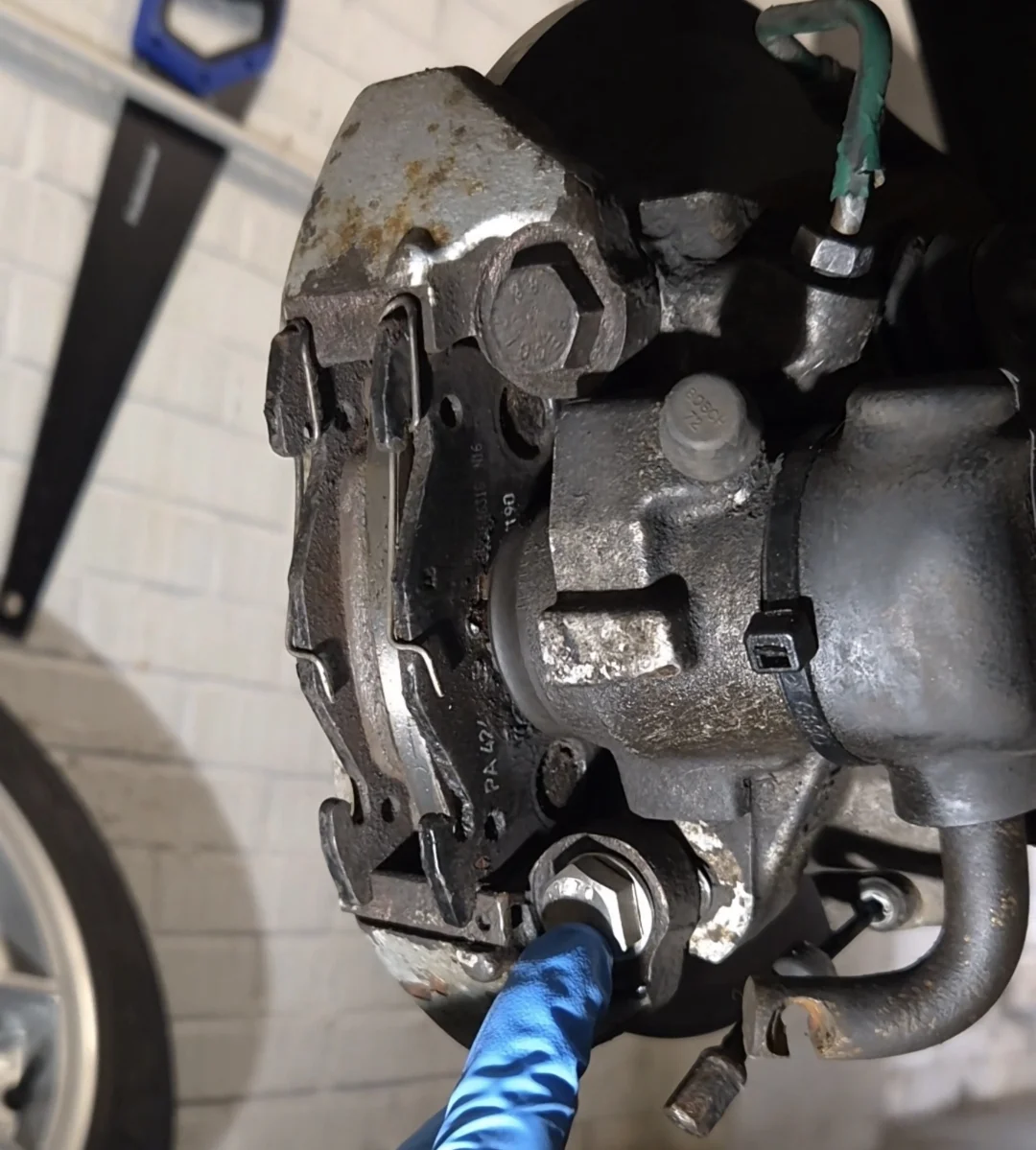

So when I stuck my head under the car on inspection purchase I noticed the rear passenger caliper had one very shiney bolt but thought nothing of it. When I got it home I jacked it up and decided to have a poke around. Gave it a scan with RS Tuner = Rear ABS sensor. Fine.
Cool. I'll do rear discs and pads with an ABS sensor.
Remember that rear caliper with the shiney bolt? Yeah, it was GLUED on. The head of the bolt was GLUED on.
WTAF. Anyway, moving on. It gets worse before it gets better.

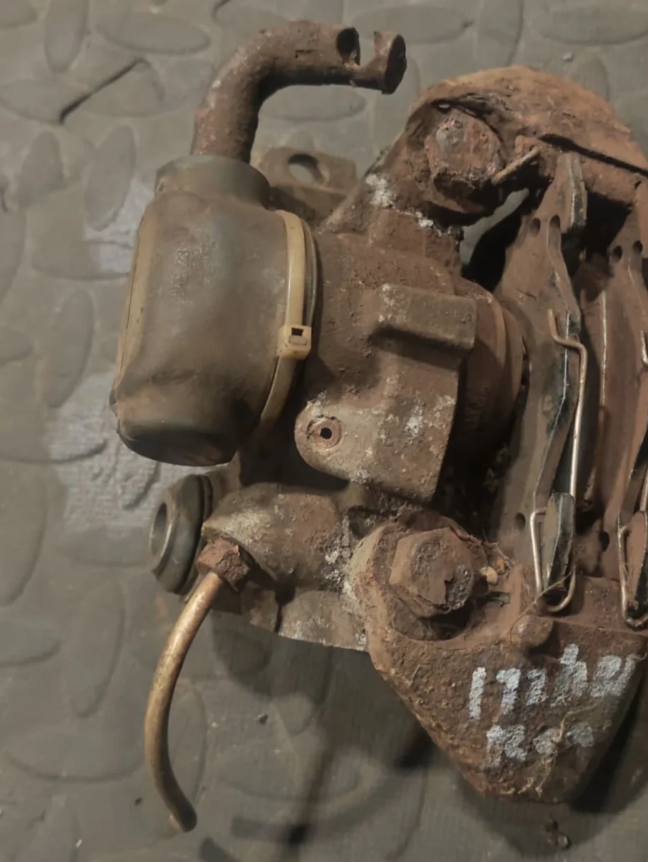

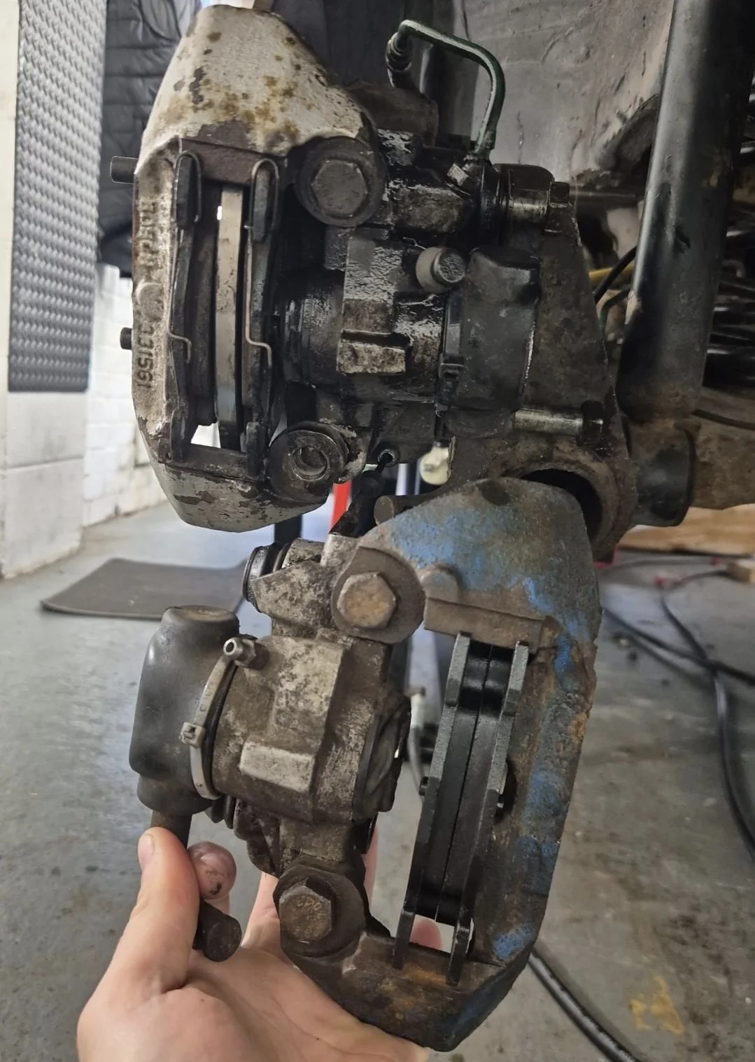

I spoke to one of those FB Clio breakers and asked for a rear passenger caliper. And I got this.
Mistakes happen. Fine. I was asked to post it back and the correct one would be sent out to me. Posted back, at my cost (no offer of a refund to cover their mistake) and then I recieved this.
Yes. That's a snapped bleed nipple.

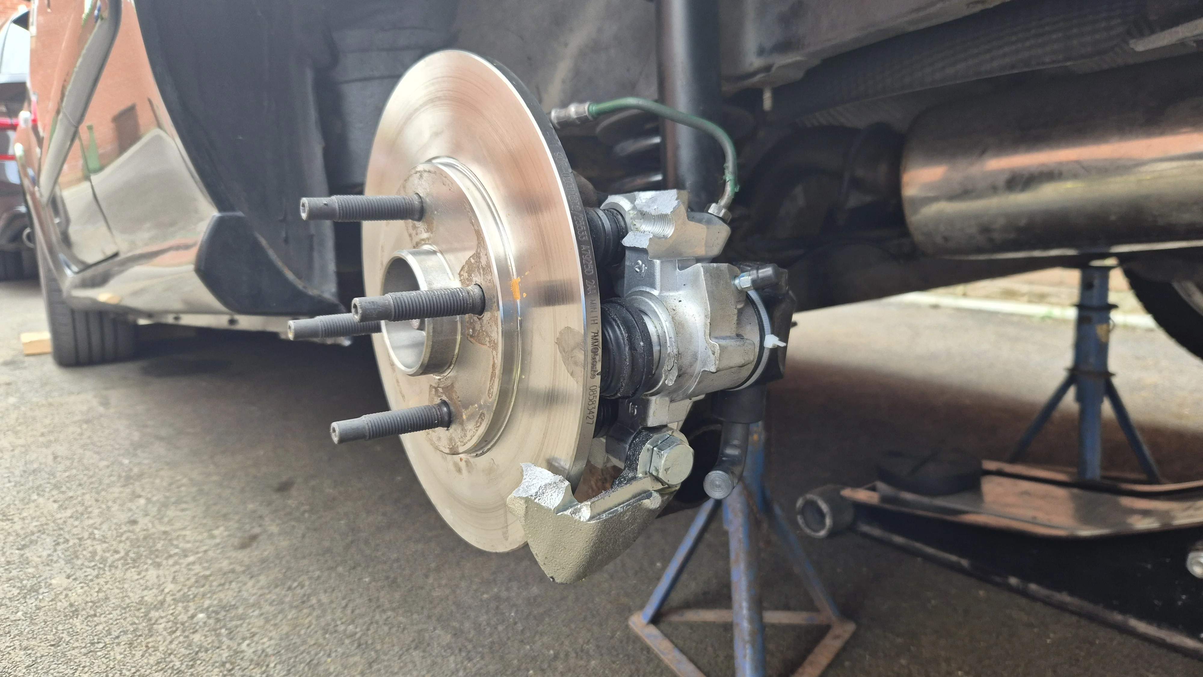

At this point I gave up and ordered a reproduction caliper from Ebay. Bigistake.

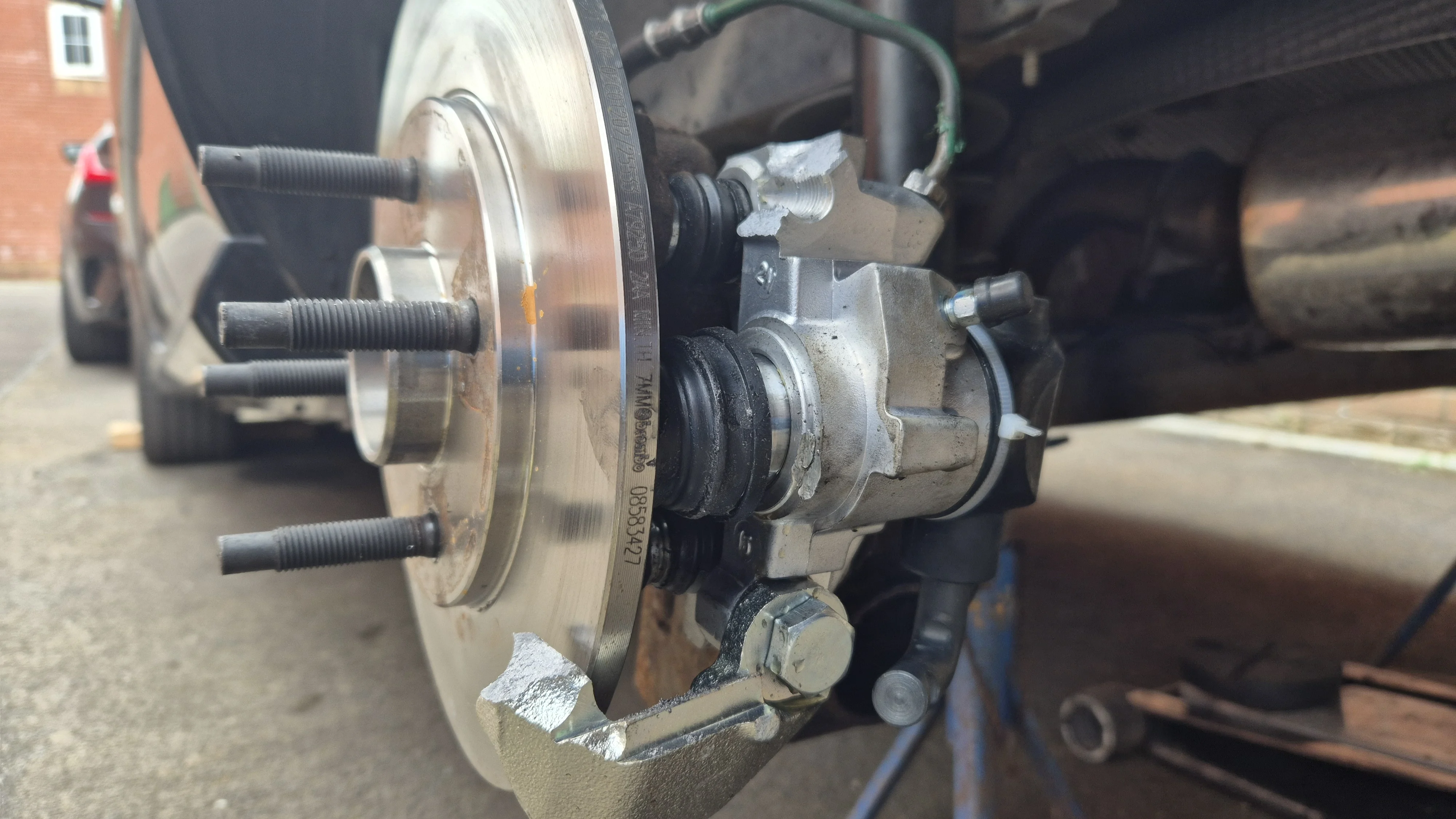

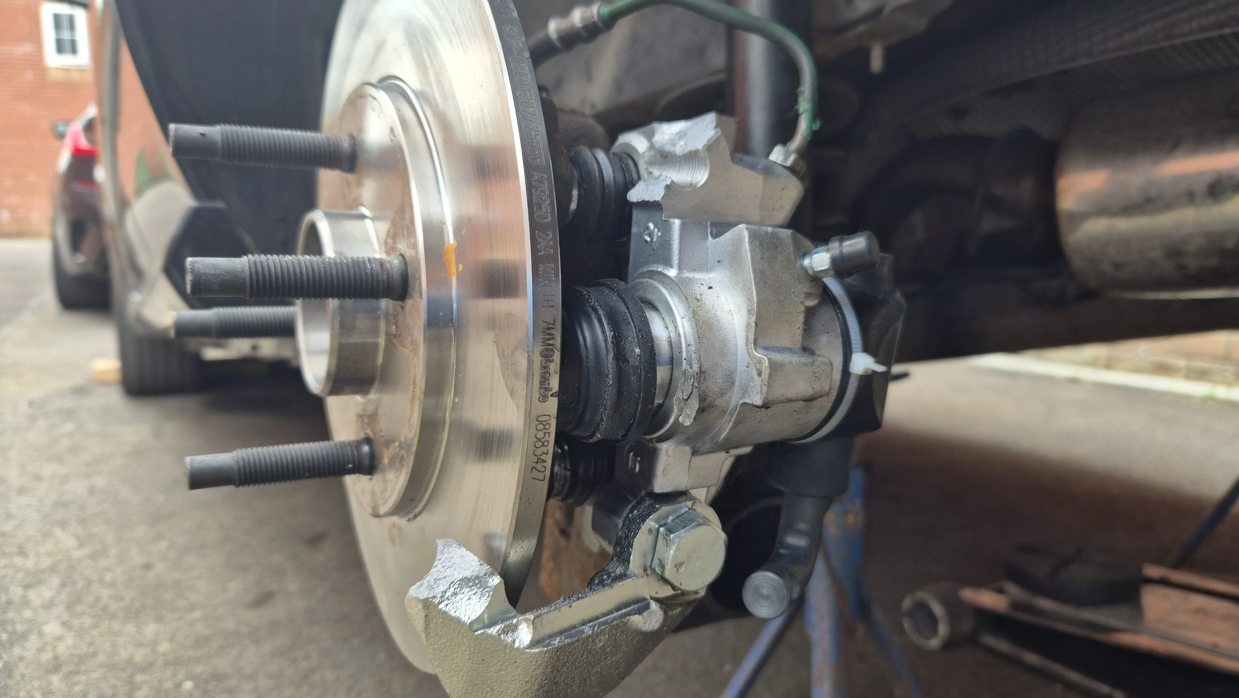

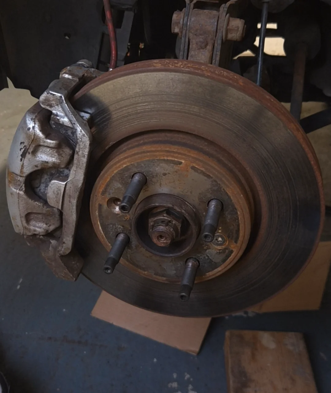

I fitted this caliper (I've fitted many a rear caliper), new rear disc, new pads and retaining clips etc and I went for a drive. I got no more than 2 miles from my house, bedding the new discs and pads...when I hear an almighty bang. I thought it was a blow out and then I thought a piston had ejected from the block. Alright, I'll come to a stop. I said I'll come to a stop..... NO BRAKES.
Managed to get home engine braking.
Took a look at the caliper and.....
FFS. No idea. It also snapped the brand f**king new disc and damaged the wheel cosmetically.
I was pissed off and I left it on axle stands on my drive much to my neighbours delight for a month.
Eventually I sourced a genuine second hand caliper without a snapped bleed nipple. Fitted it, bled the brakes and that was that drama over.

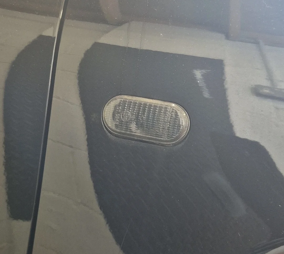

Binned the black side repeaters

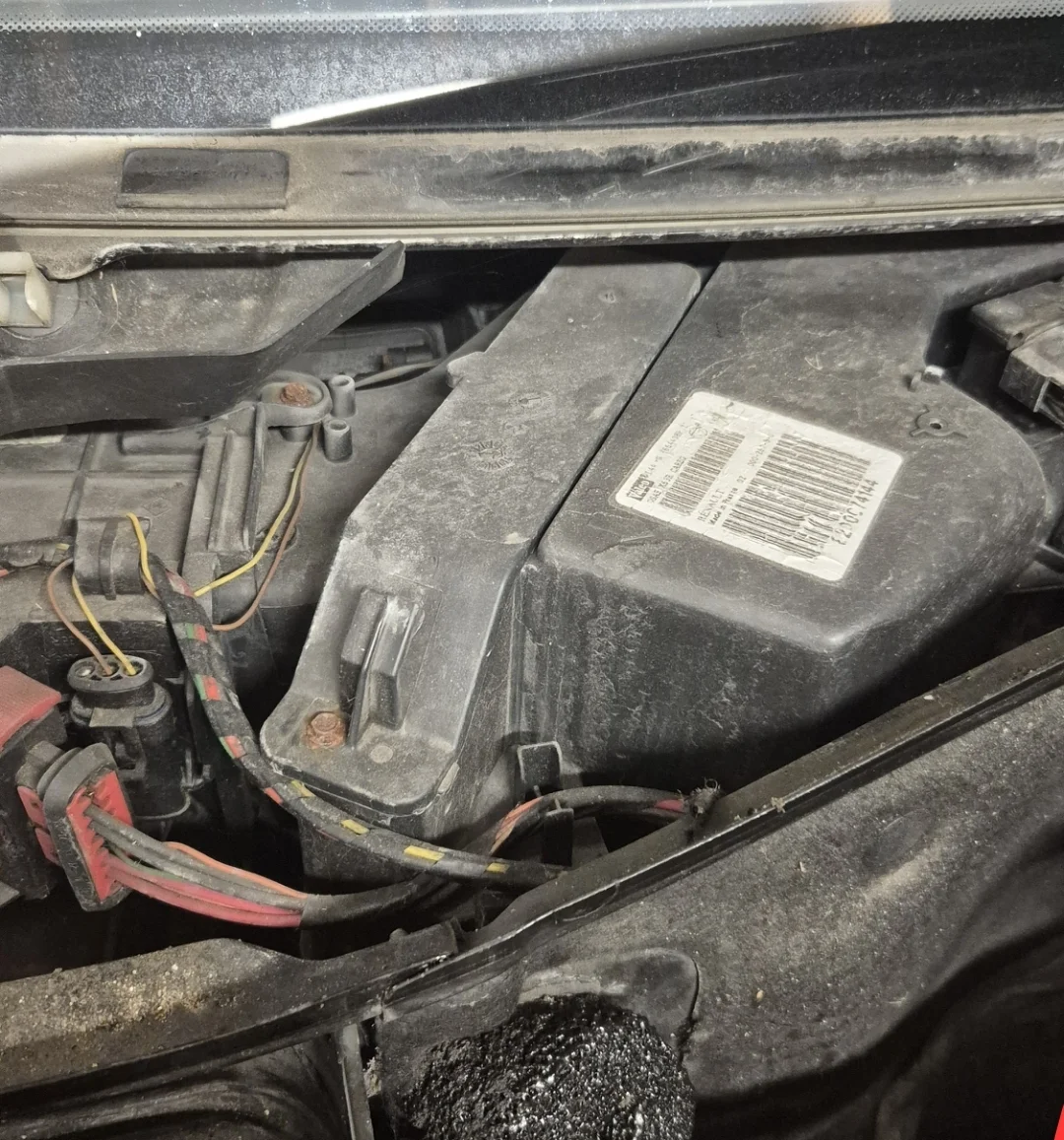

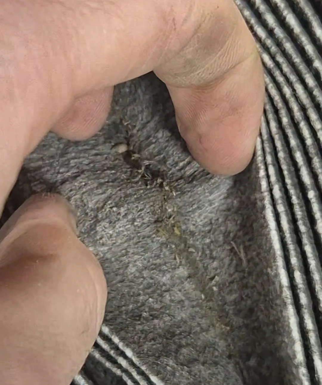

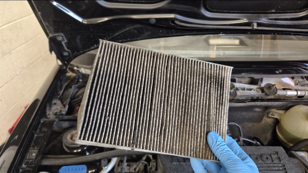

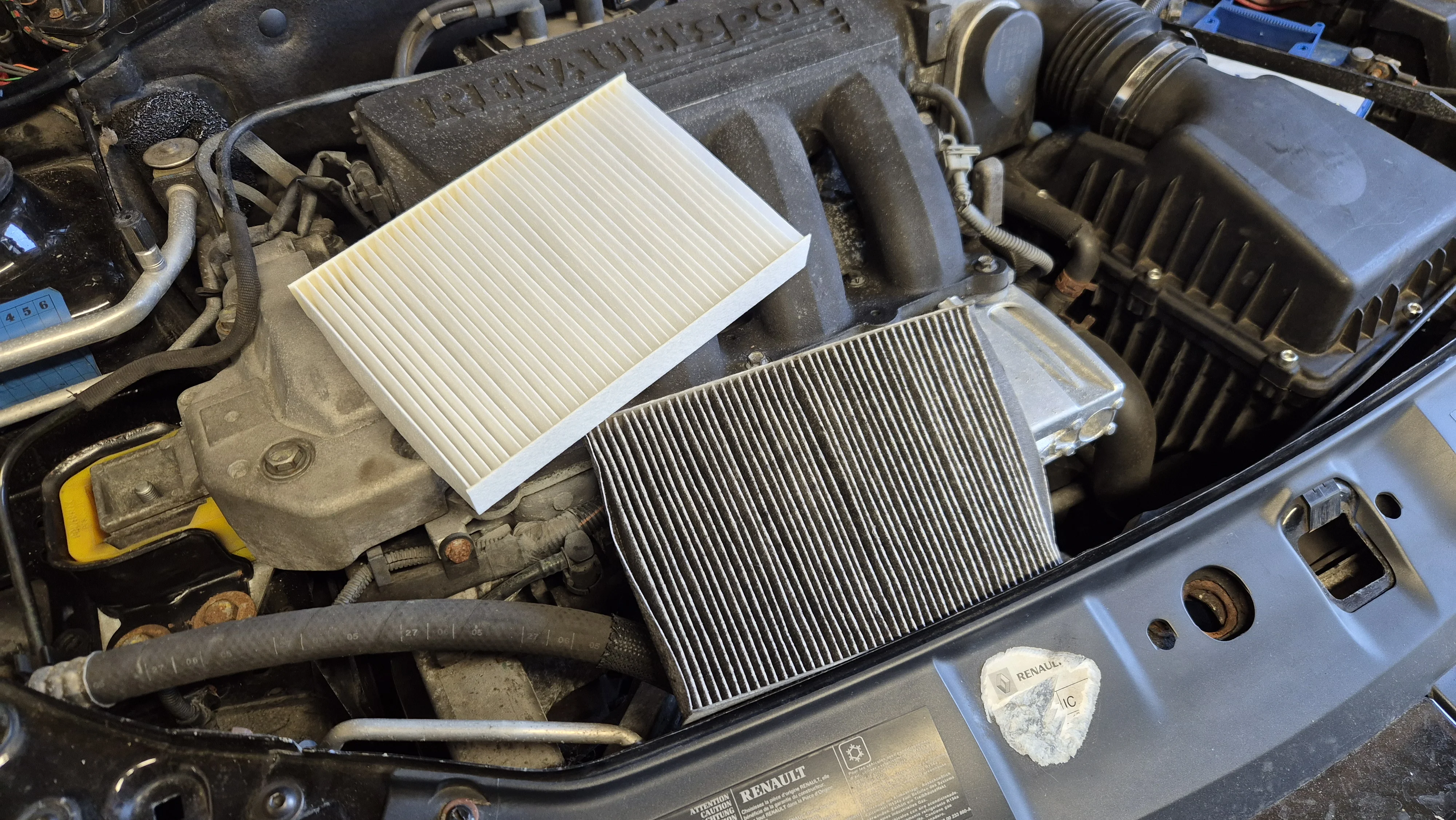

Cabin filter... This looked promising.
Yikes.
Fresh one in.

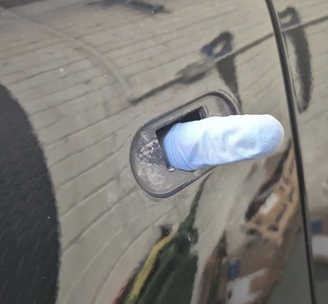

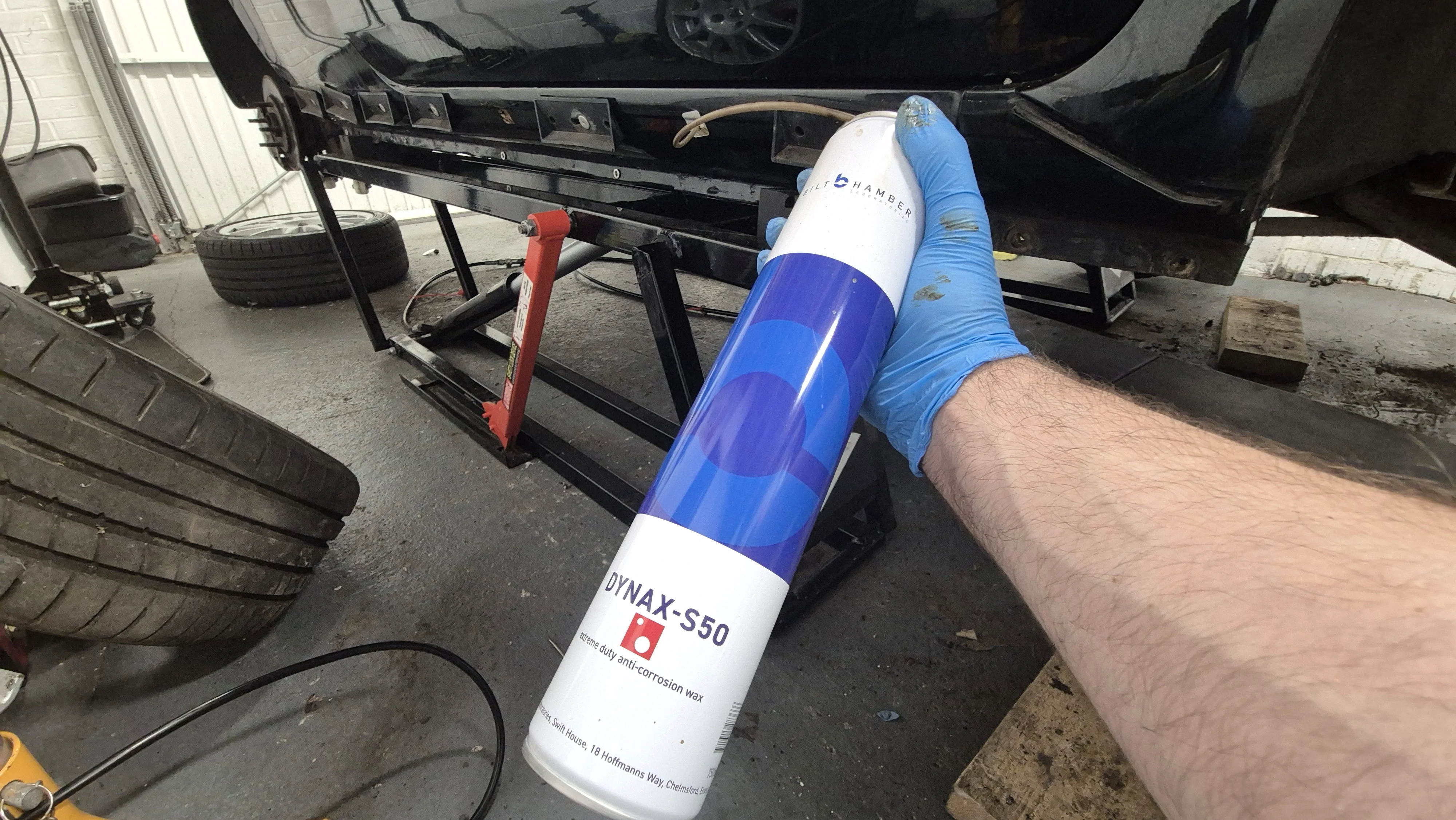

Then I did a bit of this.

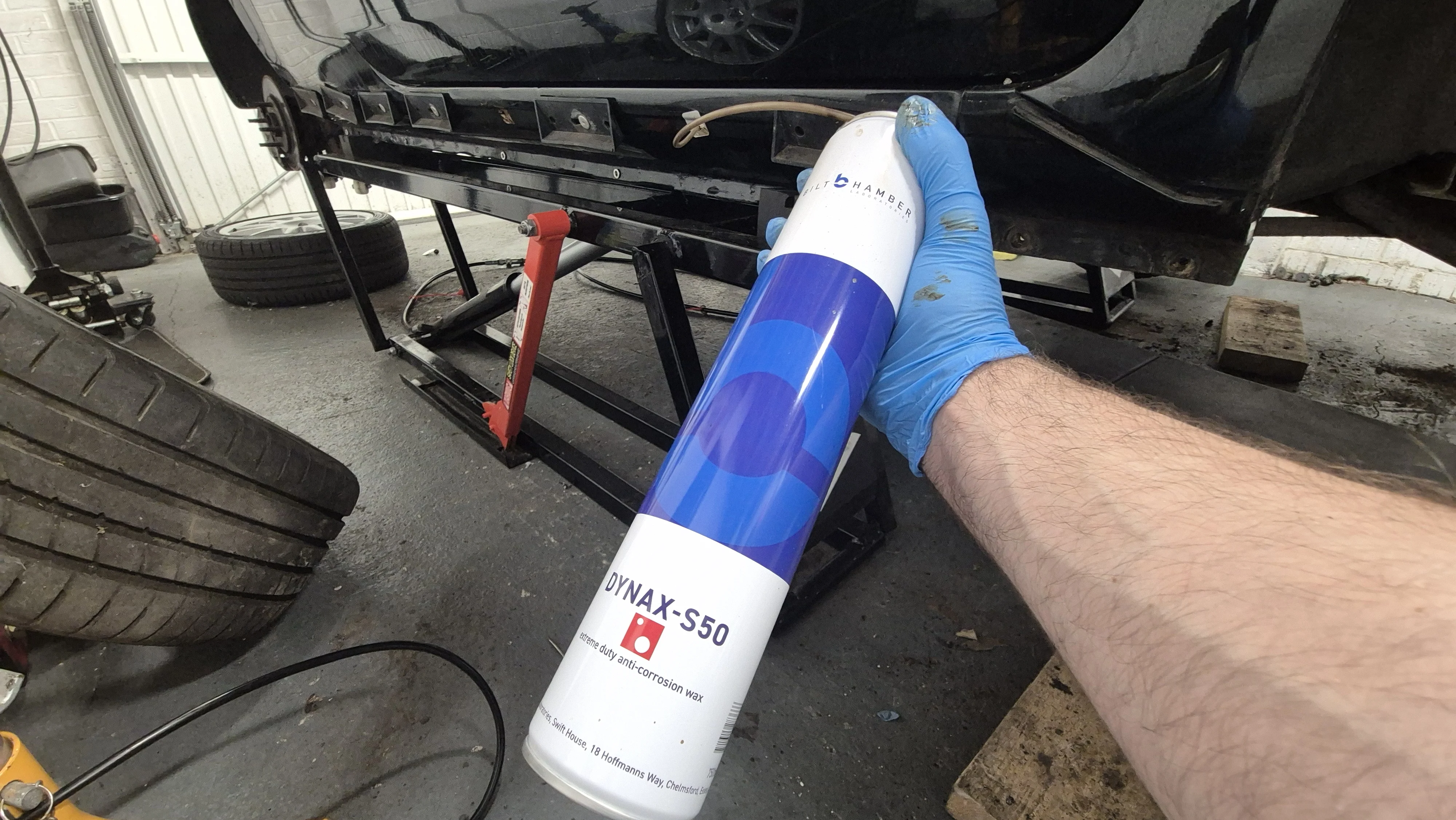

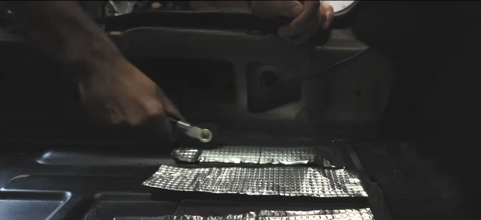

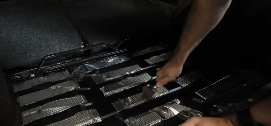

And treated some of those usual areas.

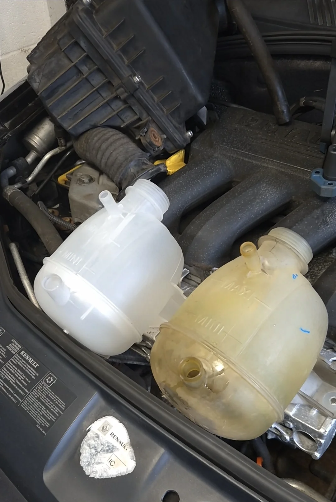

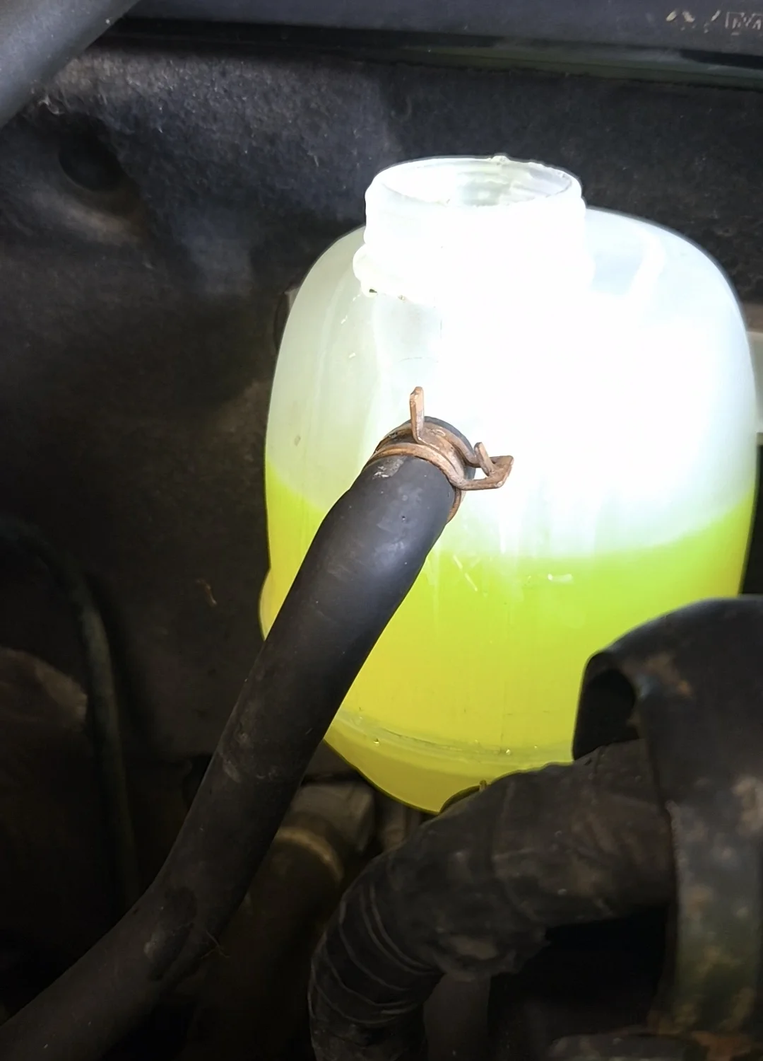

Then I changed the coolant and coolant bottle.

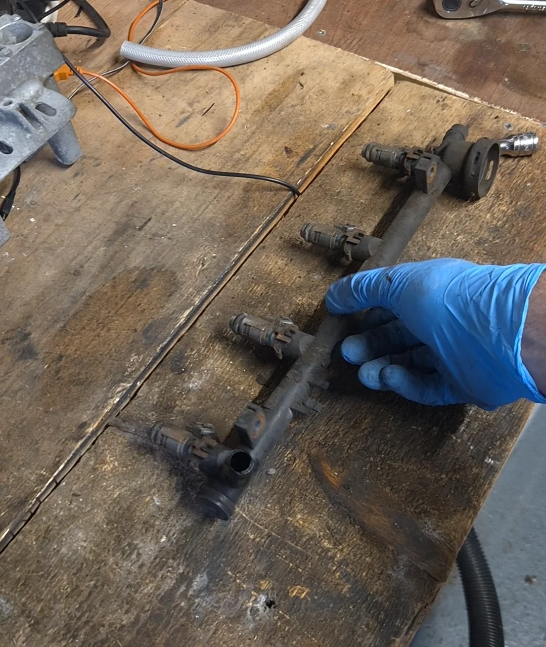

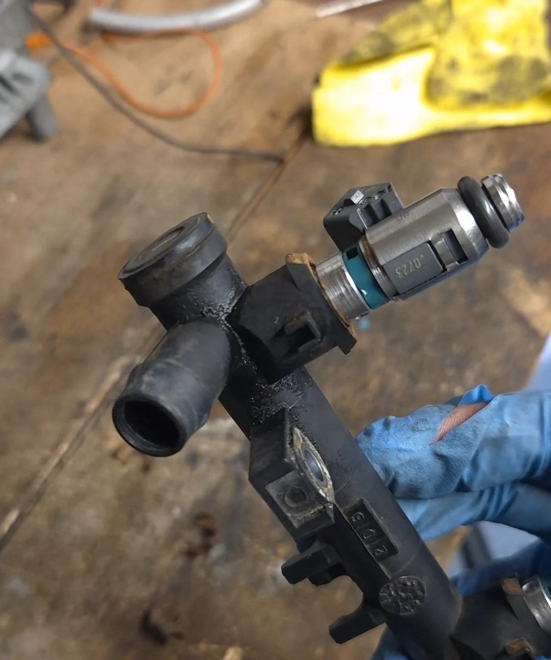

I had some almost brand new injectors laying around from my 172 Cup before going 197 injectors, so I dropped them in.

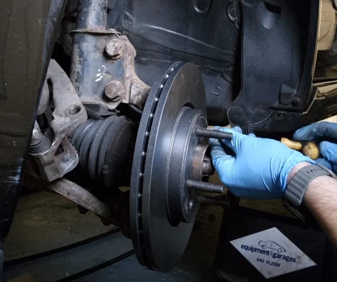

I also fitted new front brembo HC discs and pads.

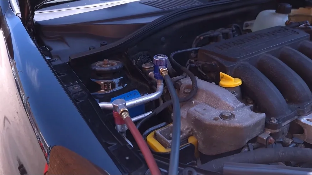

Absolute paramount was seeing if I could get the AC working. I booked it in at FitKwik, yes. Well, they are so close to me and they offer a "free test of the system before regassing", which given it's a 20 year old Clio, I couldn't refuse that free test.
Good news, there's no leaks. So the system was regasssed and the AC blows icecold.

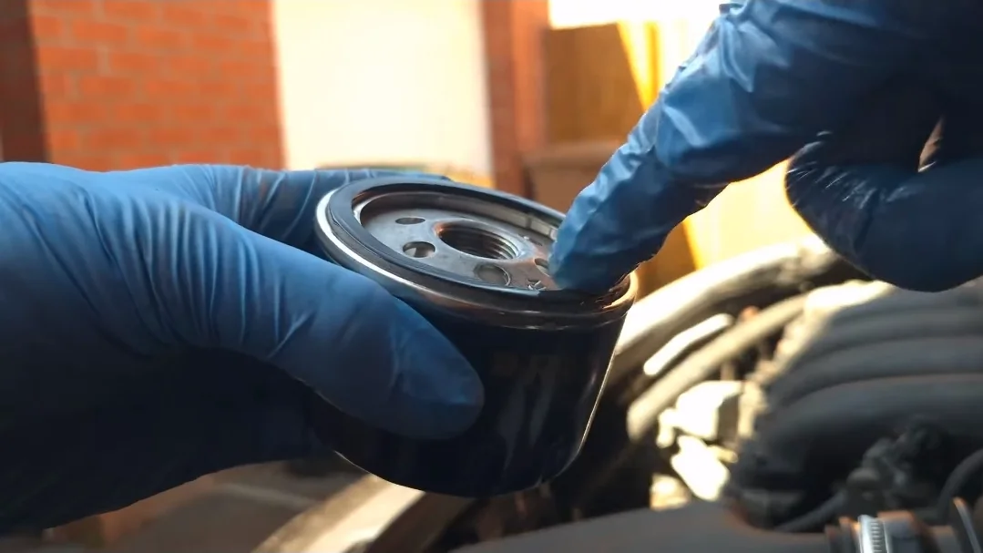

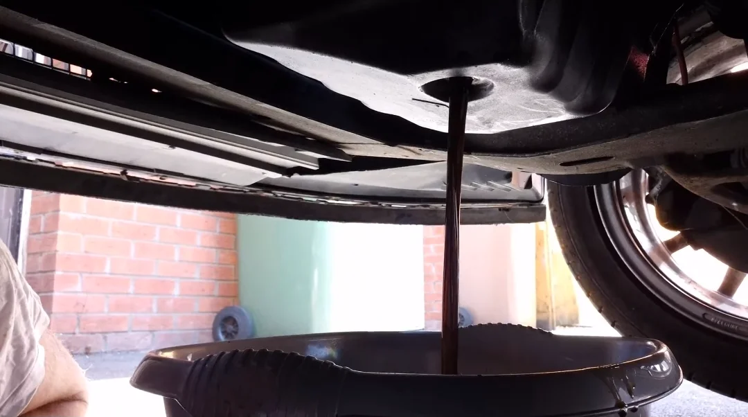

Next, oil and oil filter.
Oil that came out wasn't bad, had hints of brown colour to it still. Which was nice.
Dropped in some Fuchs Titan 5w40
OEM filter.
Lubed the rim.

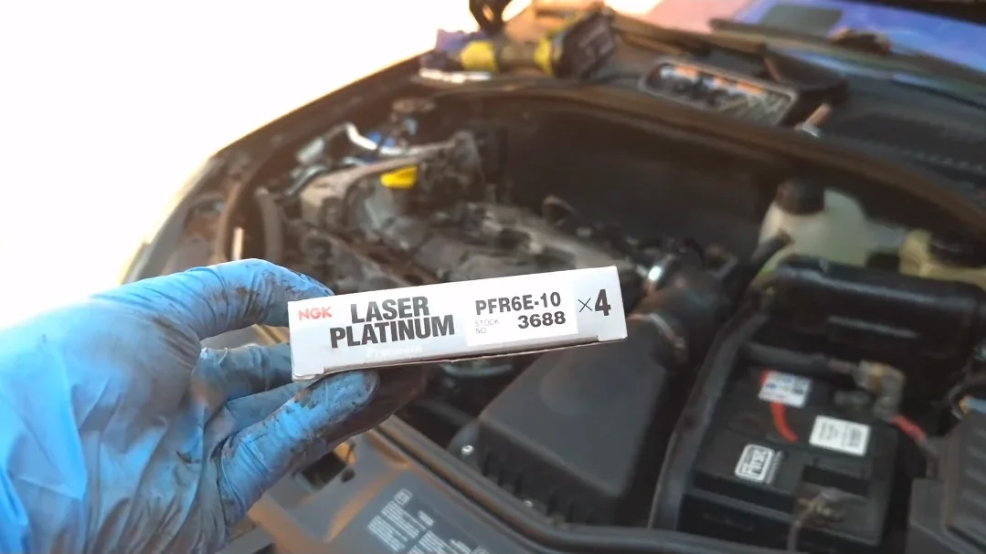

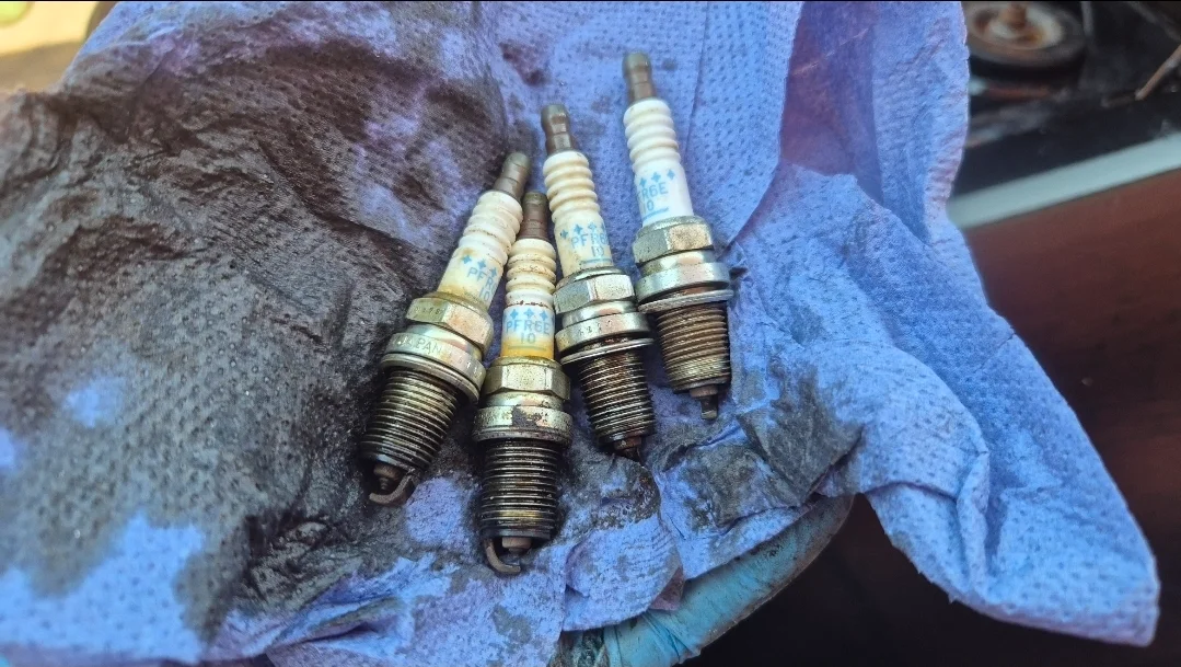

Spark plugs. I don't know when these were last changed and they're fairly cheap so fitted some new NGKs.
Cylinder 1 (driver side?) has a mild oil leak in the cylinder, which could be coming from the VVT solenoid, or could be a rocker cover.
Fresh ones in.

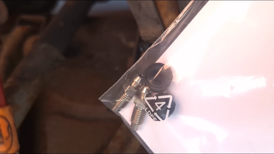

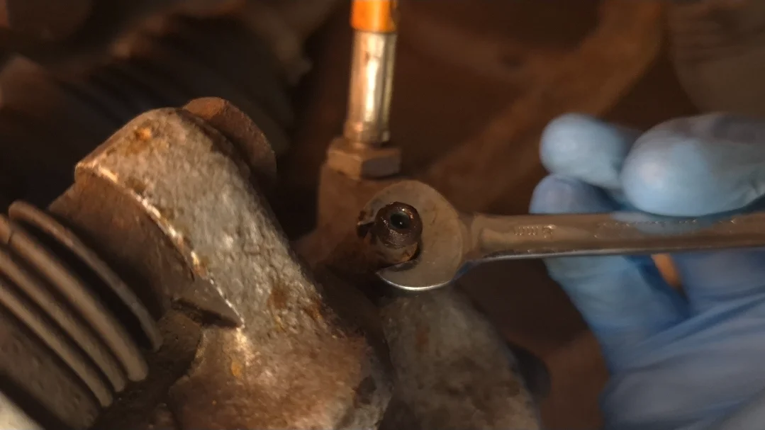

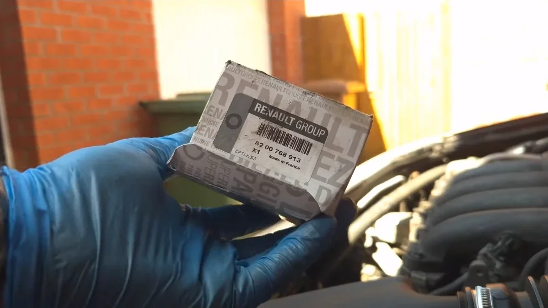

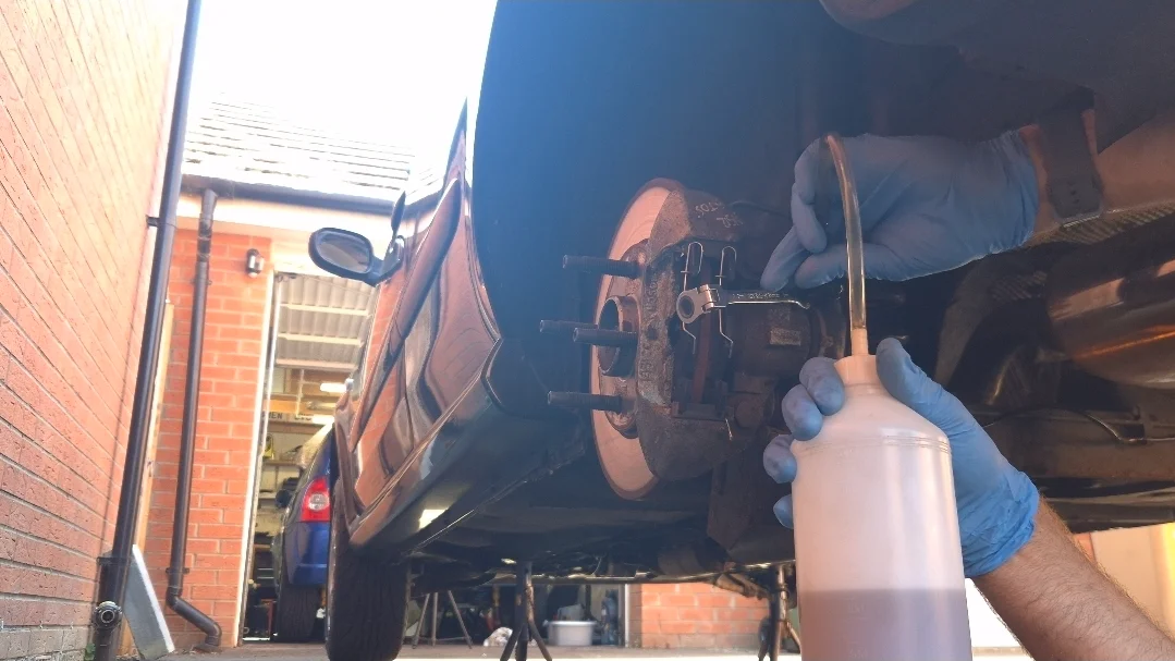

Bleeding the brakes, again. After the initial brake issues I had bled the brakes but I knew it needed doing again.
Having done this once, not long ago I spotted this.
Doesn't look it, but it's round.
So I ordered a replacement.

Yeah, originally I didn't use the open end but this was the second rodeo and I knew it was a shape science hasn't named yet, so placed the open end on it to see how bad it was. In the end I used a smaller sized socket.
I googled the cylinder order as I knew/thought I was wrong. Turns out Google is wrong too 😅

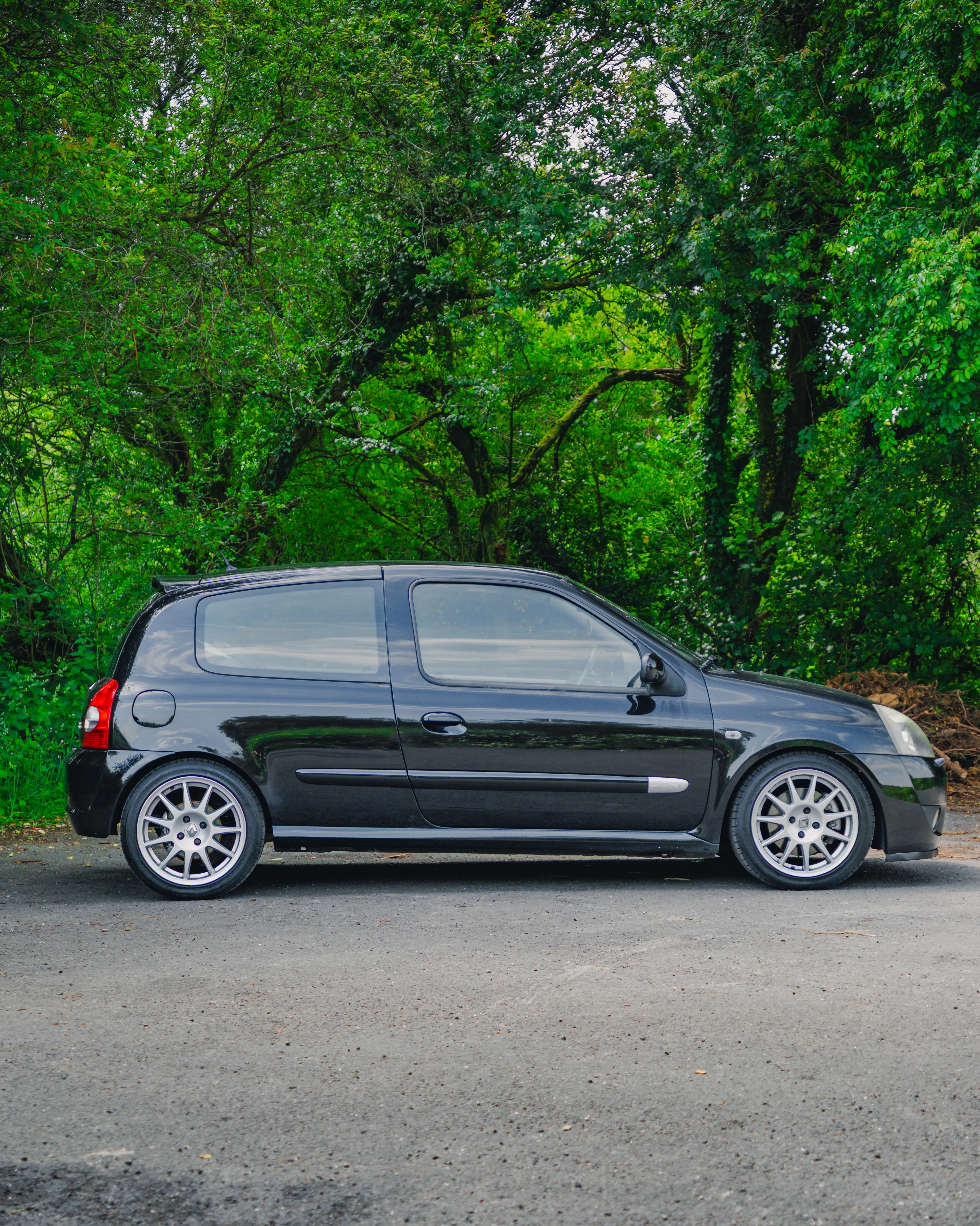

Some recent pictures.
Genuinely prefer the Turinis over the 2118 on the 182.
