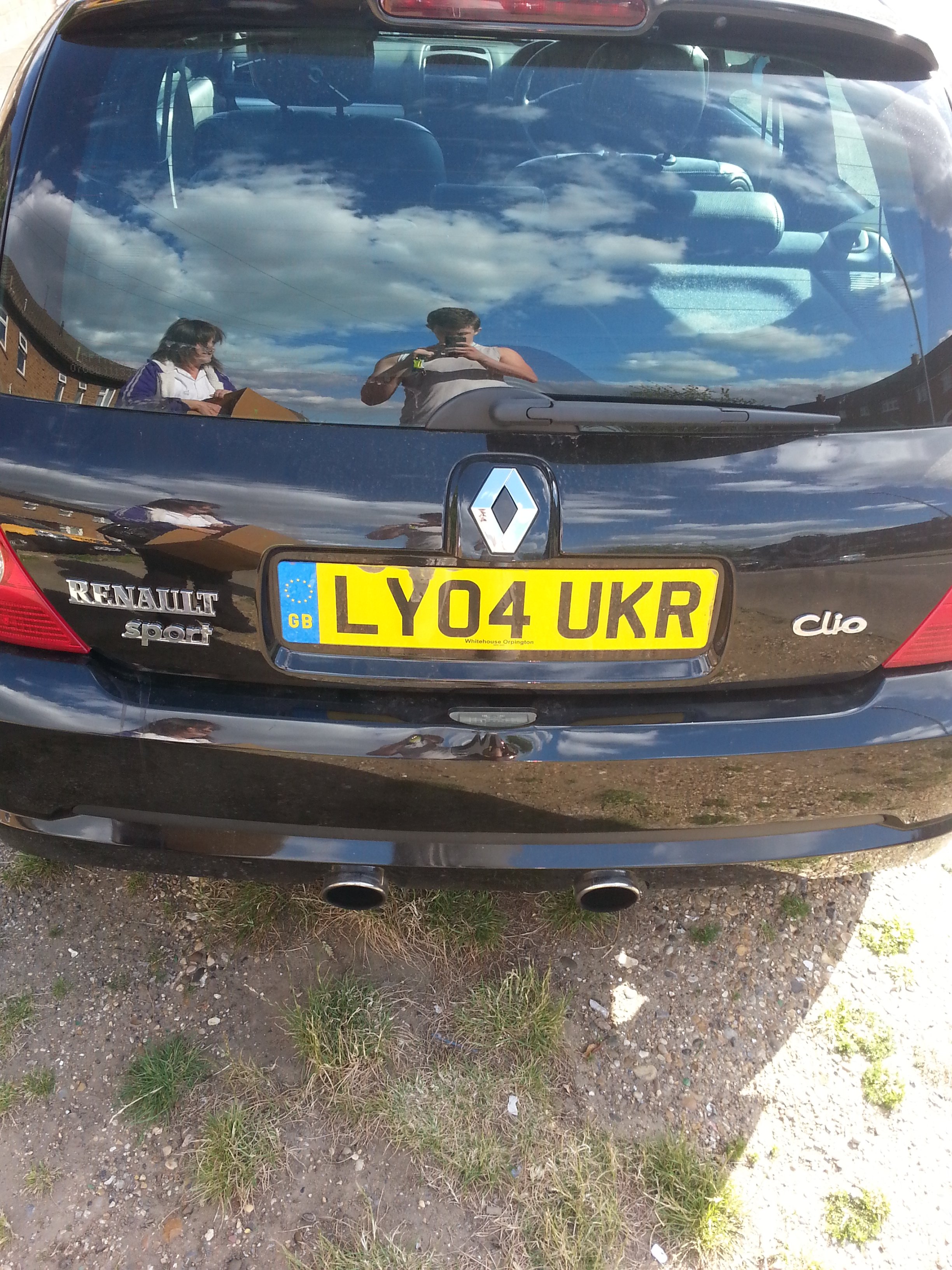

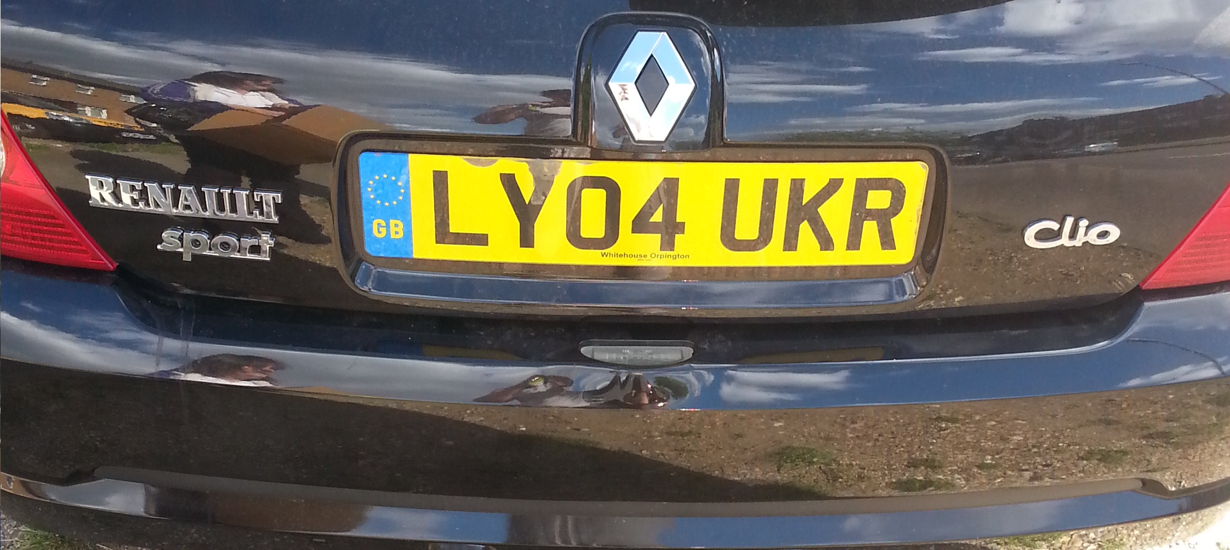

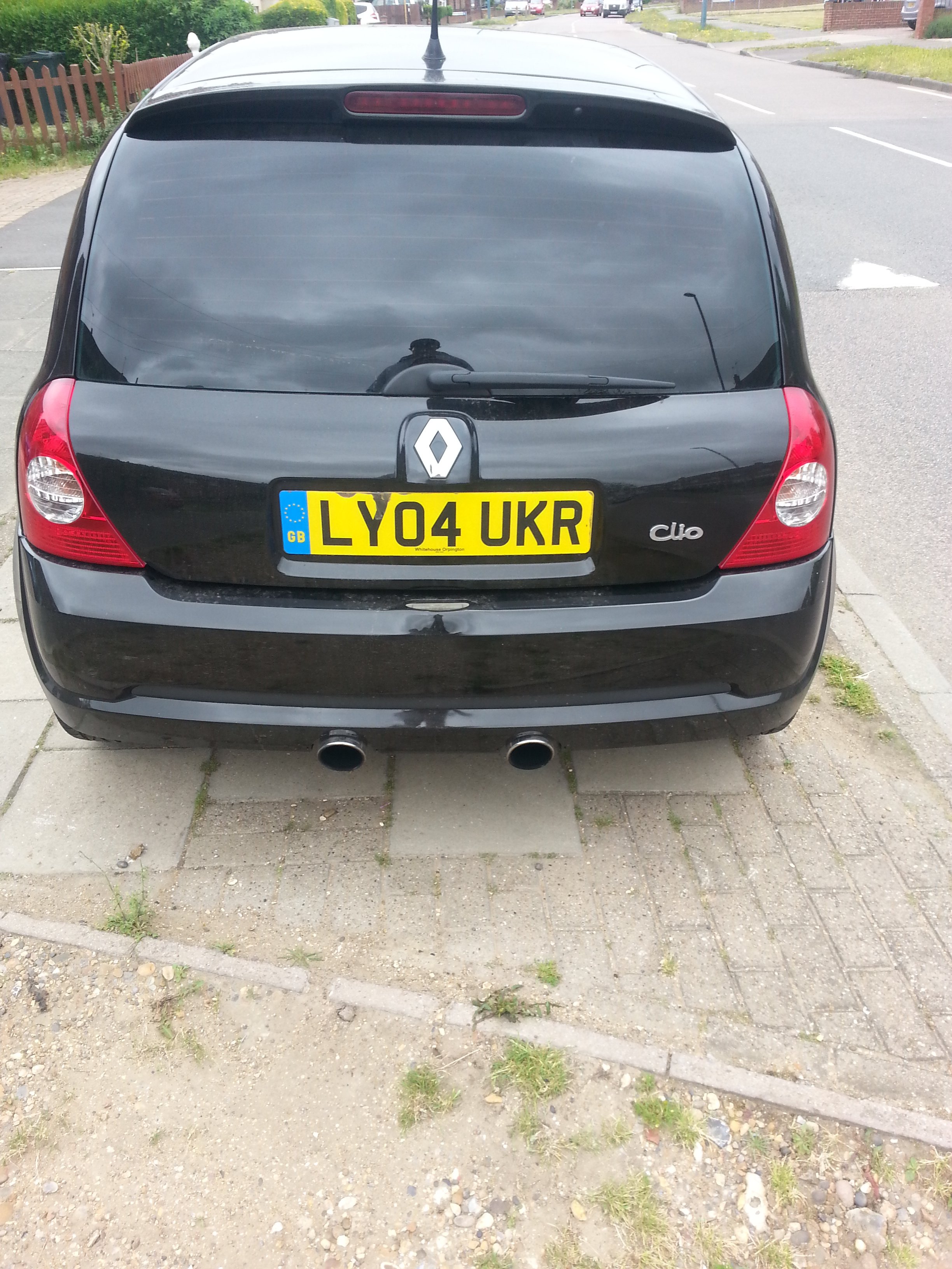

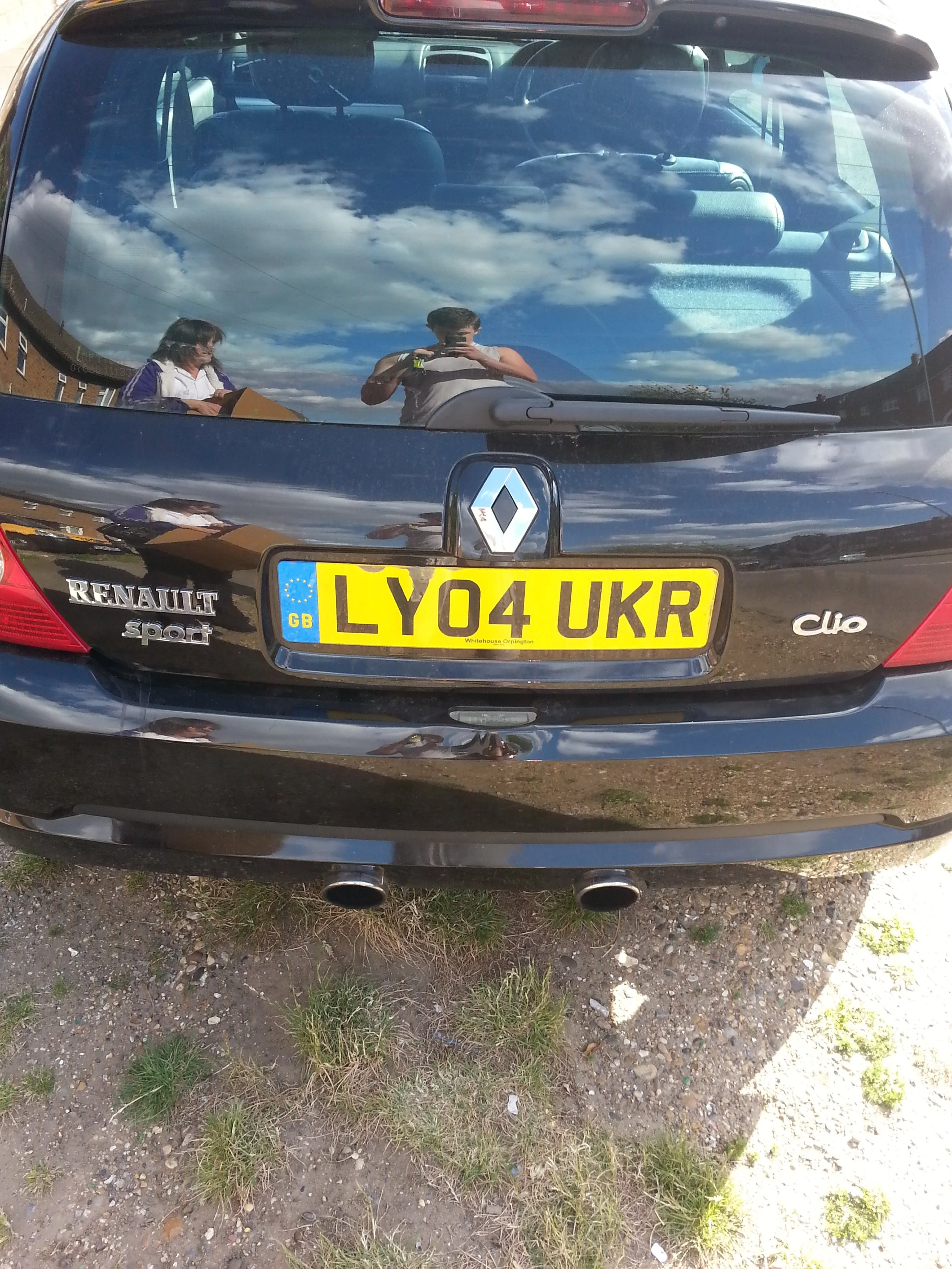

Today my clio and sport badges arrived but still waiting for the renault one, so I got clio fitted to cover up the holes and now im happier with the back already.

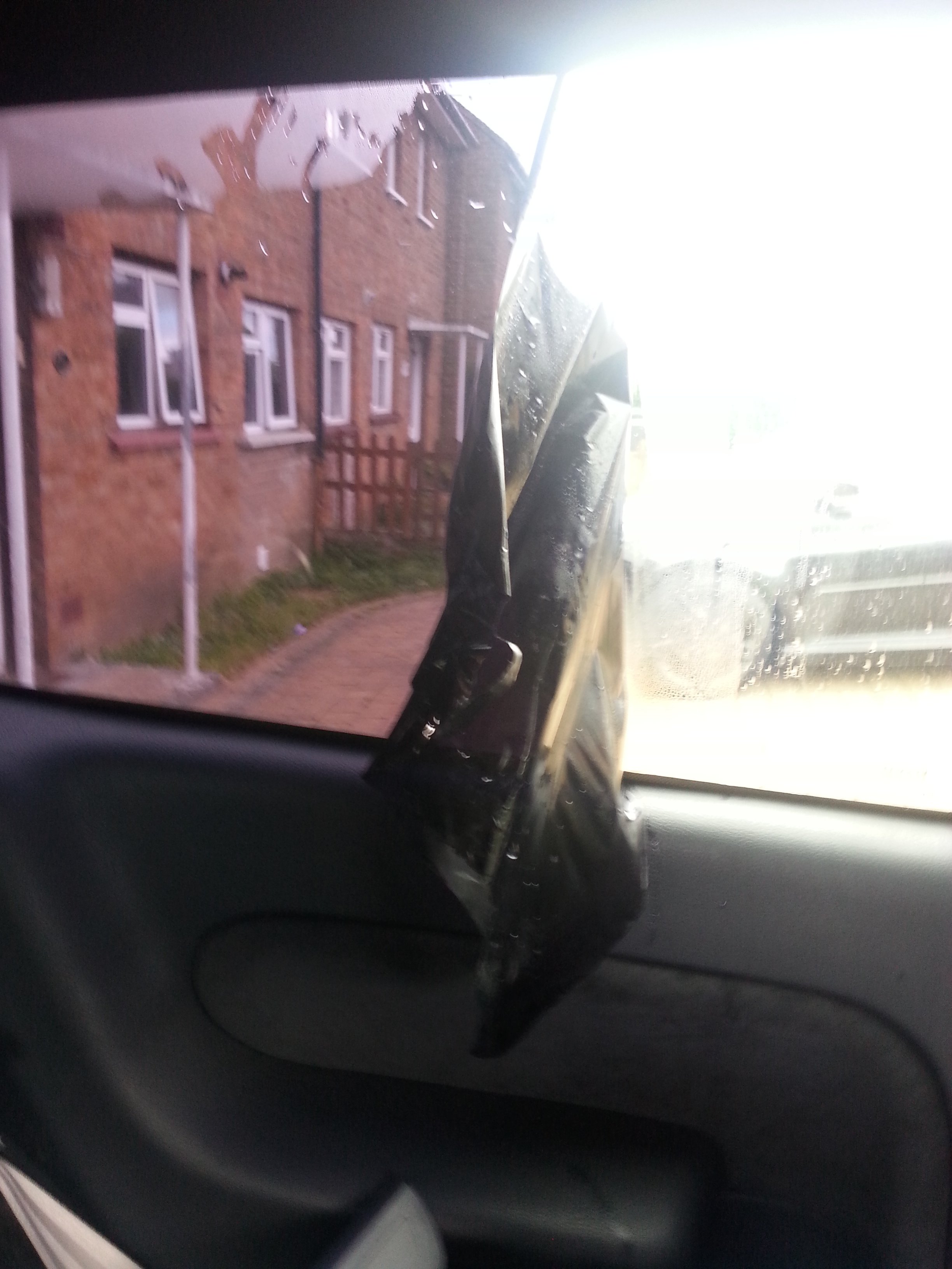

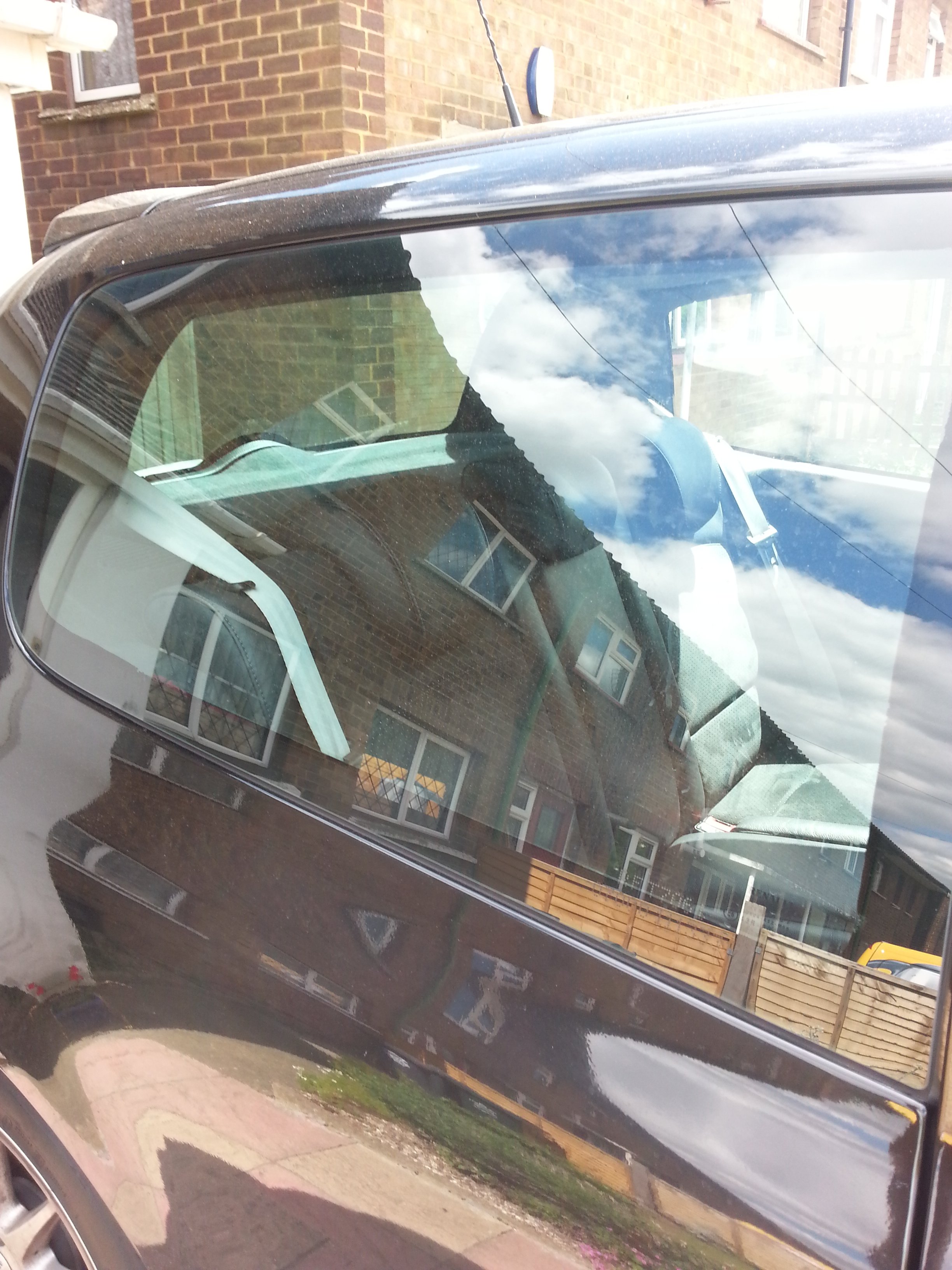

Got a bit more done today, the main job being the removal of the tints from the last 3 windows and removing the glue left over from doing it on the front two windows. I found that as long as I went slowly and kept the steam on it then whole time I was able to get the last 3 off without leaving any glue behind.
This is how it was looking part way through and below is the finished product.
After this, I fitted the last of the badges for the back and now the rear of the car looks like it should again.

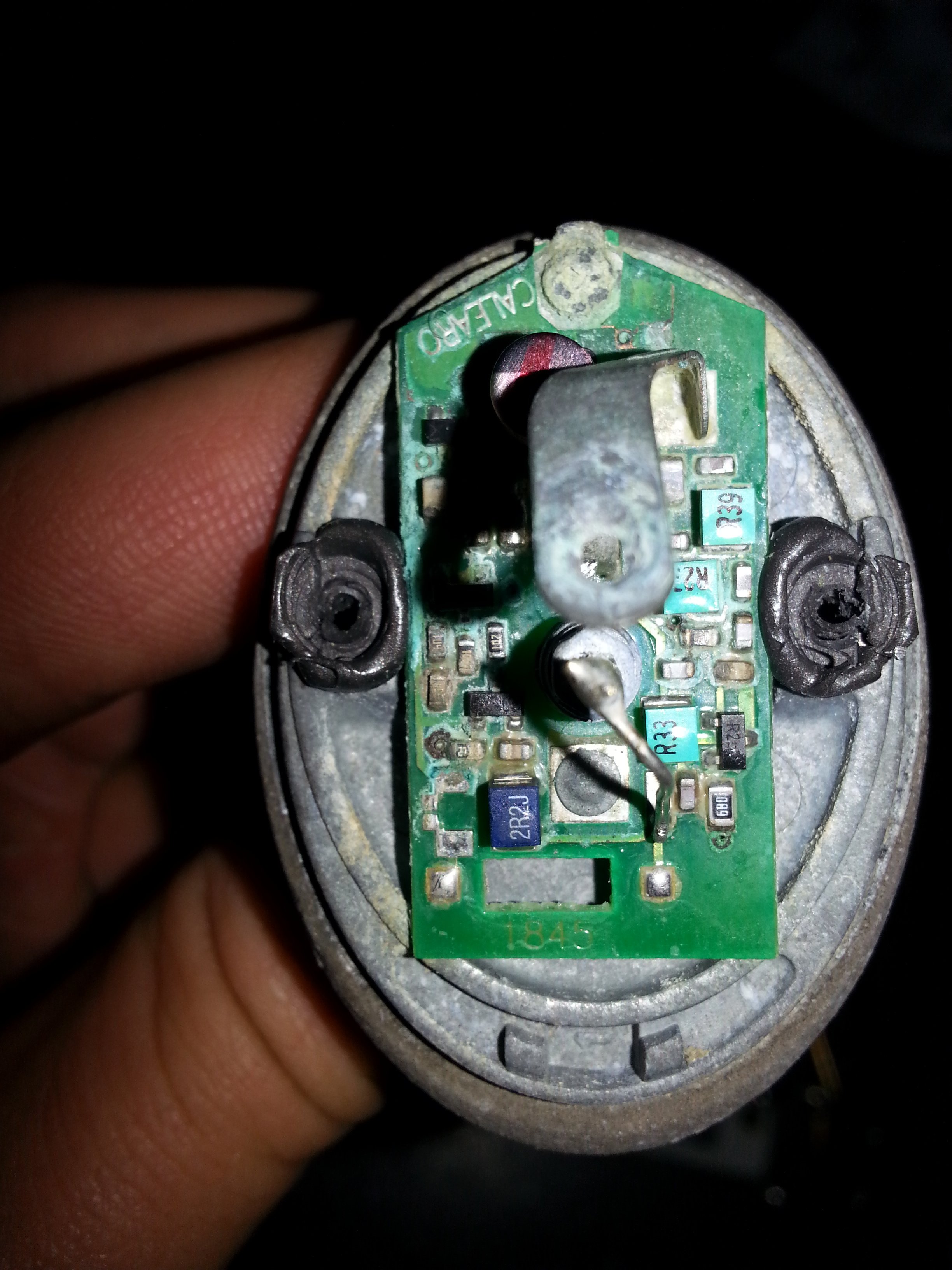

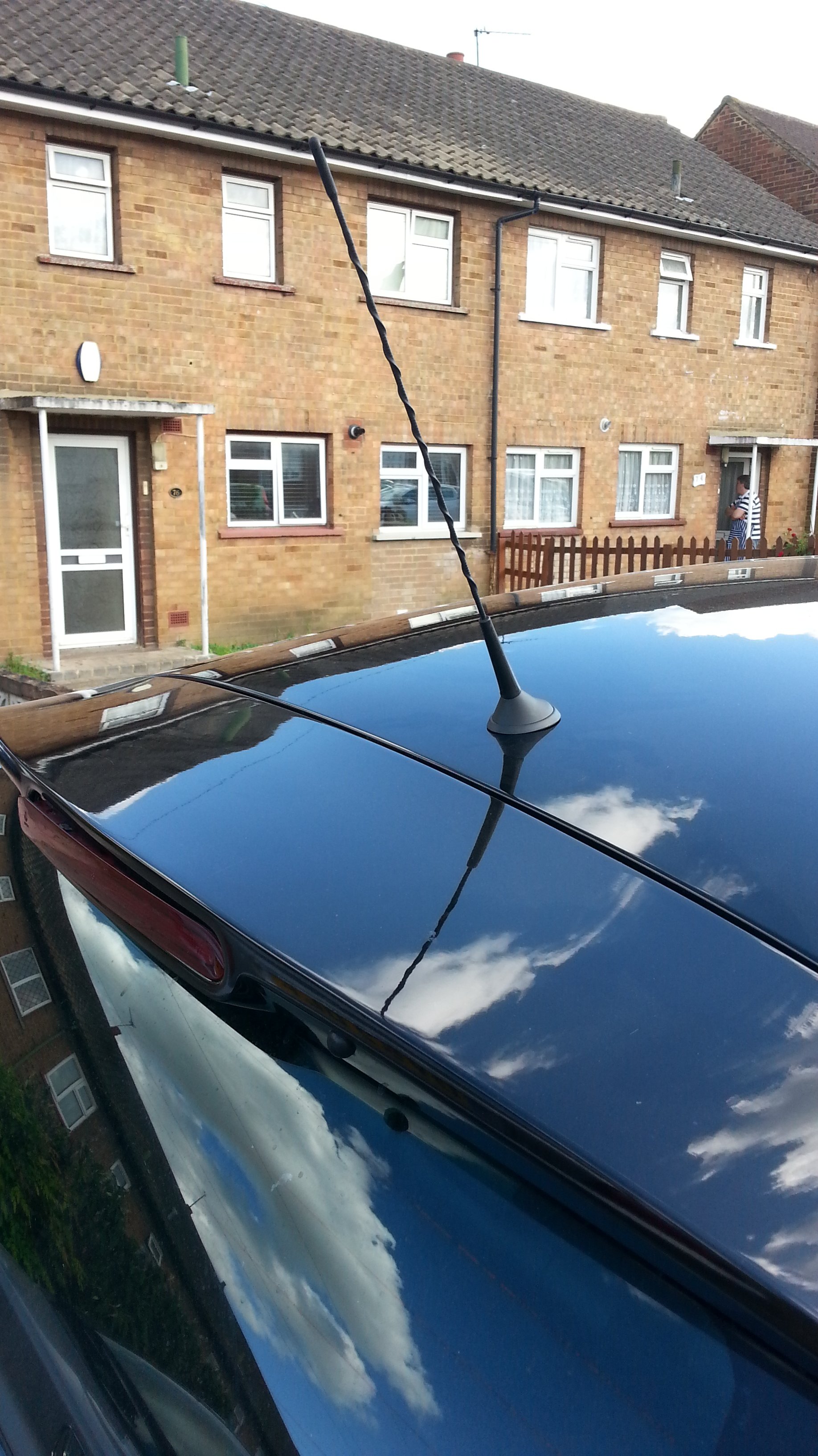

Got some more done over the past few days, taken the old aerial base off because I could only tune in to radio 1, once i got it off i took it apart and it looked like this inside.
Then after my new aerial base arrived today I got it fitted and gave the car a wash.
So I'm pretty happy with the car now but there's still a few more jobs to be getting on with such as the air box and air filter which are in the post and should arrive next week then the car will be almost how I want it.
Looks like the steam removed the excess glue well?
Cheers, has given me an idea on how to remove the glue attaching my number plate to the car. Looks like it has been put on twice now without cleaning off the excess!
yeah the steam did do the glue as long as I heated it up for long enough, it got the excess glue left on the front windows, from when i rushed peeling it off, easily as well. So I don't see why it wouldn't work on number plate glue too.

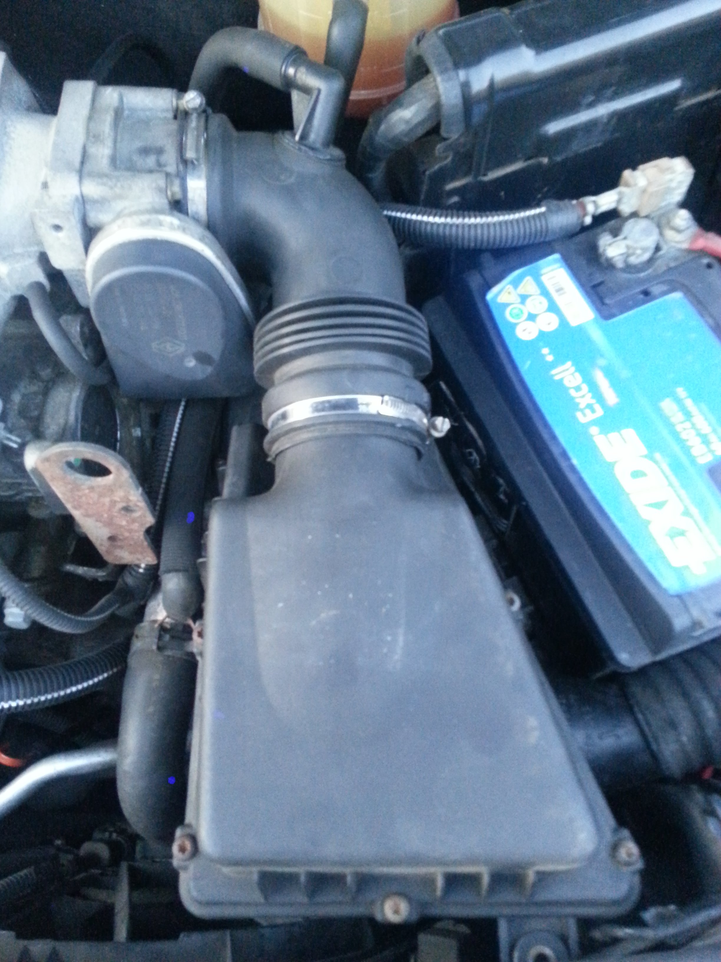

My air box and pipercross filter arrived yesterday so it was on with the fitting today, didn't remember to take a picture of the set up it was running instead but needless to say the filter was very hot even after a long motorway trip, so the standard air box and cold air feeds are back for the time being at least.
I'm pleased with this, it went on easily and now I won't be losing performance to heat soak. However, I do miss the induction noise that the old cone was providing but performance has to come before sound.
