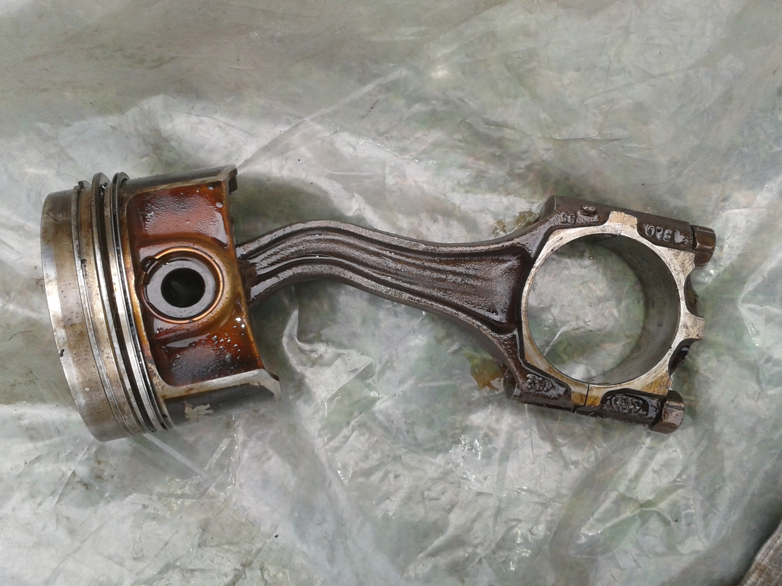

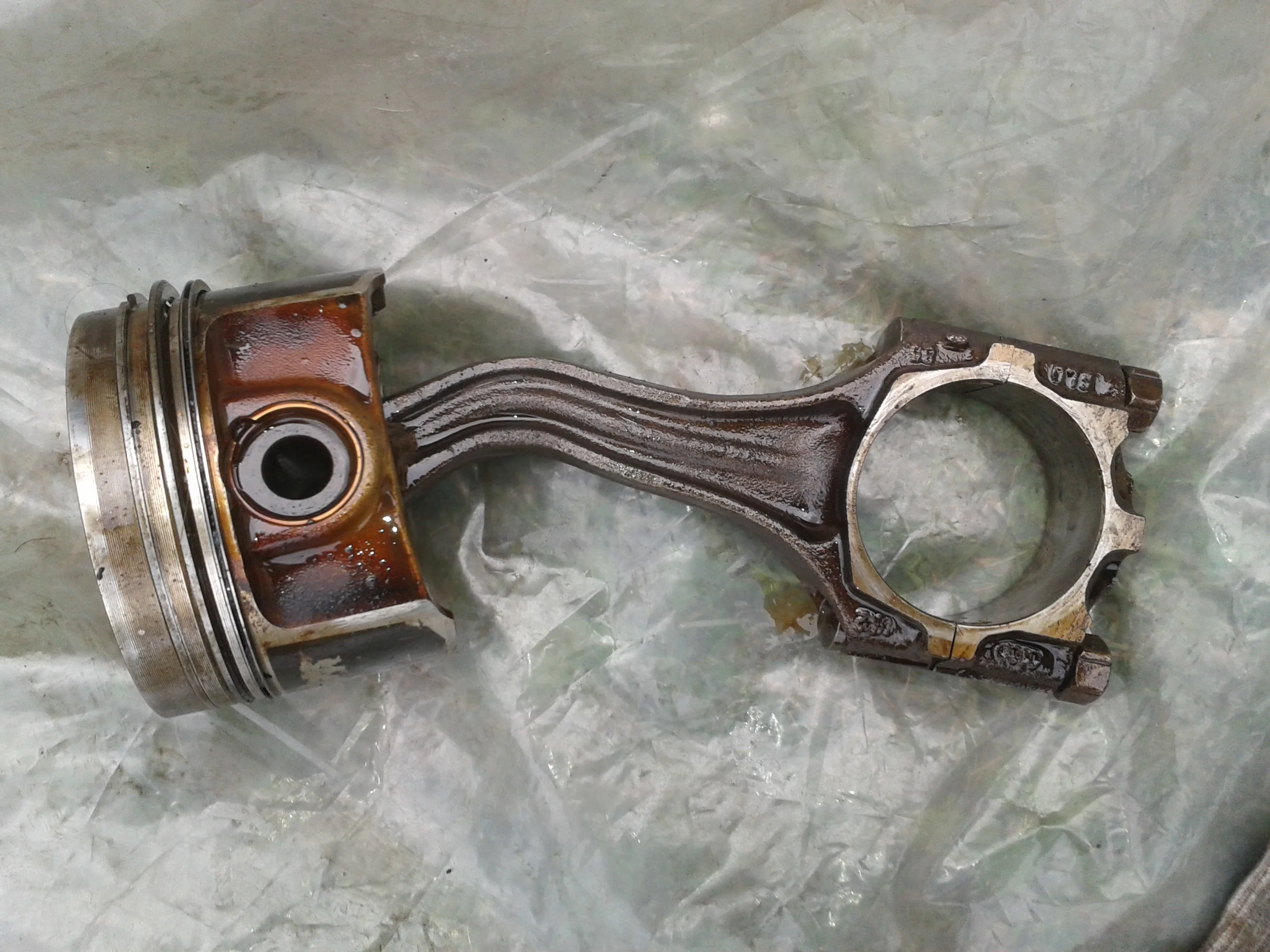

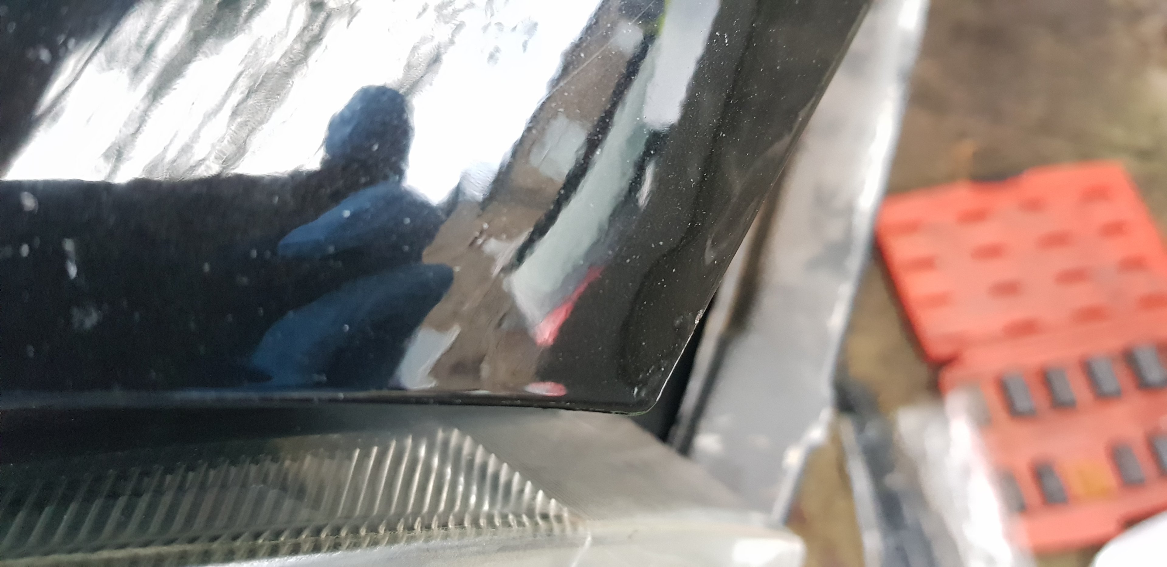

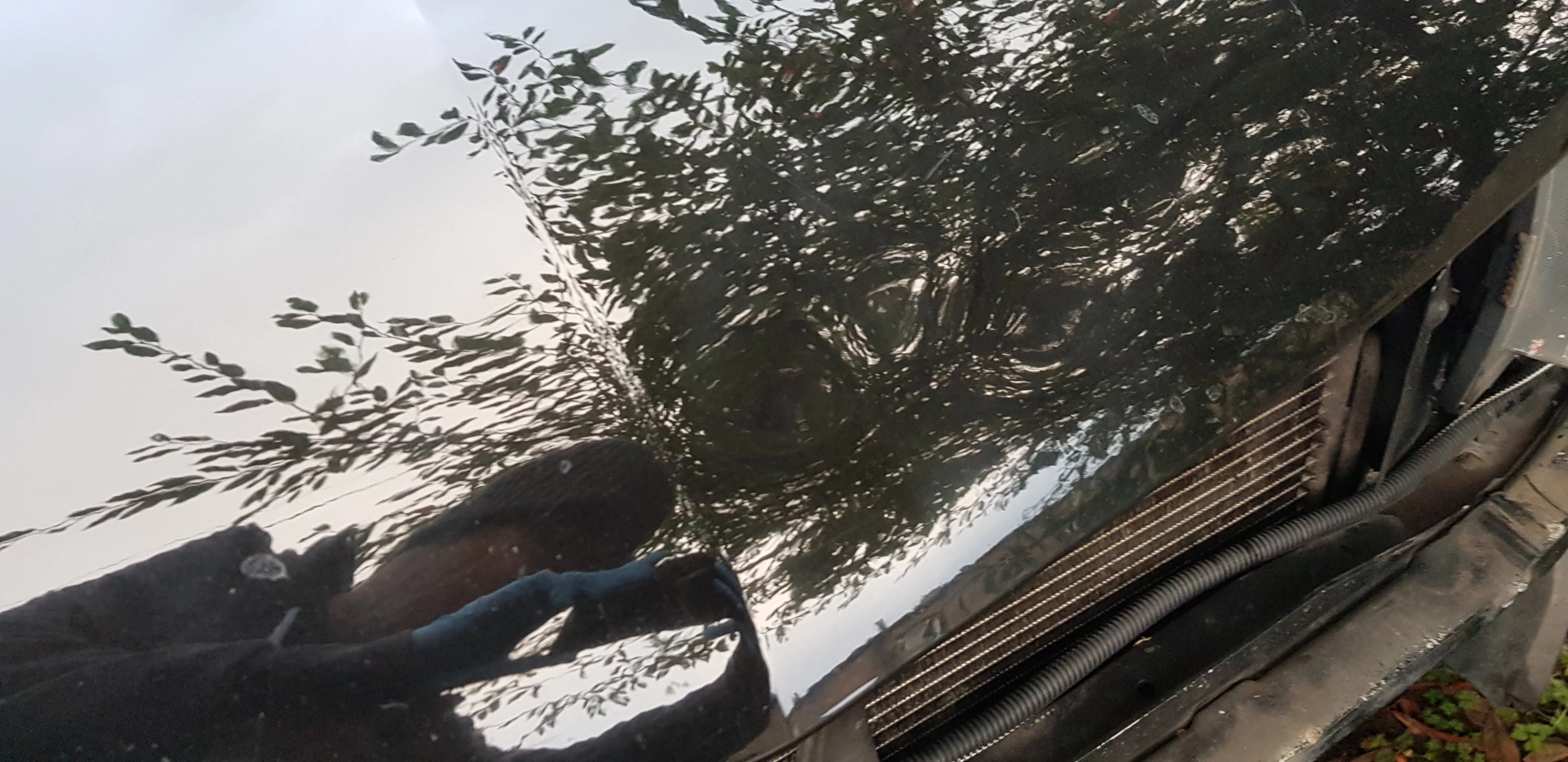

What condition is the bonnet in?
Small dent thatd pull out, tiny bit of rust starting on the lip. Front bumper has a small scuff low down that'd most likely machine out and the drivers door has a small scratch otherwise it's mint. Car bodywork is decent just a dent on the passenger door where someone has opened it into a wall or something.
