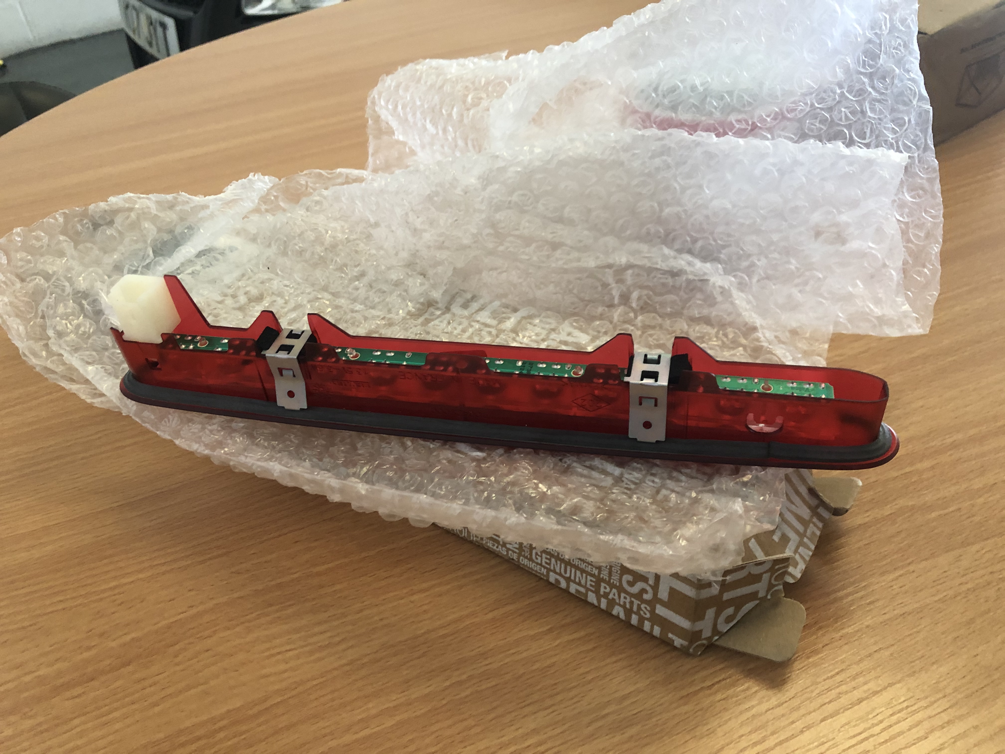

It'll be the board itself due to water ingress. Very common fault.
The lights themselves are NLA now so new old stock or good used command a premium if you can find one.
However there's a few on the Facebook groups offering replacement LED strips you can fit to the original casing with just a small soldering job I believe so worth checking that it as they're 30 quid for that rather than around 100 for a new unit

Best bet is to remove the spoiler and gentle press the unit out from behind. You can prise it out from the front but risks breaking the edges.
Then when the units out it's easy to see the board and remove it
As above, there's a guy on csoc on Facebook that's selling just the boards. He posted the other day saying he's about to get some in stock I think. They're 30 quid posted.
Mine stopped working and I needed it for the mot so got an led strip from toolstation and bodged that in. Does the job and only cost me a fiver.
I’ve had a replacement strip off the guy on Facebook who makes them himself. Been fitted for a year now and still works fine.
