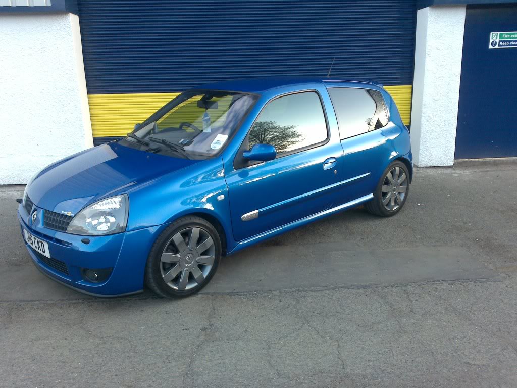

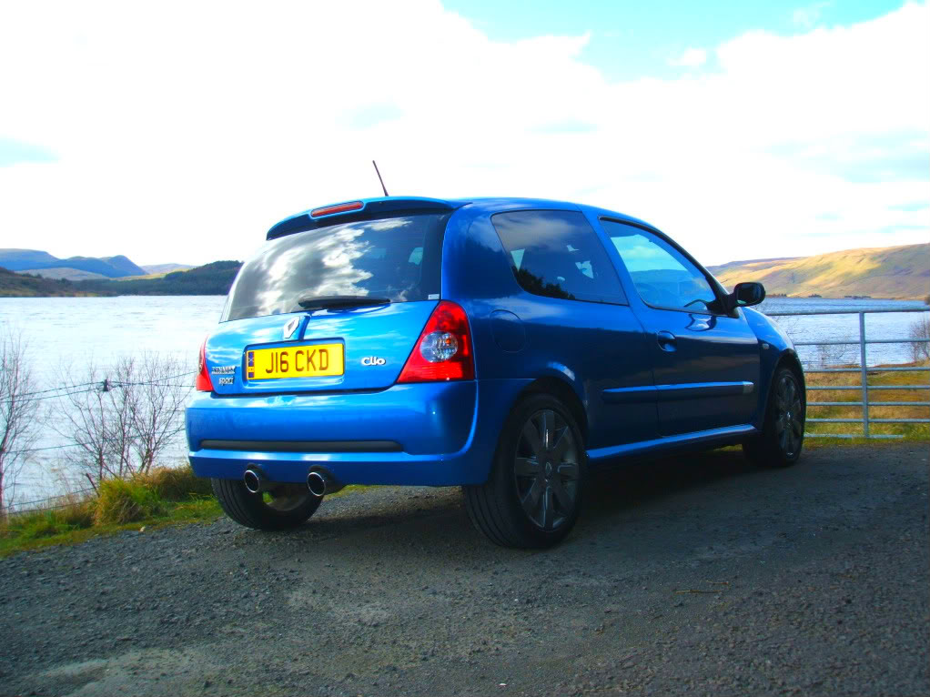

i just put sportlines on mine and are brilliant mate....the ride quality is immense for lowering springs
Before
After
