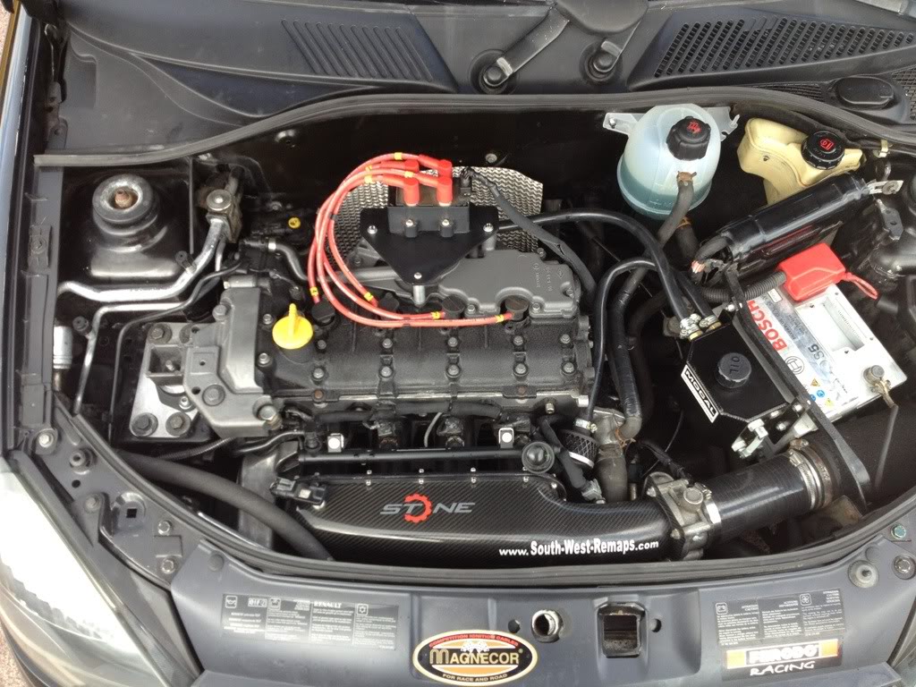

This is the one my mrs uses, thats the best fitting one ive seen on a 172 yet but its quite dear:
We've swapped to a better quality of hose since though and relocated the filter to its out of the bay, but you get the general idea :)
