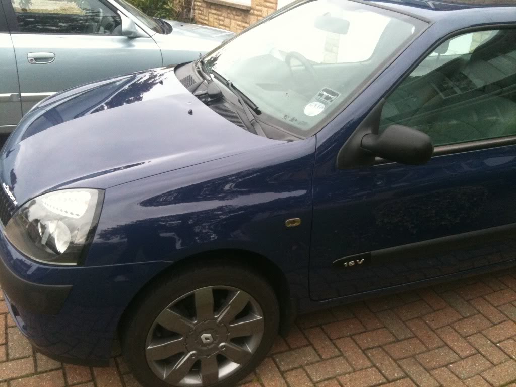

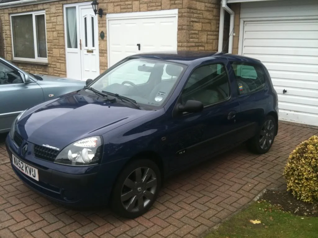

Just to clear things up. I bought 182 alloys off baines a week ago and fitted them to my 1.2 8v mk2 ph2 and the front fit fine (even full lock for mot's) The back rub marginly, the problem with spacers is they are expensive or you buy 3mm spacers and take 3mm off the thread of the bolt (which from an engineering point of view is very bad practice) but a very simple solution is to cut a small ( shape in each of the back, 5 minute solution and will not damage your car at all (I checked with a mechanic aswell)
Just pm'ed you the pics and put on the other thread where you asked lol mate, not going to look as good as on a 182/172 but I think they change my car immensly :)
