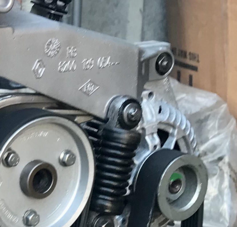

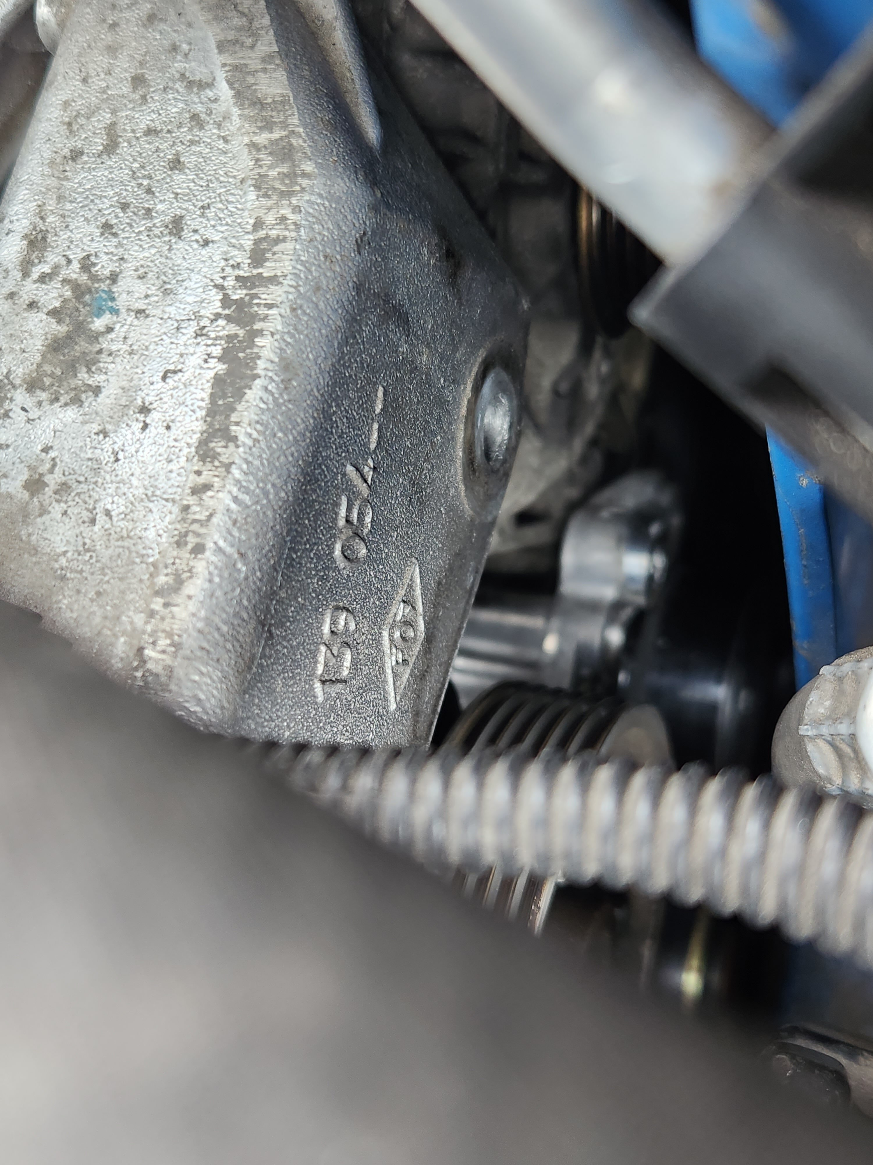

Hi all,
Can anyone tell me the part number please for the top tensiner bolt?
Mines worked its way loose and knackered the threads. I don't think it's the correct one that's been fitted.
Aux belt came off but thankfully not taken the cambelt.
Any help would be great
Thanks
The bolt that goes here.
Have a look in the couple of threads below where it seems to have happened before. Seems like Renault don't list the part number for the bolt, but the advice given was just to use a normal bolt.
Yeah I've had a look at them but can't seem to find the size I need unfortunately

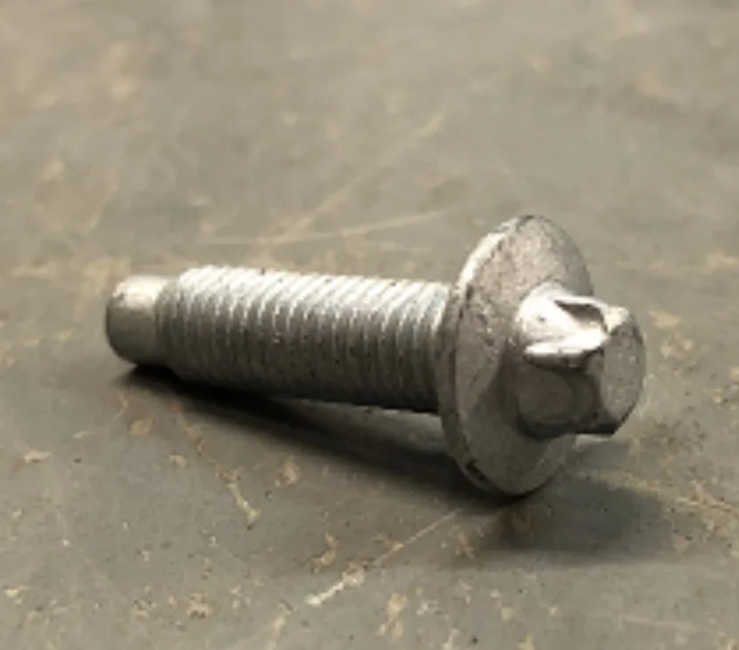

That’s the bolt. E12 Torx screw. I’d wager it’ll have a fine thread (1.25mm). So just get an M8 1.25 x 30mm hex flange bolt and washer.
