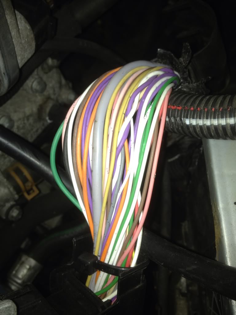

Chances are its a break in a wire in the ecu loom.
Disconnect the ecu and take off all the cable tape and plastic wrap off the loom from the ecu all the way to the white multiplug
Obviously this job is easy but it takes time.
Check every wire and take special attention to the canbus wiring in the loom which will be a white/purple or white/grey wires twisted together like in the photo below.
Look out for any green powder on the wires which means there is corrosion somewhere,
Take your time and look closely as some wires are extremely thin
