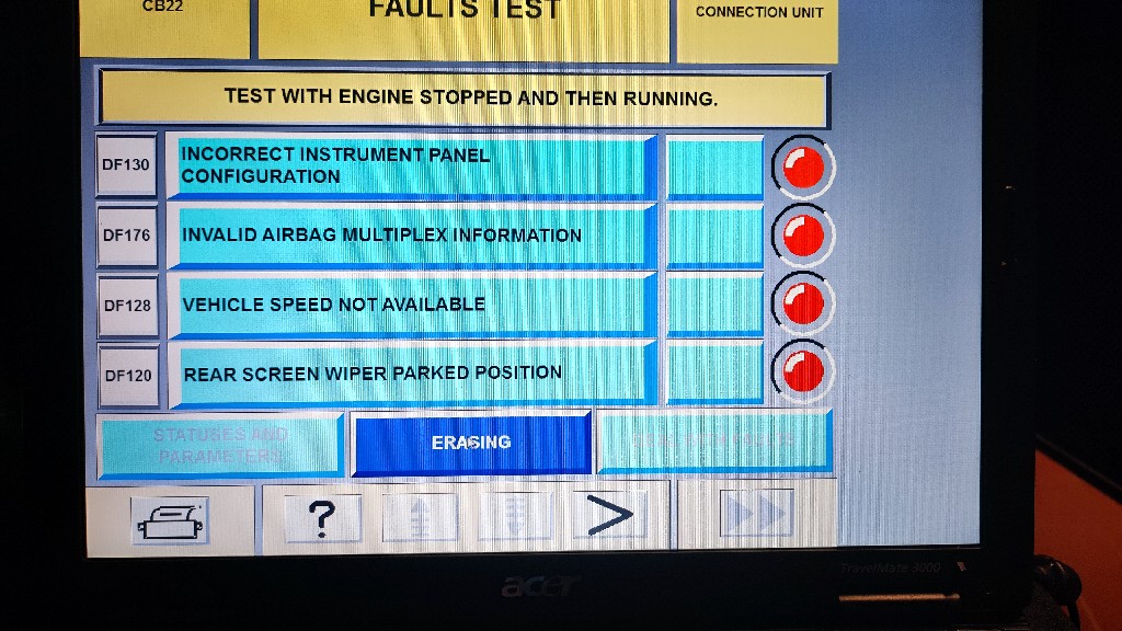

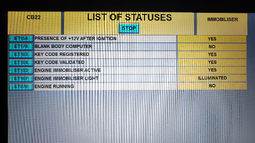

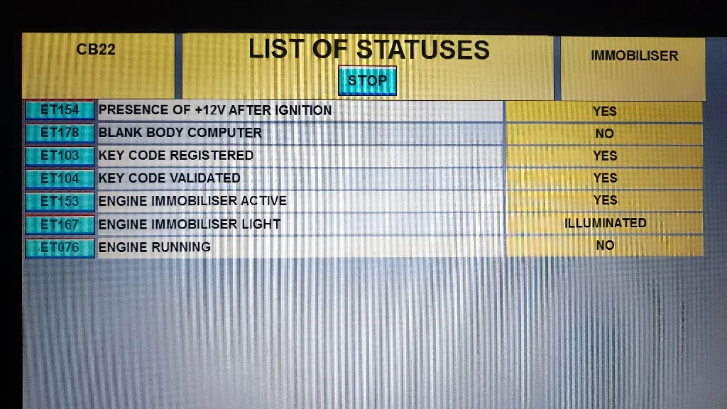

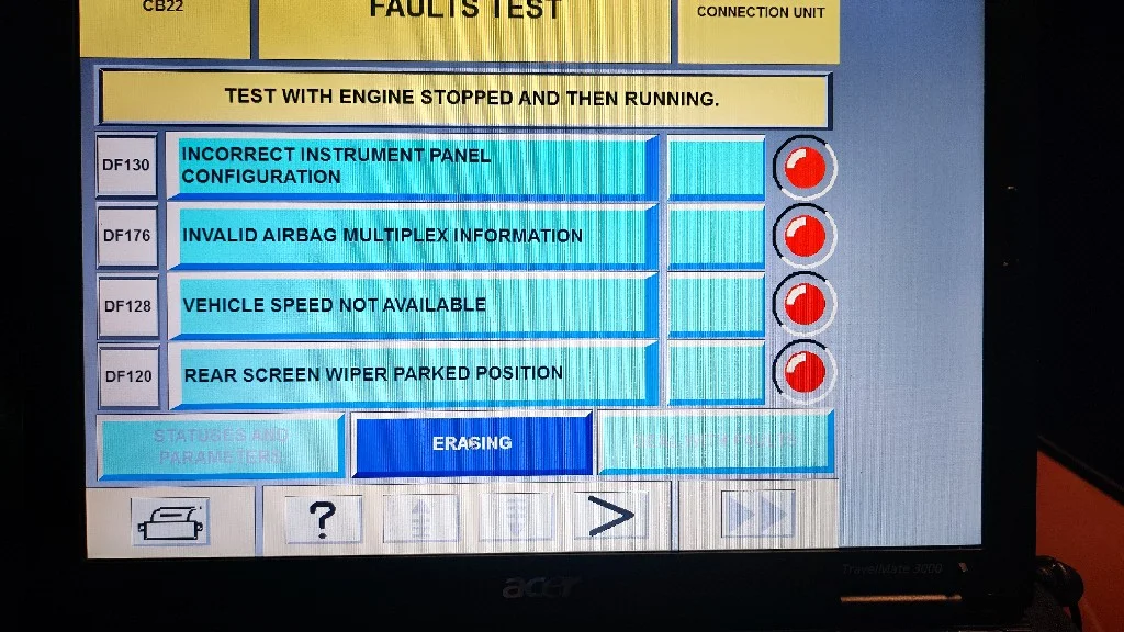

Hello guys, a little bit of update after a lot of investigation.
Just to be safe.. I rechecked all the fuses and relays, connectors and so on.
I decided to have a deep look with clip.
What I found is that with oem everything is fine, no errors no weird things and everything works.
When I do it with gen90. It gives me an error about a "short" to check with fault finder. And ok that may also not say anything useful..BUT:
If I check on the immobilizer section I see that the key has been recognized but the uch is somehow giving a stop putting engine in a lock as you can see in the picture. This explains the red light solid and not cranking.
Checking the uch stored faults.. as you can see I also have this error about dashboard misconfigured..
Searching about that error I've found that it may cause the immobilizer to trigger. It can also explain why (if I bypass the immobilizer turning fast the key) the engine runs fine but has no rev counter.
Since its working with oem.. I suspect its something on the gen90 side.. maybe something that can be adjusted with GenTunerPro.
Do someone has any idea?? Please help me.. I'm desperate..
