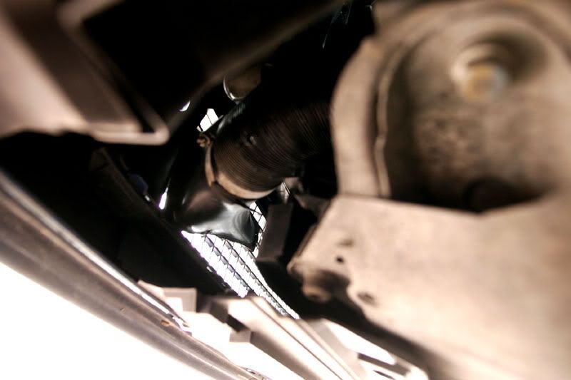

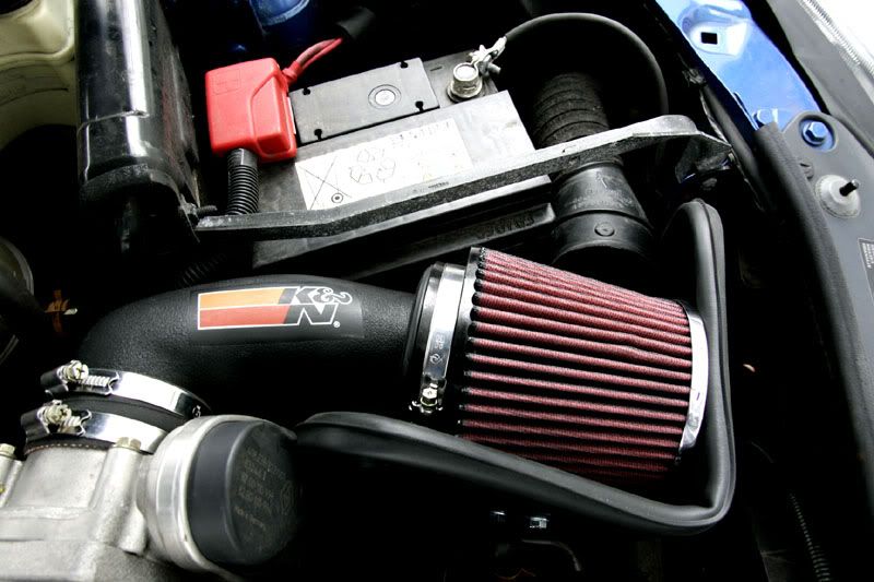

It was a bit tight, but once trimmed, fits perfectly.. and keeps the pipe nice and straight.. ish.. LOL..

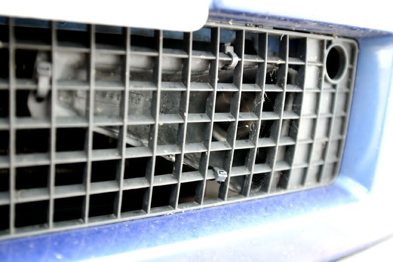

i wouldnt like to have the airscoop too low, as it could fire water straight into the engine bay if you hit a deep puddle.. thats why i didnt mount it as they suggested in the instructions..

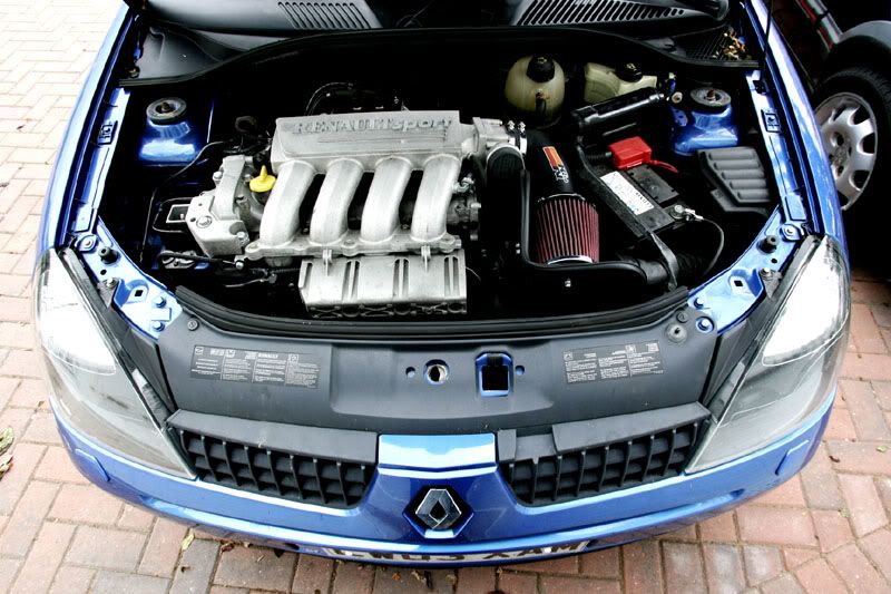

Anyone on here got photo of induction scoop and pipework? Does the scoop just fit straight over normal induction pipe. I like the sound of more air!
Just sits below the bumper on the right hand side of the lower grill.. the outlet of the scoop is the same size as the the hose, so you do need to cut the outlet, slide the cold feed pipe over the duct outlet and fasten with a jubilee clip.. the pipe then flows around the bottom of the rad and stright up to the filter,..

for an extra £10 would be worth getting the green heatshield to cover the engine side of the filter and the top of the filter even with the gen2 kit fitted, to reflect some more heat away, it shouldnt affect the induction noise either
