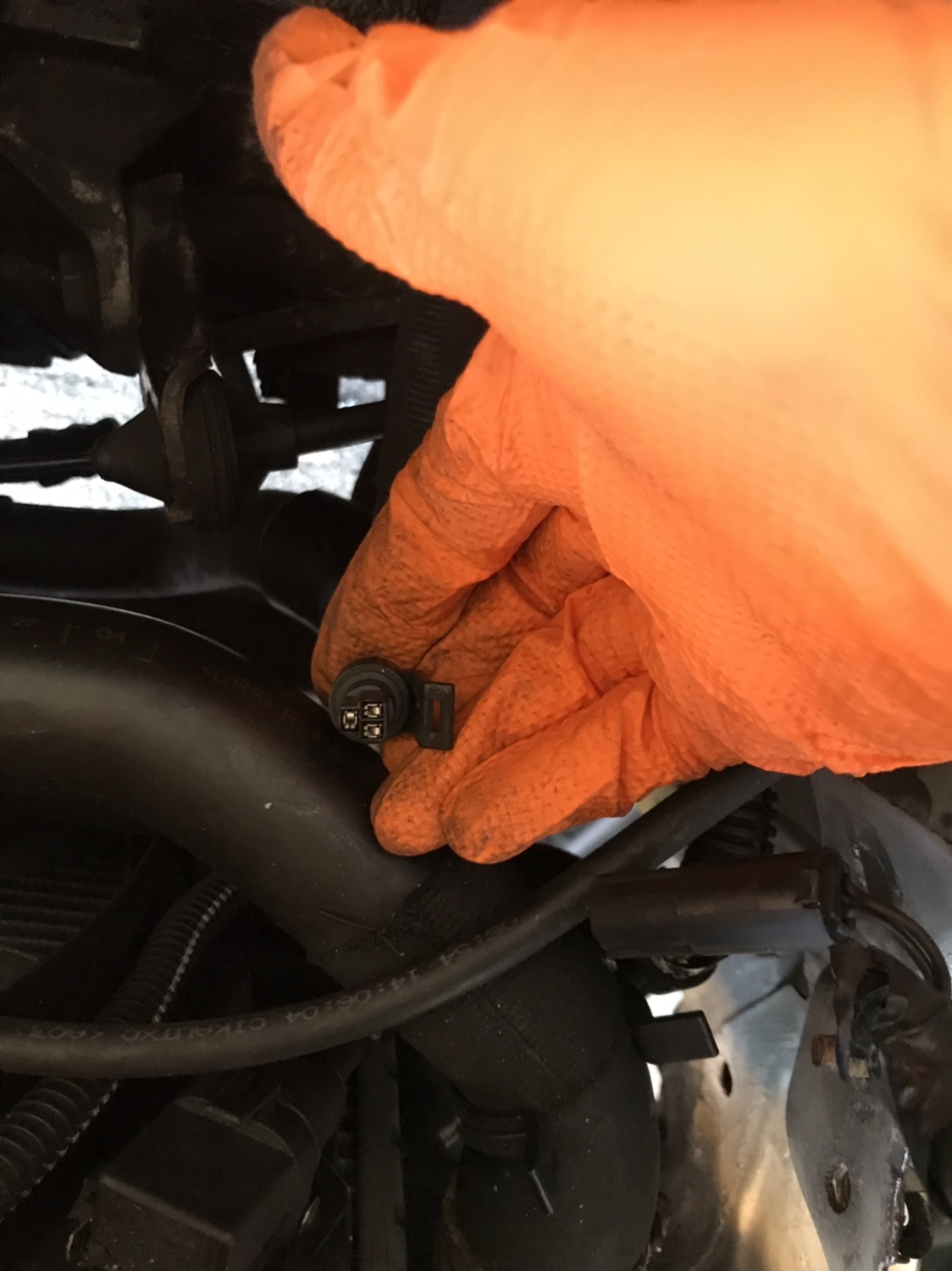

And found this sensor but couldn’t find anywhere to plug it into ? Maybe from removed ac ? It’s on the right hand of the rad as you look at it
Thanks all
Yea Aux belt just needs a tighten up dont go crazy or you could hurt your alternator. If that connector doesnt plug into the radiator fan it will be from the AC as my Cup doesnt have one of those from memory.
