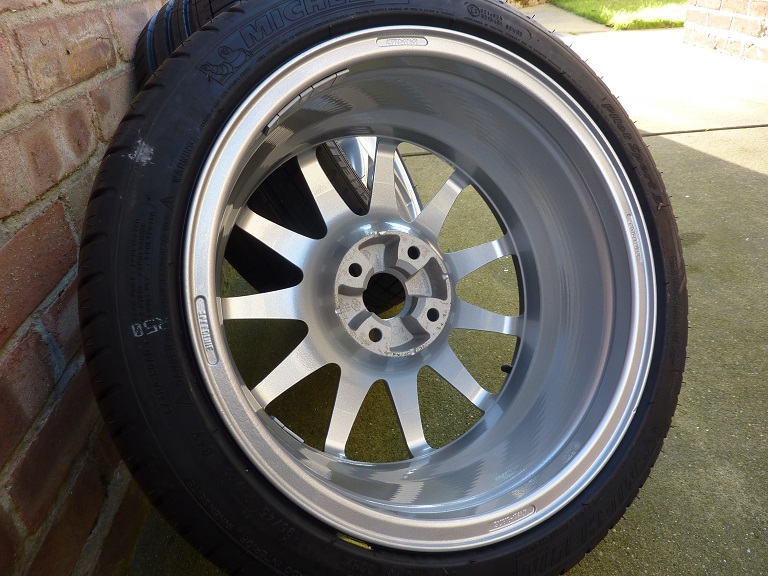

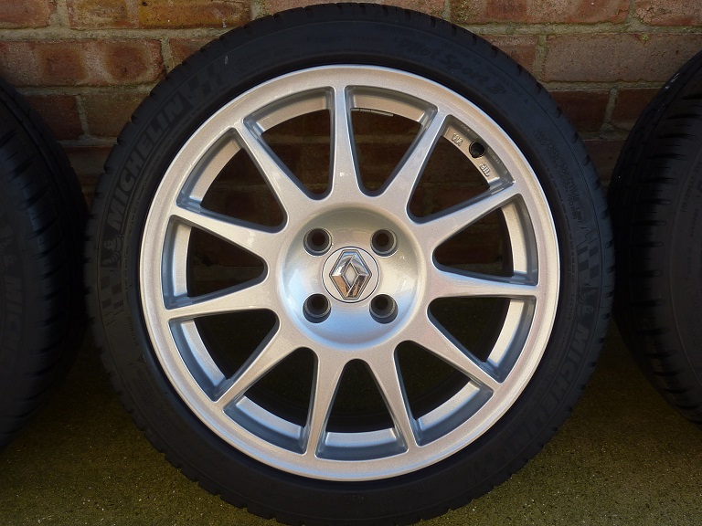

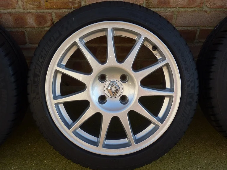

Here's some photos of the new wheels, now they are back from being re-furbed and with fresh new tyres fitted........ ready to go on the car!
I'm very pleased with how they have come out! :cool:

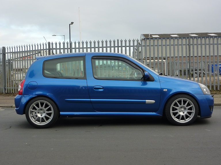

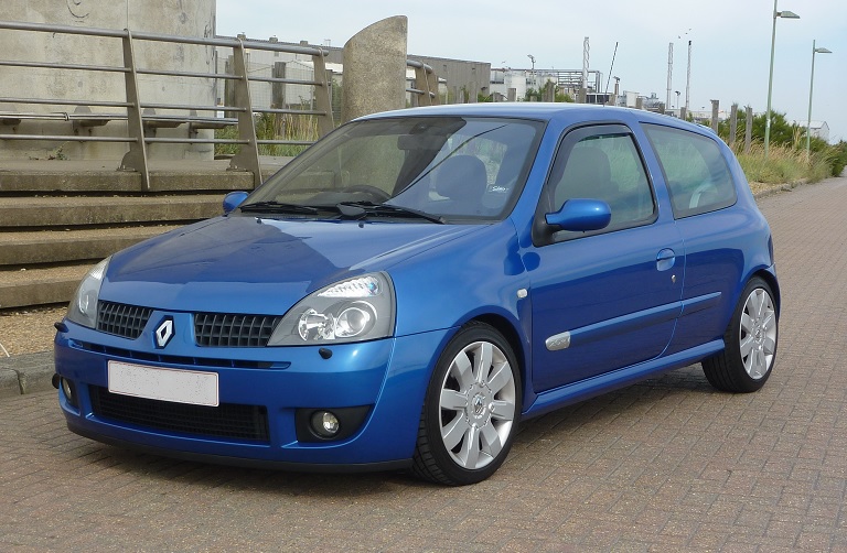

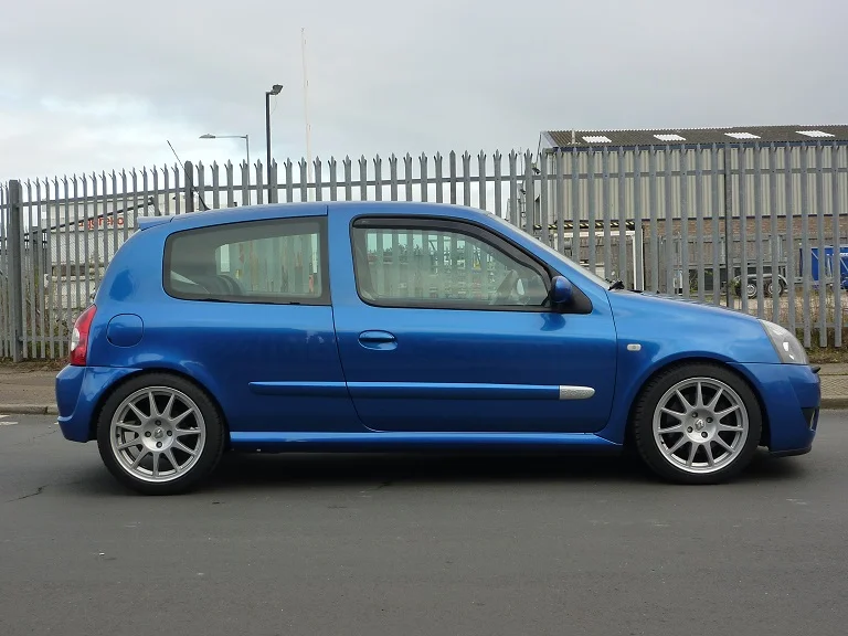

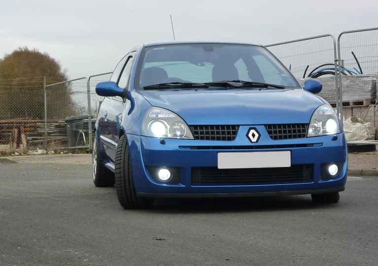

The Turini's went on this morning as planned and I even managed to get out and take some photos before it started to drizzle with rain, the photos are a bit dull as that's how the weather was, but at least I could get out :cool:
Overall, VERY happy and wheels look awesome with a capital A, BUT...............

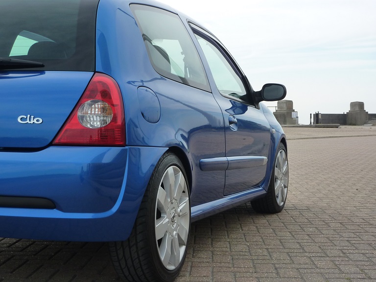

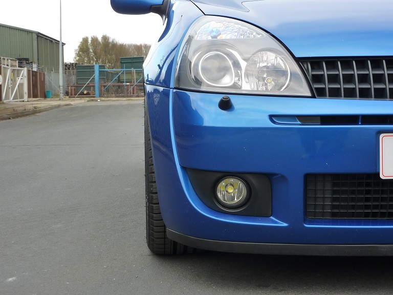

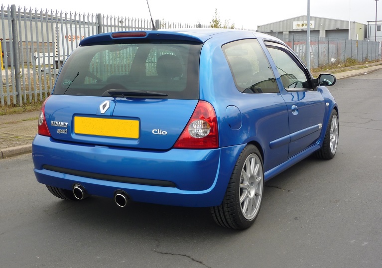

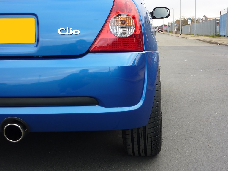

The rears are indeed too wide with the 14mm hubcentric spacers (yes 14, I keep saying they are 16mm as that's what the previous owner told me but I measured them twice when the wheels were being swopped and they are 14mm). The rear wheels rubbed somewhere reversing off my drive and also rubbed when driving, especially when I put my foot down. It's funny how it looks like the rear wheels stick out even further but I guess that's the illusion caused by the front arches being wider.
I think i'll take @Dr Jekyll 's advice and go for some 5mm on the rear but what about 10mm on the front just to bring them in a bit too? Would that work? Anyone know what size bolts i'd need if I went 5mm and 10mm and where to get the spacers and bolts?

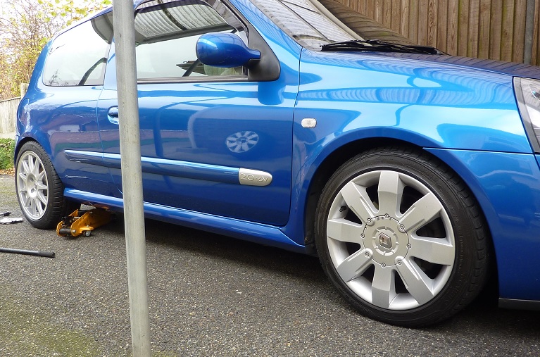

Progress photo;
....... and all on and finished;
PMS do new ones and the quality is very good. Unsure on what sizes they do though buddy.
All i know is you can use your existing wheel bolts up to 5mm then its recommended that you get longer bolts to compensate the bigger spacer, unless they are bolt to hub type as you can use your existing bolts then.
Standard is et43 and cup is et38 so 5mm wider. They do seem too wide though.
The fronts look borderline. I think you could pull it off if it was slightly lower as the arch would cover it more.
Yeah I agree, the fronts are indeed borderline and i'm 50/50 but the rears need to be sorted. I wasn't sure anyway but as soon as it rubbed, that was it........ that's why I was thinking 5mm on the rear and 10mm on the front. 4/5mm less on the front should just tuck them under a bit nicer but upto 10mm less on the rear should be a big improvement. I had to leave the spacers on though as I don't think I got the original bolts with the car, will have to check the box of standard parts, but I didn't want to put the standard wheels back on again 😂

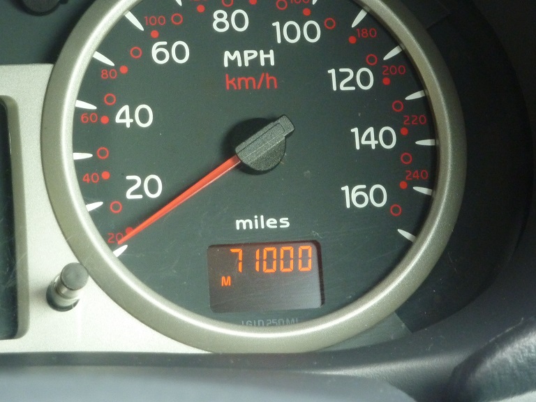

Rolled over to another 1000 miles today, first time in well over a year going by the history;

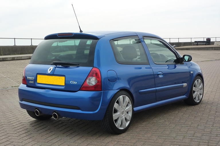

A quick look for pics of it on standard wheels (sorry [emoji38]) and the rear ones do look right on the limit of bodywork! How thick are those rear spacers?
What size spacers are on the rear
Exactly the same as the front ones as I measured them, 14mm

Agree the rears need to come in a bit but otherwise it's spot on!

Yes and no, I can hear it rubbing on the back very slightly, nothing serious but enough to make me need to sort this ASAP!
