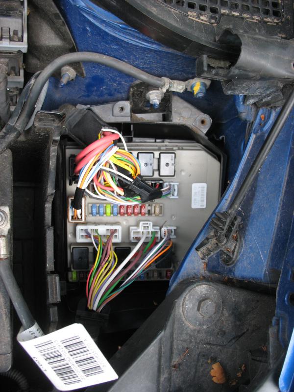

Got issue with my 197 just tryna Sus the problem, no power to the tailgate lock, button or wiper motor. ,Brake light seems to be illuminating when pressed, any common faults? I've checked the fuses at the left hand side of steering wheels and the plugs onto they bcm/uch seems okay, I've done a continuity test from the main plug which goes back to the plugs in too boot lid and all okay , so I assume it's up front somewhere... Not sure where to go from here. Is there any common areas it rubs or anything as such? Suppose to be going for MOT soon but car is in bits! 🙄🙄🙄 Thanks.
MarcB
  Too Many
There is a fuse box in the engine bay and its a c0ck to get too.
Its under the secondary air intake in the top right corner to the right of the battery.
You need to strip it all out and open it up.

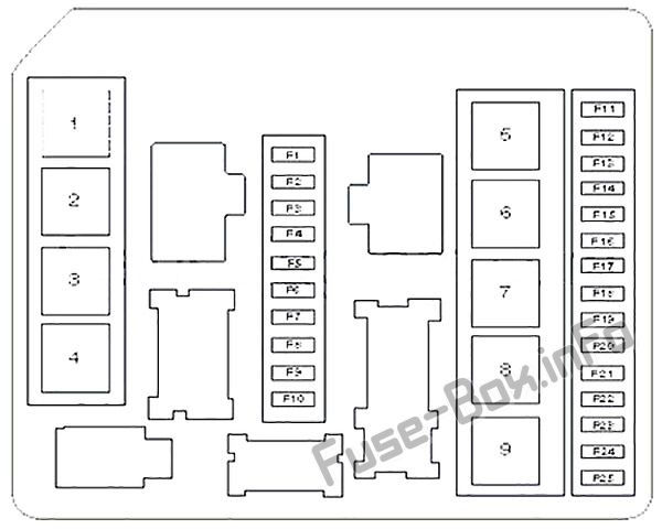

This is taken from a standard MK3 Clio NON SPORT
1Heated rear window relay
2Engine control (EC) relay- except K9K764
3Headlamp low beam relay
4Fog lamps relay
5Starter motor relay
6
7Engine coolant blower motor relay, high-speed 1
8Engine coolant blower motor relay, lowspeed2
9Ignition main circuits relay2
F125AABS control module
F2
F310AHeadlamp high beam, right
F410AHeadlamp high beam, left
F510AAC control module, central locking, cruise control selector switch, electric window motor, rear right, ABS/ESP system, multifunction display, RH side lamps, RH tail lamps
F610AAudio unit, central locking, cigarette lighter, door mirror adjustment switch, electric window dual switch, driver's door, electric window motor, rear left, electric window switch, passenger door, headlamp adjustment control module, licence plate lamp, parking aid, LH side lamps, LH tail lamps, traction control system (TCS)
F715 AAuxiliary heater relay 1/2, cruise control reversing switch, data link connector (DLC), electric power steering, gas discharge headlamps control module, multifunction control module, transmission mode selection switch, transmission selectorlamp, tyre pressure monitor control module
F820AWindscreen wiper motor
F915AHeadlamp adjustment motor, right, headlamp low beam, right
F1015AHeadlamp adjustment motor, left, headlamp low beam, left
F1110AAC compressor clutch
F12
F1325AStarter motor solenoid
F1420 ATransmission control module (TCM)
F15
F1615AHeated rear window
F1715AHeadlamp washer pump relay
F185 ATransmission control module (TCM)
F19
F2010AReversing lamps
F2120AIgnition coils
F2220 AEngine control module(ECM)
F2310 ASupplementary restraint system (SRS) control module
F2410 AEngine control module(ECM), steering column lock solenoid – with keyless entry system
F2520AFront fog lamps
SKINTasPER
  Clio 182/MK4 GT 120
How typical! It's fixed now took the cowling off from around the steering wheel turns out there's more fuses than you can get to!!!
