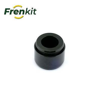

These are the pistons you need mate.
Same seller also do the seal kit, 4023 are the ones you want for that.
And then HEL stainless M10x1.0 bleed nipples.

Thanks for the link James.
What's the quality of these like mate? I had seen them advertised but was unsure! Don't want to skimp on anything.
Mr Trailer Man
Fine mate, probably better than standard because the OEM ones are plated metal, these are anodised aluminium.
I've built a set with these and also ones for a mate.
They slightly shorter in height than OEM but it's negligible.
