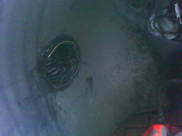

Feed in the arch!!! I know, I know its facing rearwards!!!! BUT.....
The arch is a high pressure zone so plenty of turbulent cold air as confirmed by the box being nice n cold after a good run!!!

I would be seriously worried about that sucking up water!! Moisture etc.

Good point with wheels throwing some crap up?

Function over fashion.....
spray will be going the other way surely? unless he is driving in reverse...
You can get the Carbon box as he said elsewhere, but the ally is as good and costs £100 less.

Is it though...What makes the Maxogen a great design is it's route to cold airspace, granted they've done the best they can with the 197 space and relocated TB....But i can't see it being much more efficient that a stock carbon box filter with a feed...
Ah well...Just my thoughts. I'd be more concerned with the feed tbh!
lol! On a saturated road!?!
Yeah, you're right... that side will be perfectly dry! ;)
I'm still not convinced
Sorry of cause the front bumper would be better, you wont get rain or spray there at all will you? and it wont act like a scoop if you hit a deeper than expected puddle either will it? :rolleyes:
At least as its facing backwards its less likely to 'scoop' water up

TBH I couldnt care less what it looks like, they were all out of gucci airboxes last I looked!!
Feed wise, yeah It could be an issue, but the bend in the pipe should stop this!
I think the spray issue would be just as bad as a front bumper (foglamp) mount though surely?
Reference it not being much better than STD, I would hope it is, but I guess we'll see!! It runs cooler and has more capacity and more direct feed, also, the std grilled feed on the 197 is shocking, the the black pipe off and undo the trim clips, the box it draws air from doesnt even feed to the grille???
