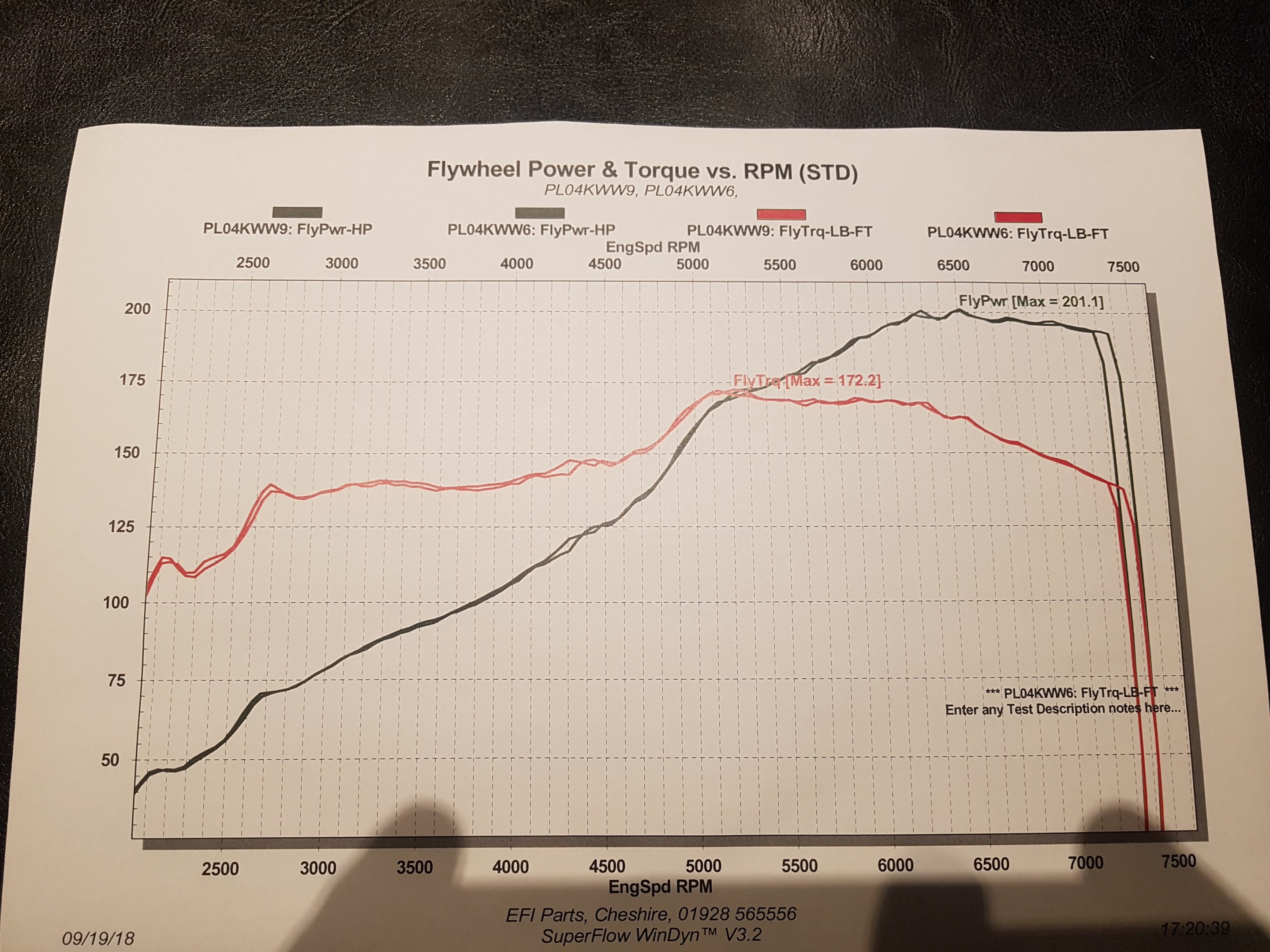

His car is running and has already done one trackday.
This is niall's graph.
Will be having a play with exhaust cam timing on it at some point as we reckon we can get a bit more out of it.
