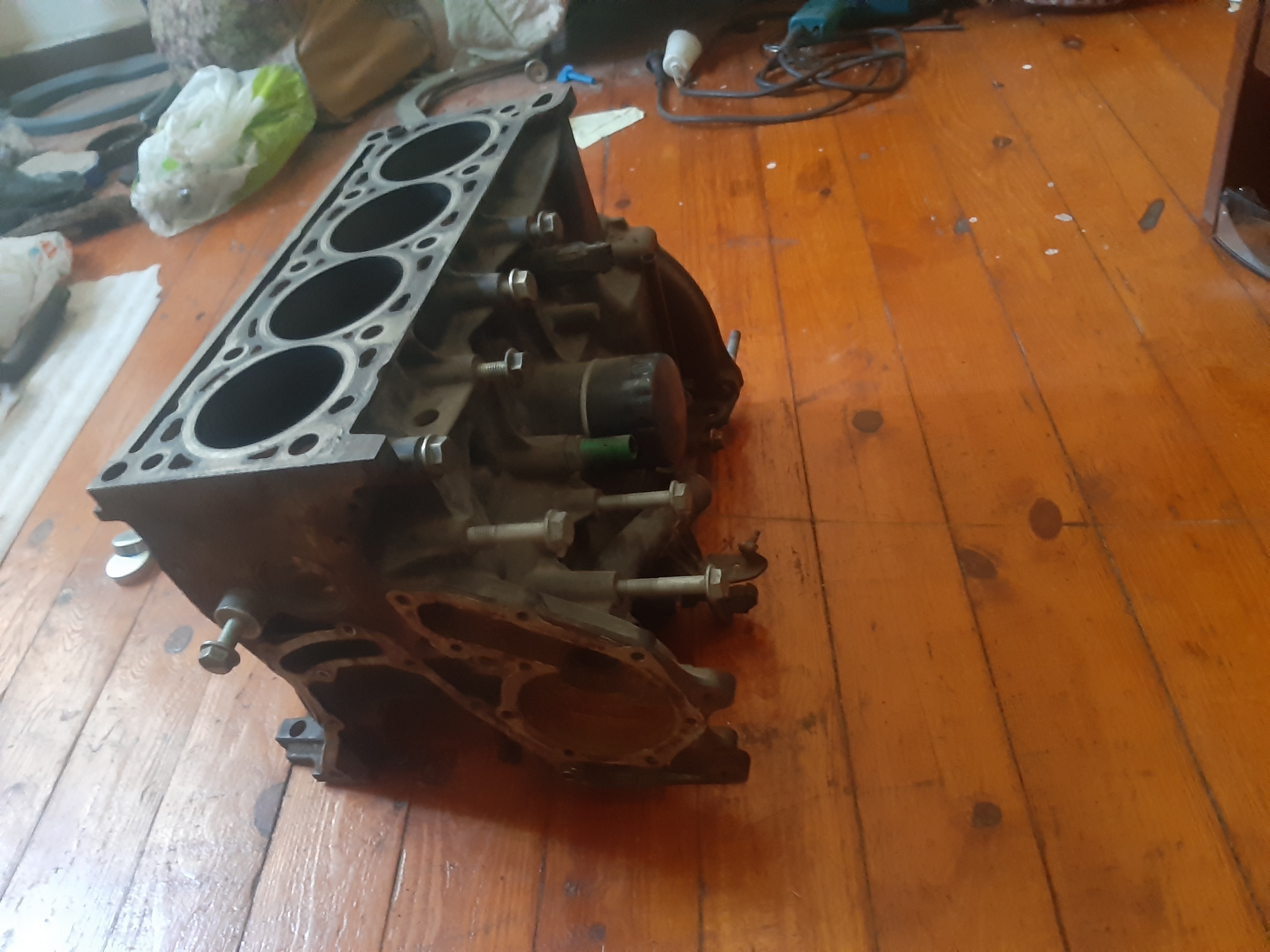

Now I fitting f4p 760 lower block which is with 83mm crank and 149.30 mm rod the block is same as f4r block added 197 standard pistons and f4r 740 head with cams the cr on a f4p was 9.8:1 standard same on f4r 740 now a changes is the 197 pistons with 11.5:1 cr I dont know how much a dome volume for a pistons but I calculated it nearly will go around 11:1 cr
Now I have some questions, is there any cylinder offset will changes ?? and do someone know the 197 pistons dome volume ? Do I ll need to custom timing degree cams ??
