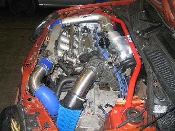

Complete conversion kit for £1500 + vat ( everything you need + a lot more tackle you dont realise you need )
do i get that off you? could you possible make a list for me? that would be awesome. ill have the money for everything around the 12th may :D i cannot wait
You get...
Engine
Gearbox
manifold
sub frame
wiring loom
driveshafts
radiator
plip key
ECU
UCH
ring decoder
immobiliser code
front discs
front calipers
wishbones
anti roll bar
Inst panel
count me in for one in may :D
is it a strait forward swap for swap or would i need a garage for a few things ?
then all i will need is coilovers and 2118's in white and then my car is how i would like it
There easy to do as the engine bays are identical. Its possible to do one on your driveway but you will need an engine crane / ramps. Dont be put off doing it by critics.

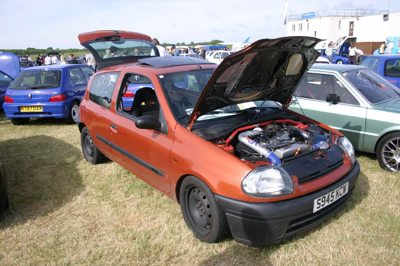

Im in the business of doing the conversion aswell bud. Already been in contact with K-tec about doing it !! Certainly not a waste of money in my eyes, considering i paid £5000 for the car and spent around £1,500 on it already. I dont want to get about £3000 for the car by selling it & then have to splash out even more for a sport & then have to start modding it all over again. The whole sleeper affect is cool aswell. Lots of people thinking theyre just going to blow me away cause im in a 1.2, then i put the foot down.

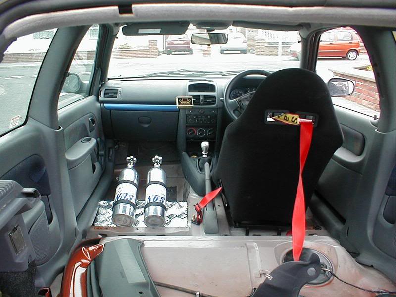

My m8 had a 1.6ztec with 75 shot of NOS
Was priceless when you over take some BMW or Audi on a duel as they always put there foot down to stop you overtaking them, finger on the spray as you wheel spin at 60 and fly past.
