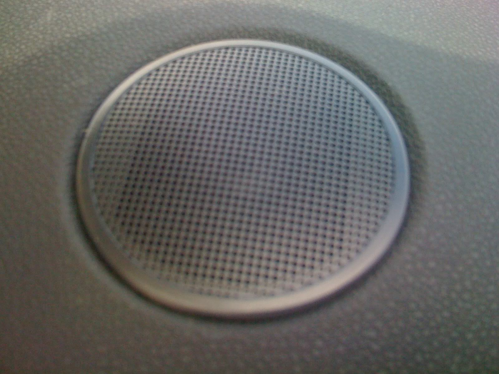

im also a bit confused, as i thought the tweeters where standard?
  Nissan 350z
Tweeters are only present if you spec'd the upgraded Headunit to my knowledge (the bluetooth handsfree one).
  Clio 200 Cup packed
that would make sense.
but the brochure says 4 speaker / 2 tweeters as standard (i guess they could have changed it though)
just hoping the wirings there really, (if i can get the damn grills off)

just managed to get the tweeter grills off, i have wires and DUMMY tweeters.
so im gonna a some Pioneer TS-Q131C unless somebody can talk me out of it?
i know it wont be a massive upgrade but its a start.

They've arrived and I've just attempted to fit the tweeters.
Perfect fit my arse
Put the tweeters in the grills and the bAck in the dash but can't make the damn things stay down and they certainly ain't twisting.
There appears to be a metal bar/plate preventing them I think.
Anybody any ideas?
Cheers

Just got the same speakers for my 2011 clio 200 (full fat spec) and there are no OEM tweeter - just blank tweeter mouldings with no workings.
I can't see any wires for them either - I removed the glove box and couldn't see any wire for the tweeter so did they change the harness on the 200 or where would the wires be?
can anyone confirm if/when Renault stopped fitting tweeters and the wiring required.
