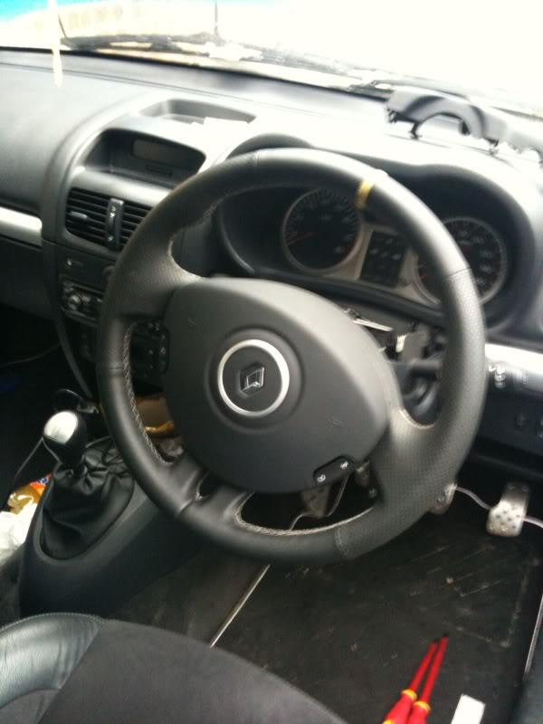

Got a pic of it fitted, airbag light went out but doesn't guarantee it works!
Will get another pic showing the rear of the wheel next to a 1*2 wheel. Like Jamie said it might need some cutting to fit!

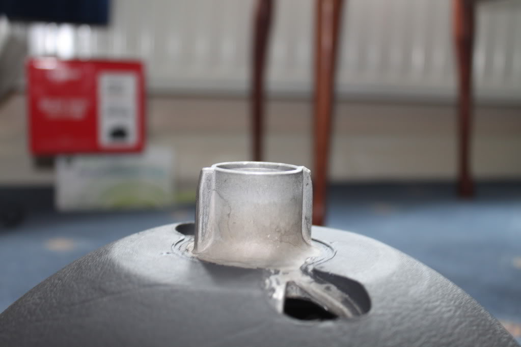

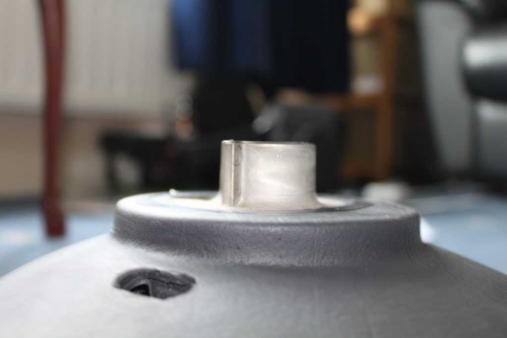

The reason it wont fit is what Jamie was getting at I think.
Both wheels can be seen below:
200
182
As you can see, where the 200 wheel attaches to the steering column it is significantly longer than the old wheel. This is what is catching on the inside of the column (I can see marks where it has worn into it). This excess serves no purpose on my car as there are no splines in the last half inch or so and I presume is used purely to locate it onto a 200. The best thing seems to be to cut this down bit by bit until it stops catching and take it from there.

Its a bit thick for that lol, uncles got proper metal working tools so he'll get it cut down for me.
No rush for it now though, just glad all the electrics appear to be working and that i know what the problem is.
When it is fitted and working correctly i'll get a little guide up showing what you have to cut/how the cruise wires work etc.
