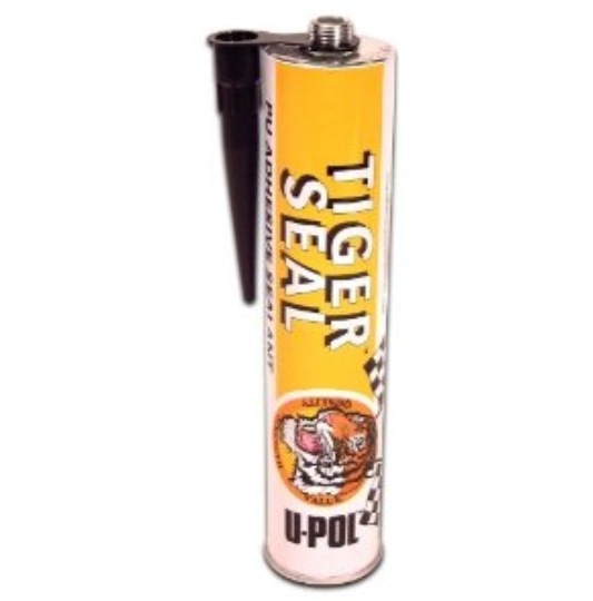

You can buy the Foam seal which goes around the whole circumference of the frame . renault Wolverhampton can price it up I think £40, I would change this bit before sealing it , and the best sealer is tiger sealer apparently it's not acidic like others .
I have done it twice now and never had an issue since .
