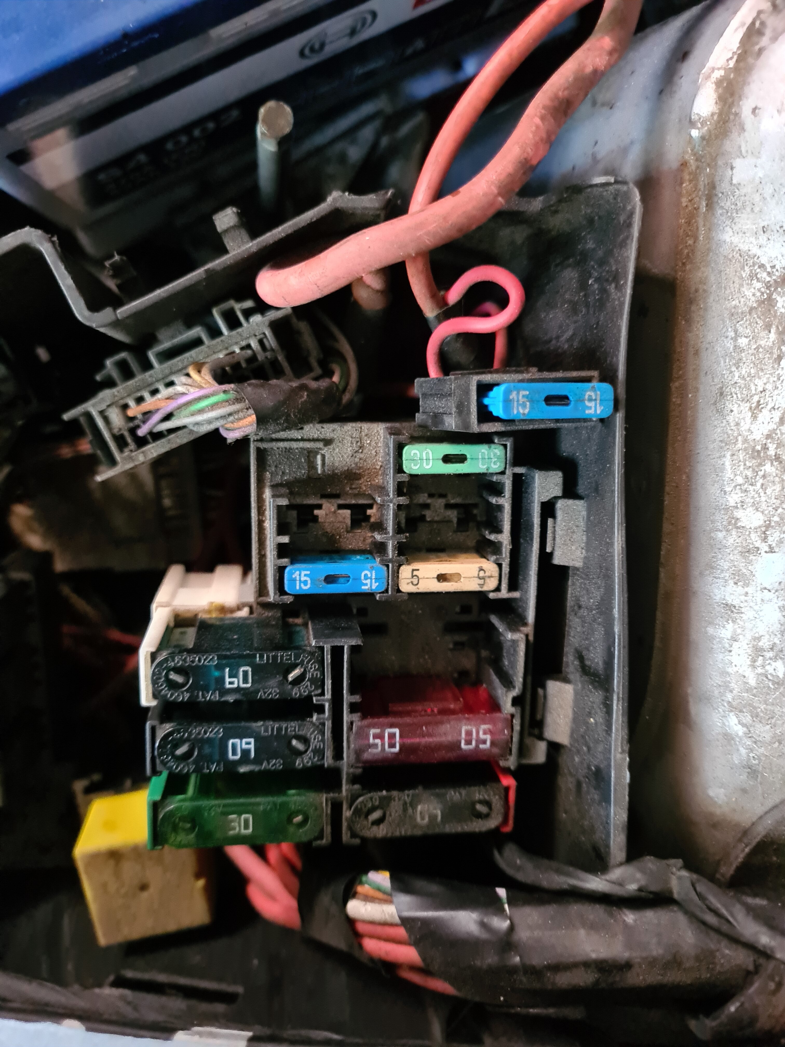

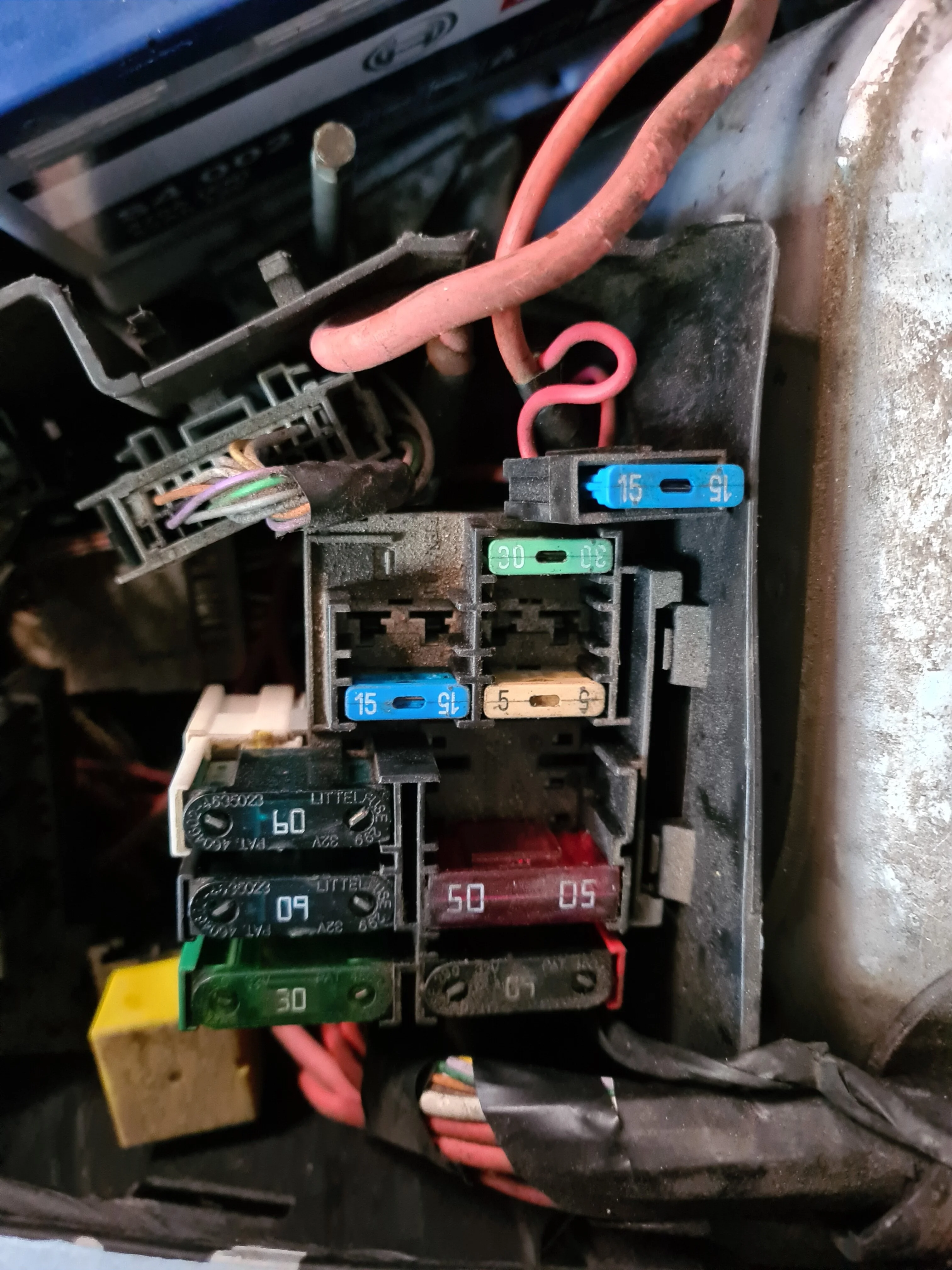

Does sound like immobiliser issues if the red immob light is not going off when ignition is turned on. Have you disturbed anything in the fusebox under the bonnet?
Possible, the fux box cover is off, i can take a look tomorrow god i hope its that simple, cheers mate again fingers crossed.
Anything in particular to keep an eye out for?
After checking again today I couldn't see any fuses out of place but there were a few gaps, I'll attach a picture to see if you can see any issues but I checked they were all in ok.
Also I noted that when I turn the ignition on the immobiliser light goes out so not sure its that either. Seems its still pointing towards the TDC as the problem.

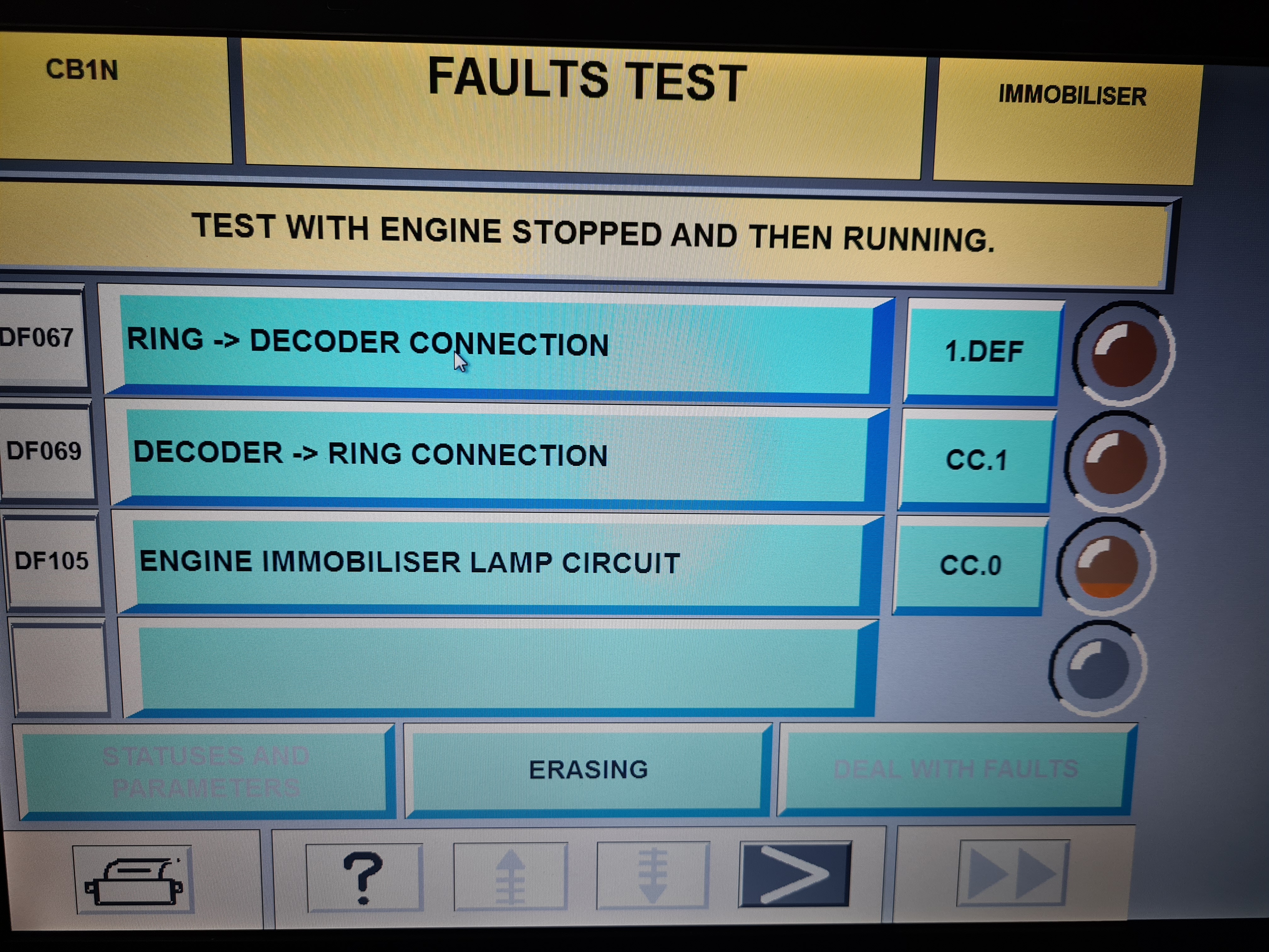

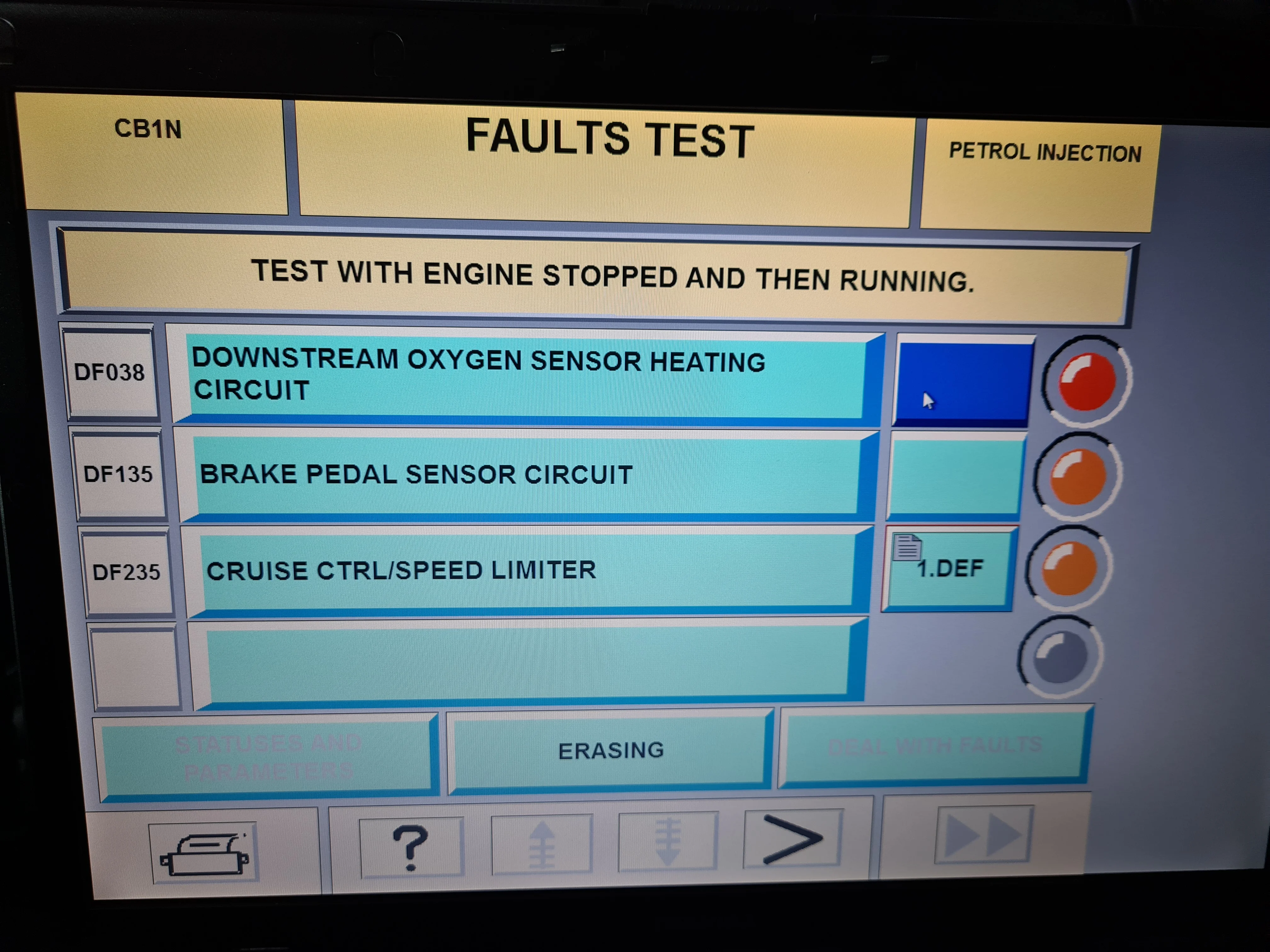

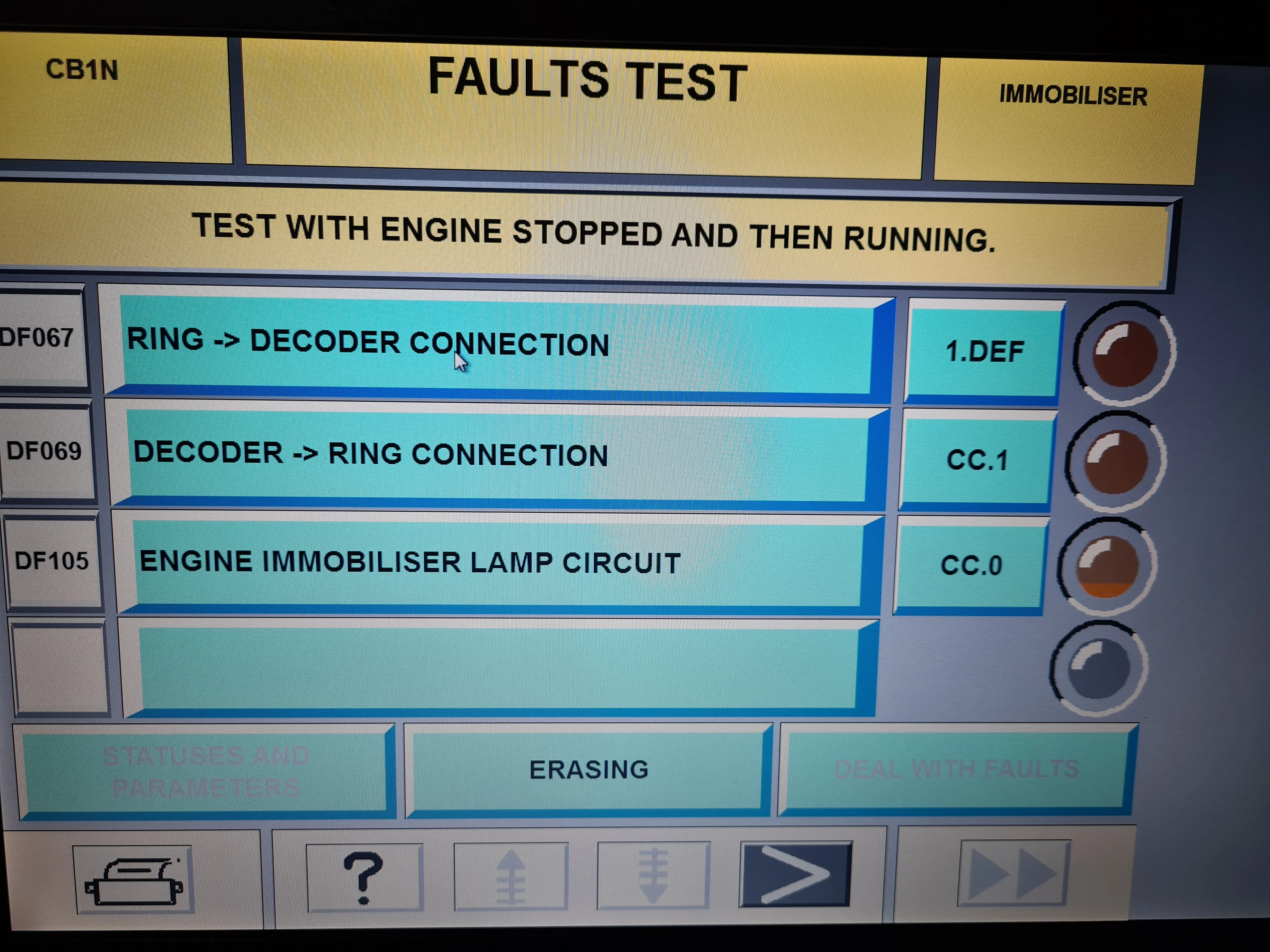

Update:

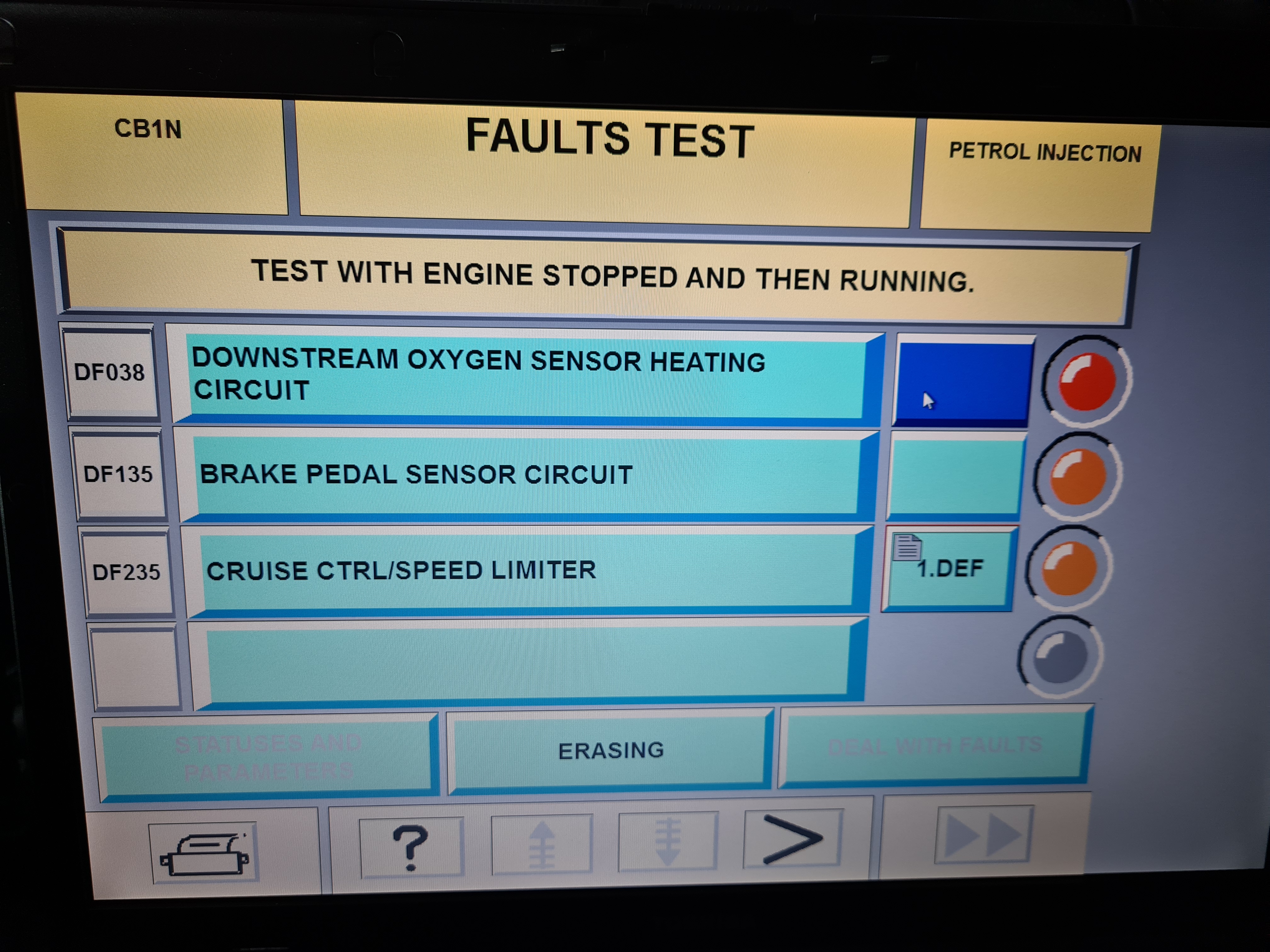

I have got my clip to work and below errors were showing, this still most likely points towards the TDC although I don't understand why removing and cleaning would brake it but either way I have a replacement sensor on the way so I can see of it helps.
Any help, advice would be appreciated.

Tdc wiring plug is possibly damaged from removing it. Check for rpm on live data when cranking the engine on the starter, if no rpm showing renew the sensor and the plug for the later one.

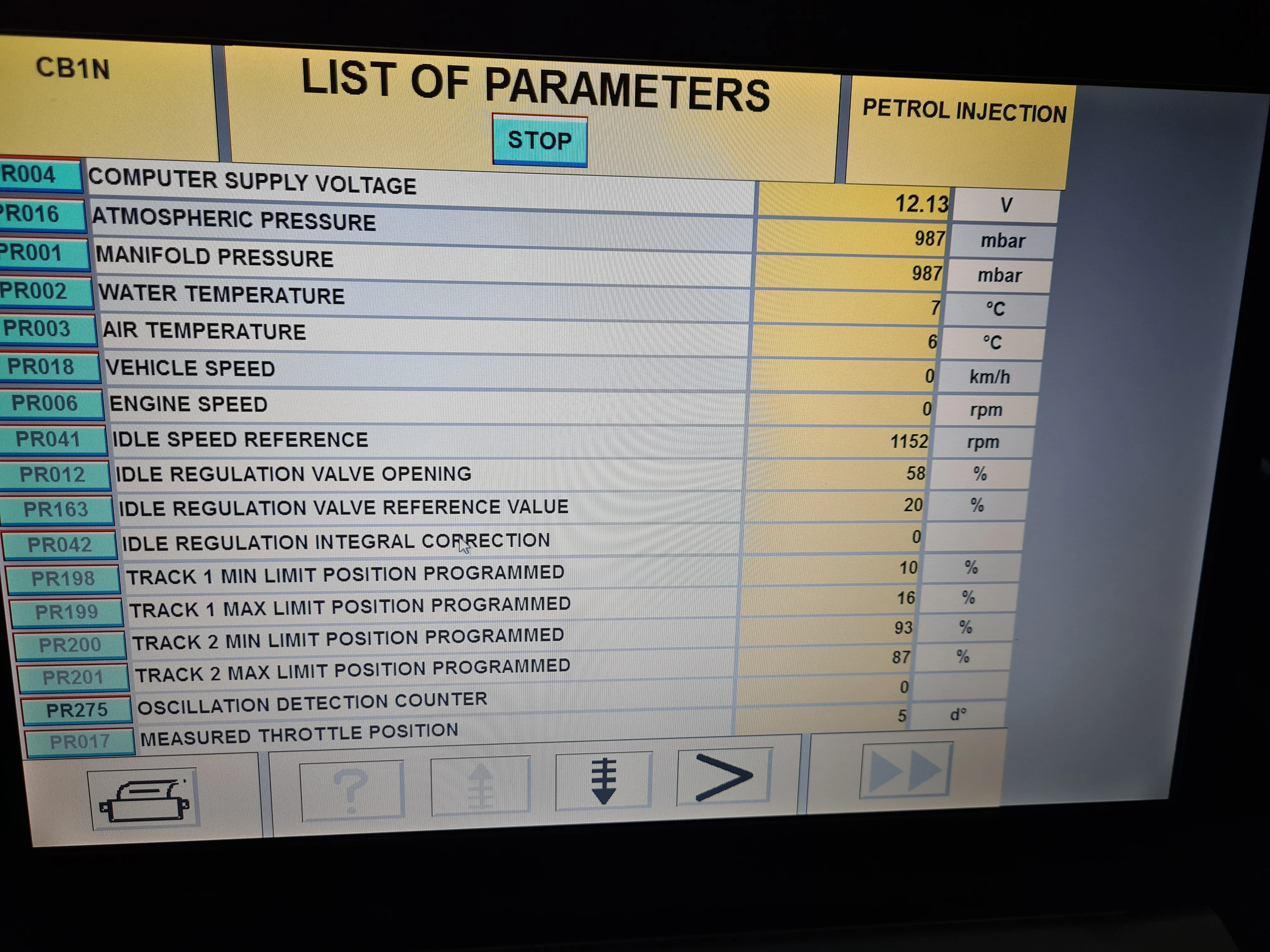

Apologies for the ignorance but just a pleb in his garage here, what do you mean by the above? Do you mean with CLIP attached try and crank? And where do I see the live data in clip? I didn't see this when looking through the UI.

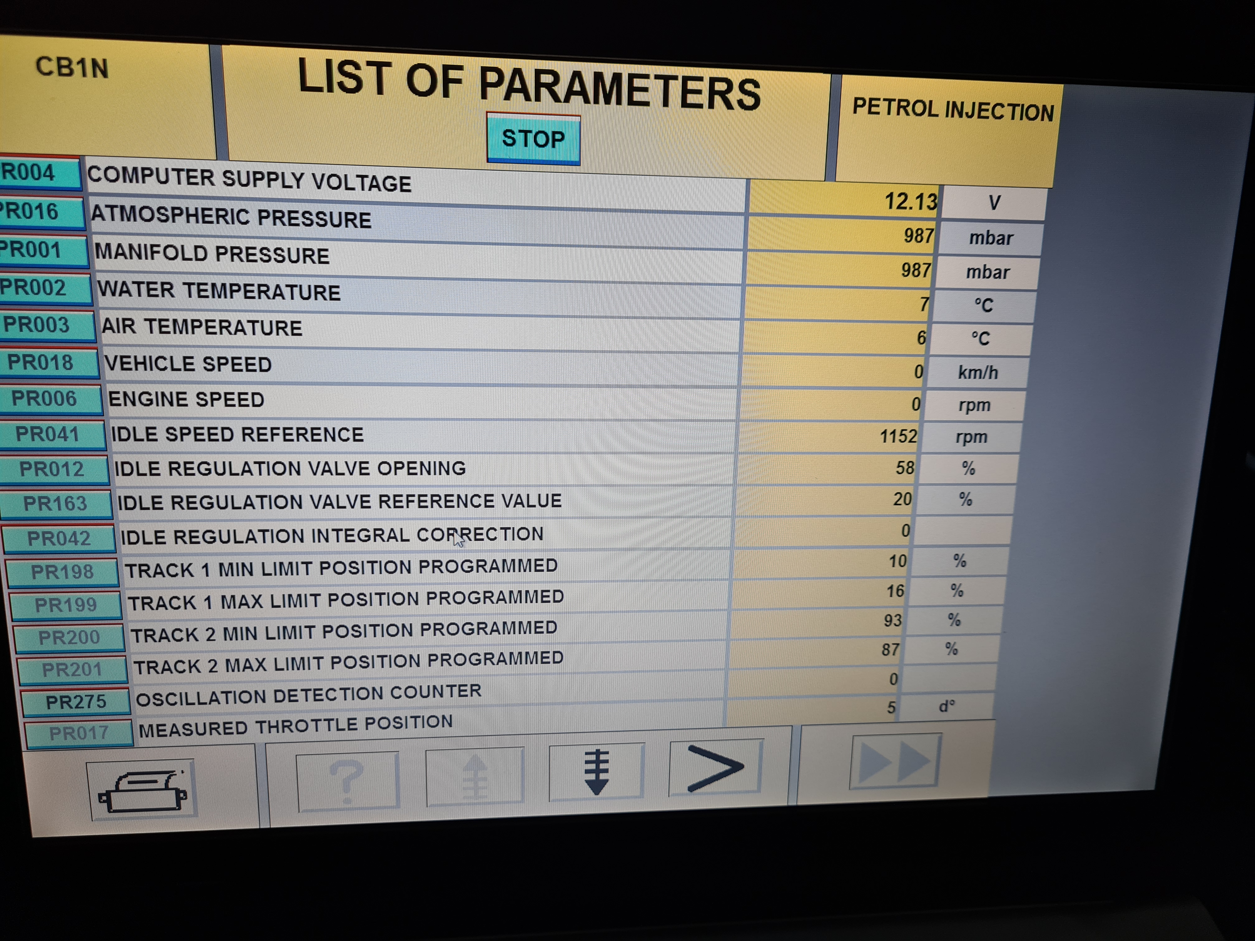

Yes with clip on, get the engine parameters screen up, and crank the engine whilst watching the rpm parameter
Ok cheers ill give this a go tomorrow. What will it mean if there are no revs? I'm pretty sure there are none registering on the dials.
Ok done the test and nothing at all, I can see the voltage supply to the computer fluctuates but nothing for rpm whilst cranking see image below.
Does this mean it's definitely a tdc issue? Also I only have a new sensor on the way not the connector but I'll try speak to someone and get the part tomorrow

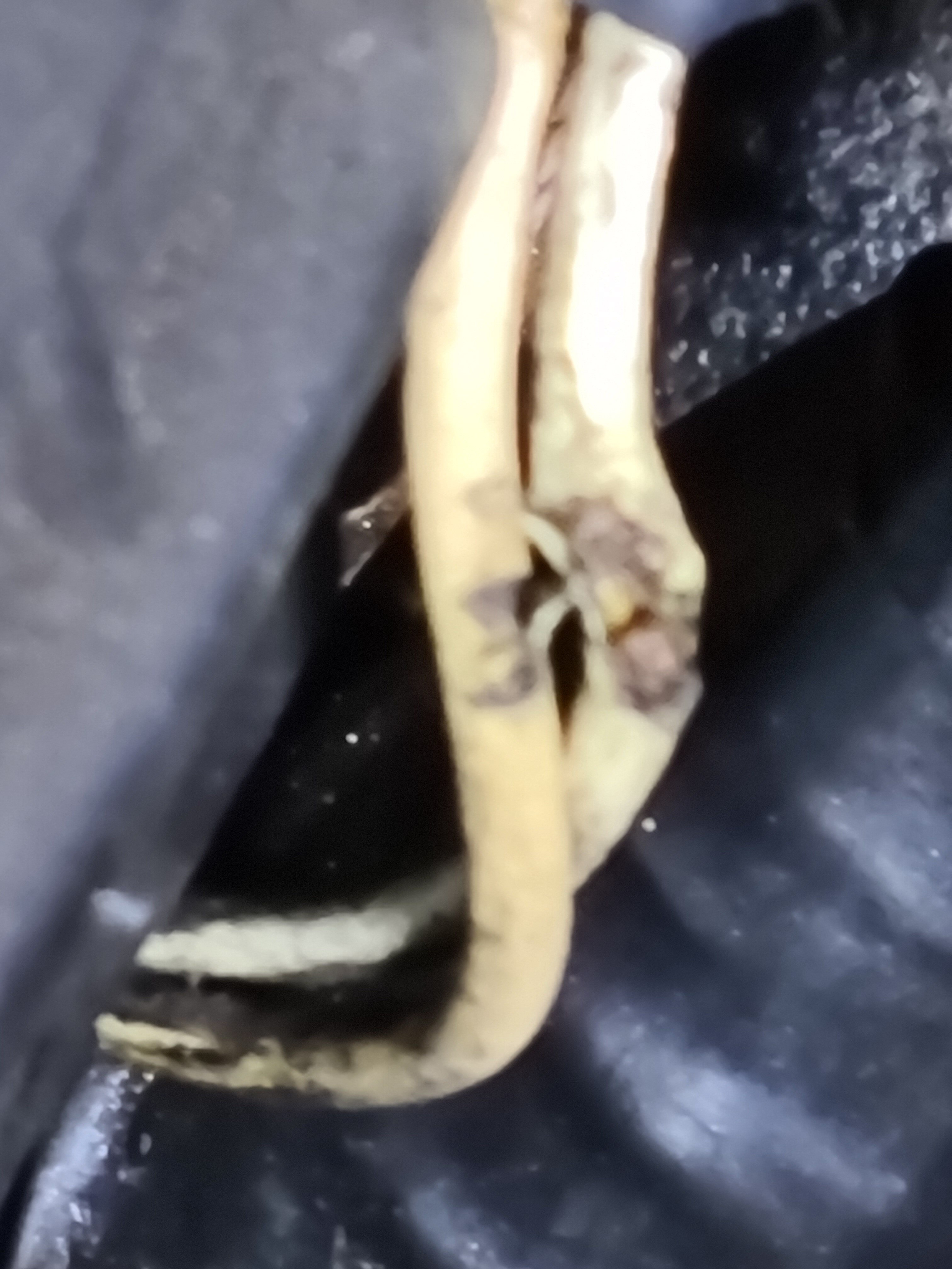

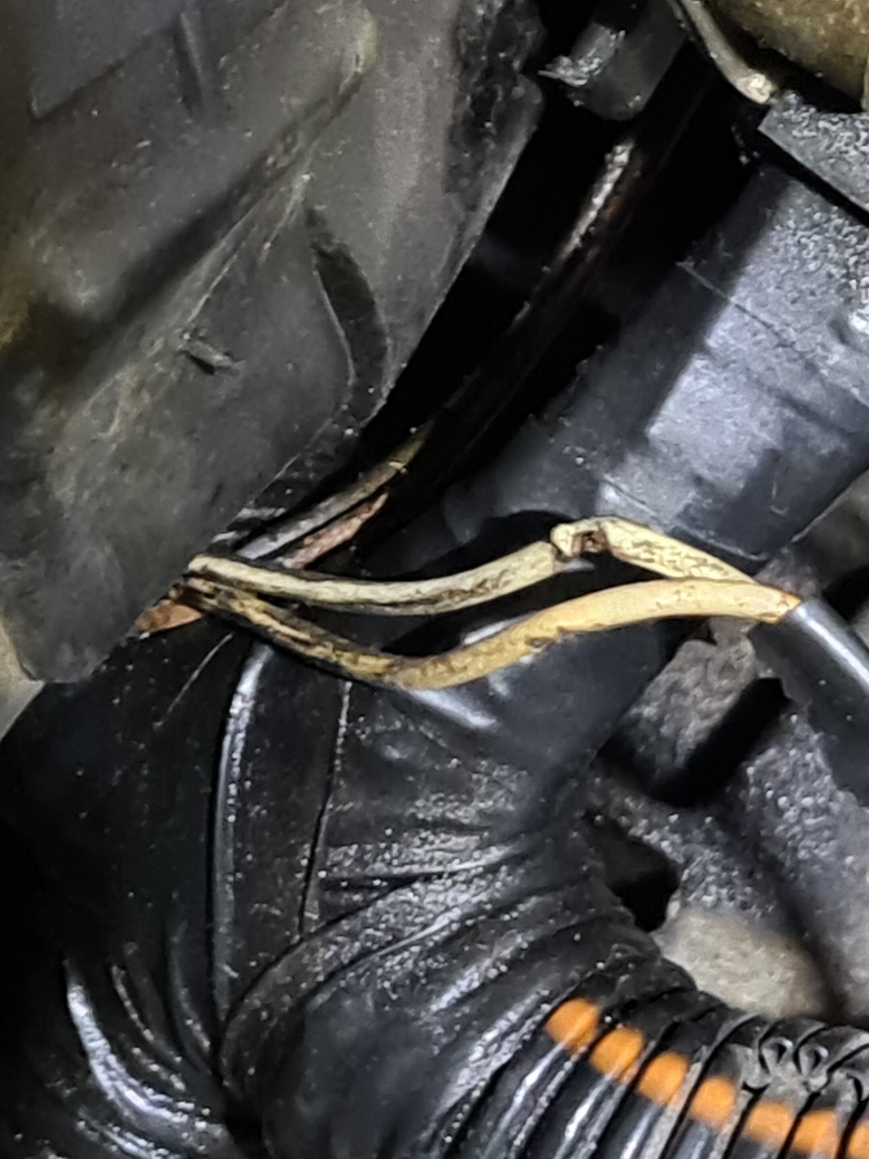

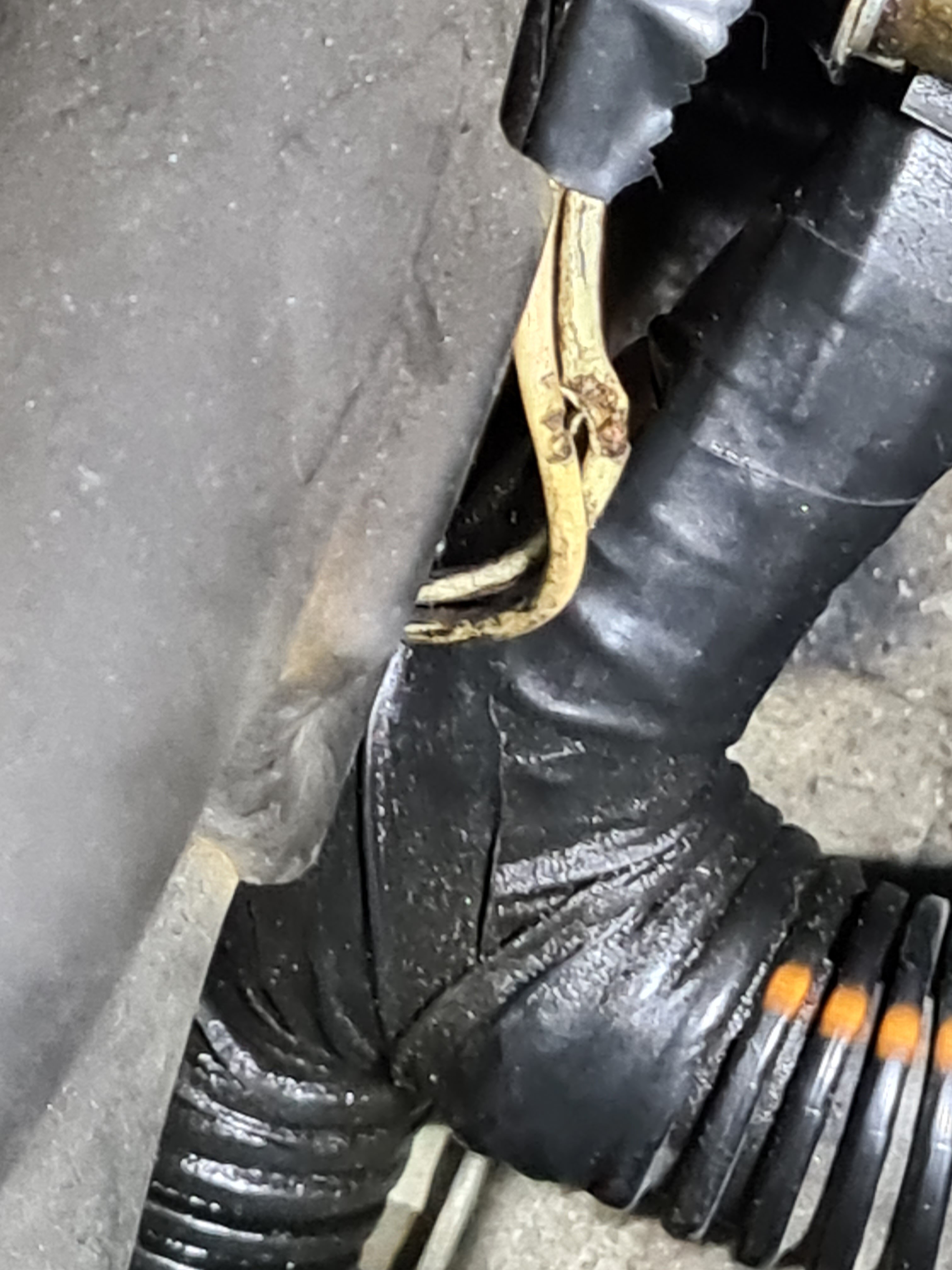

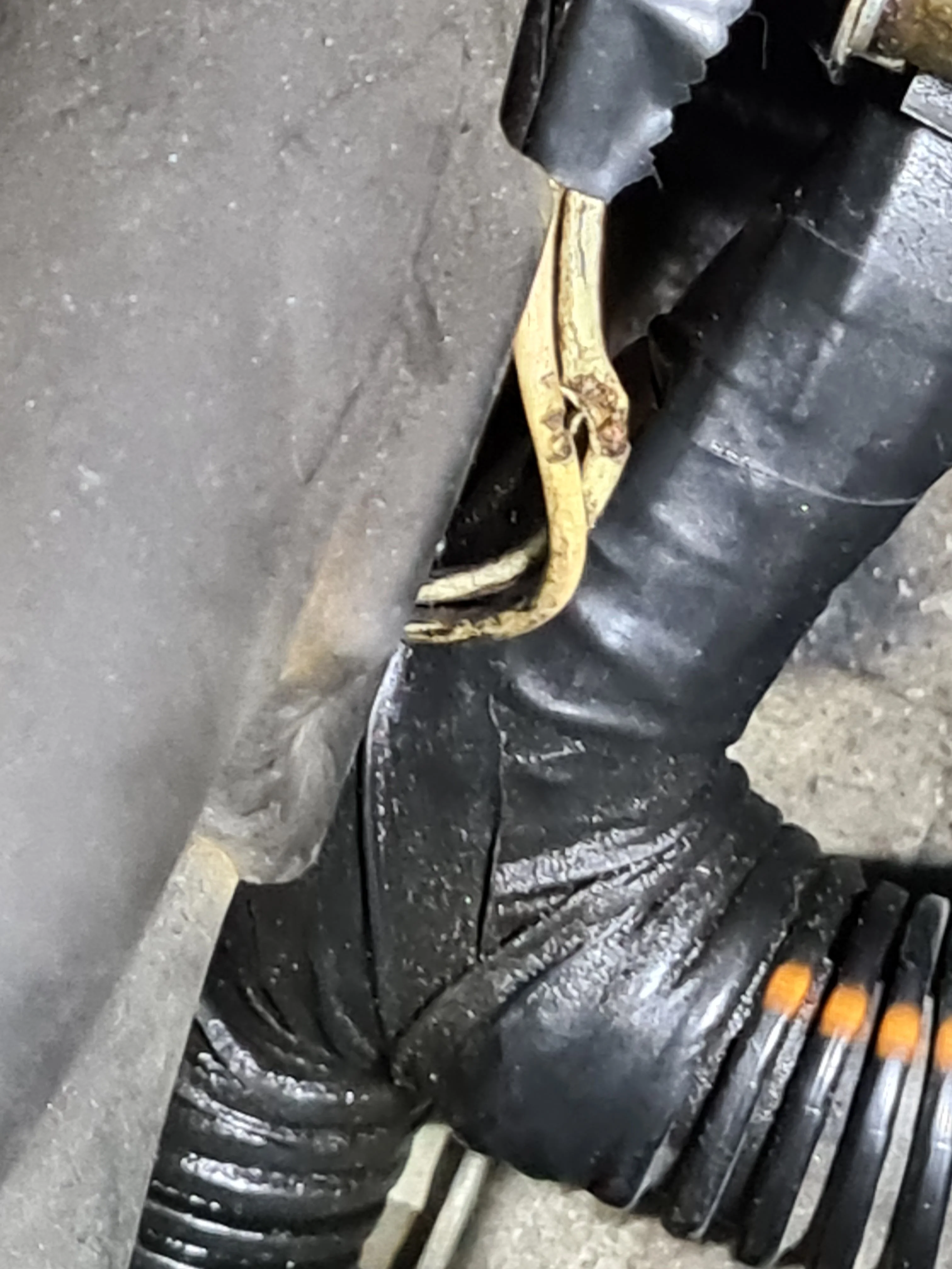

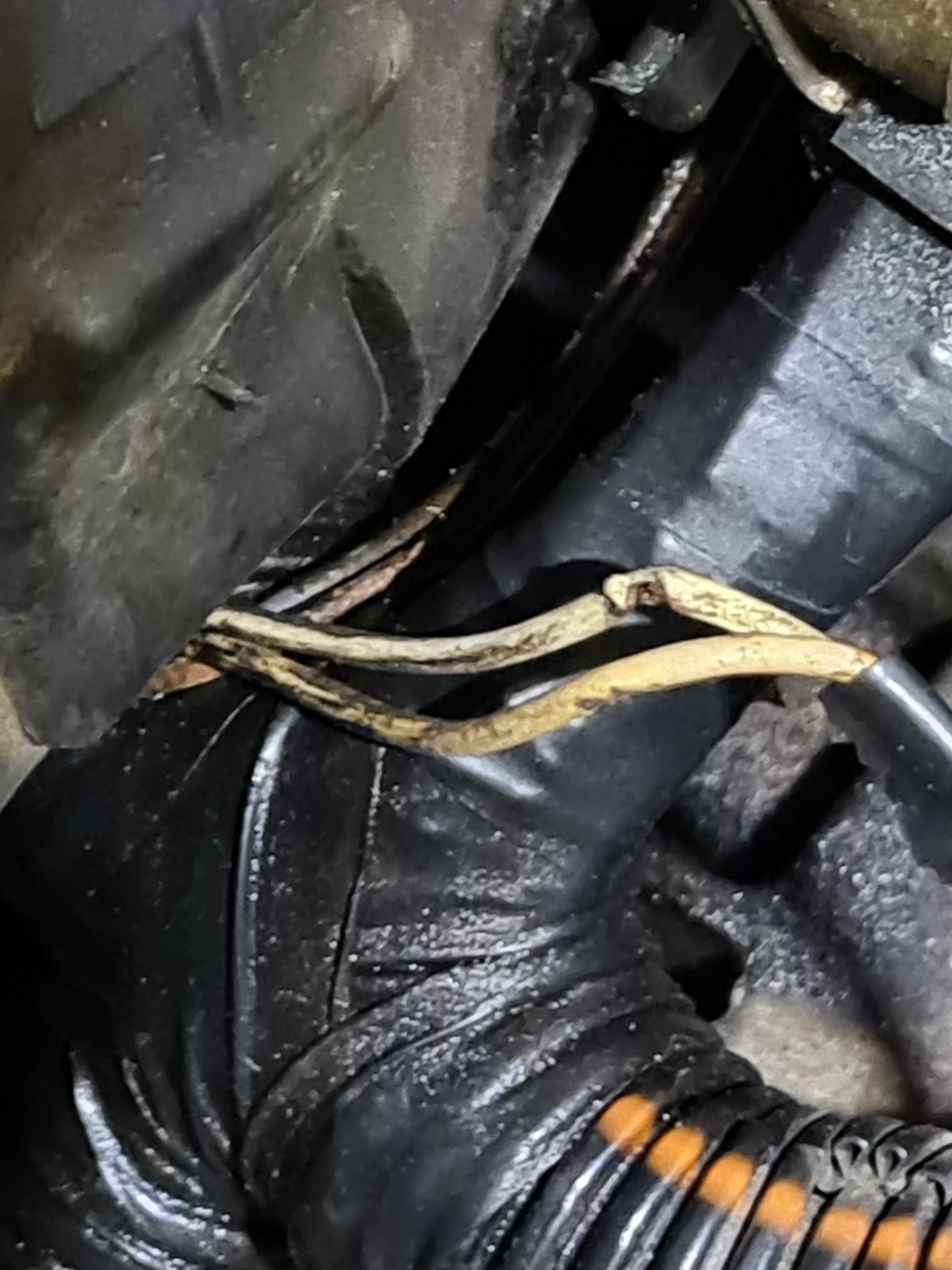

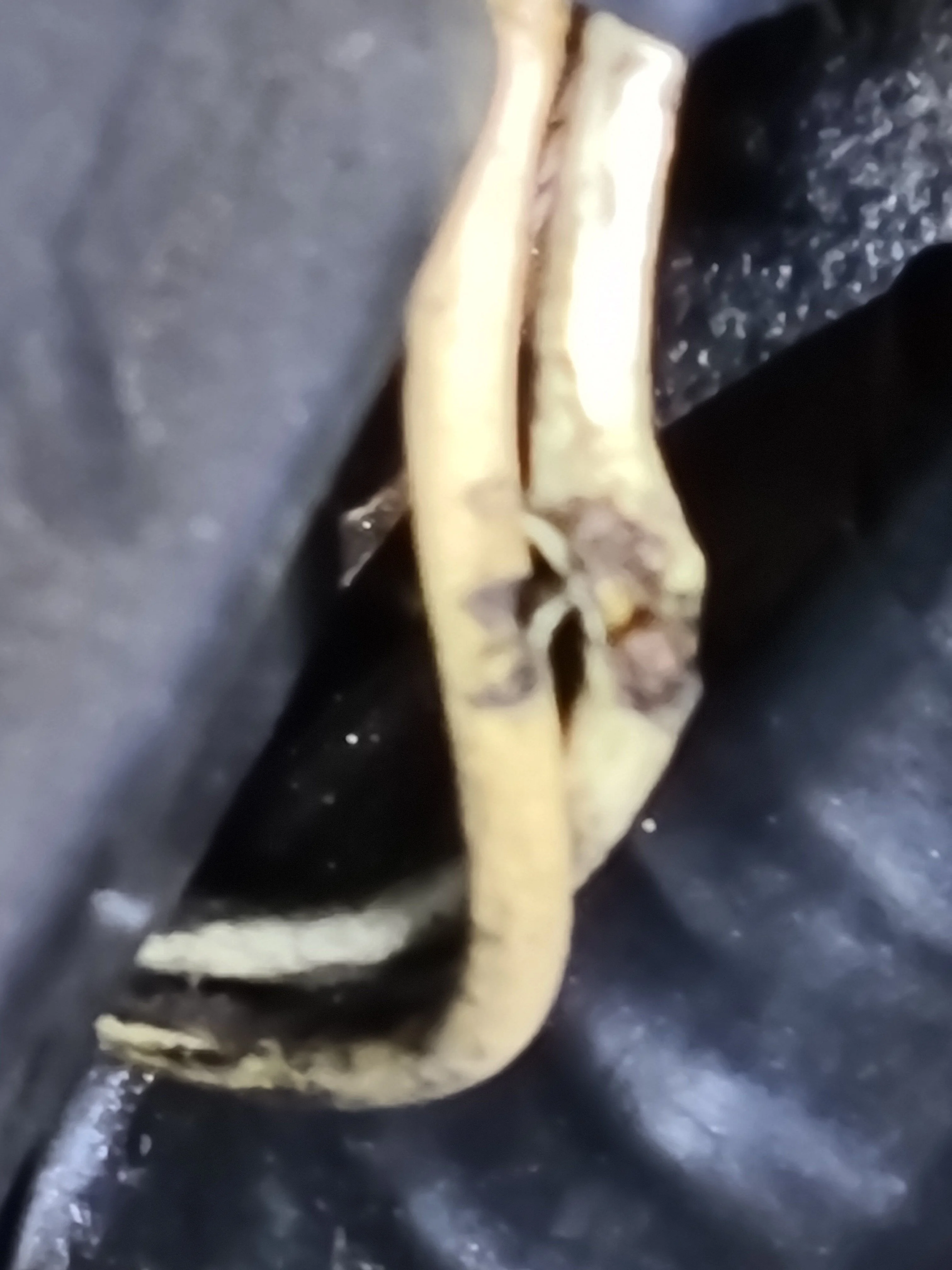

After closer inspection of the loom.at the back I think I've found the issue, seems to be a nic in the wires. See images.
Quick question when resoldering the new part how do you know which wire is which?

Indeed!! So I fitted the new blue connector and sensor and the car starts!!
