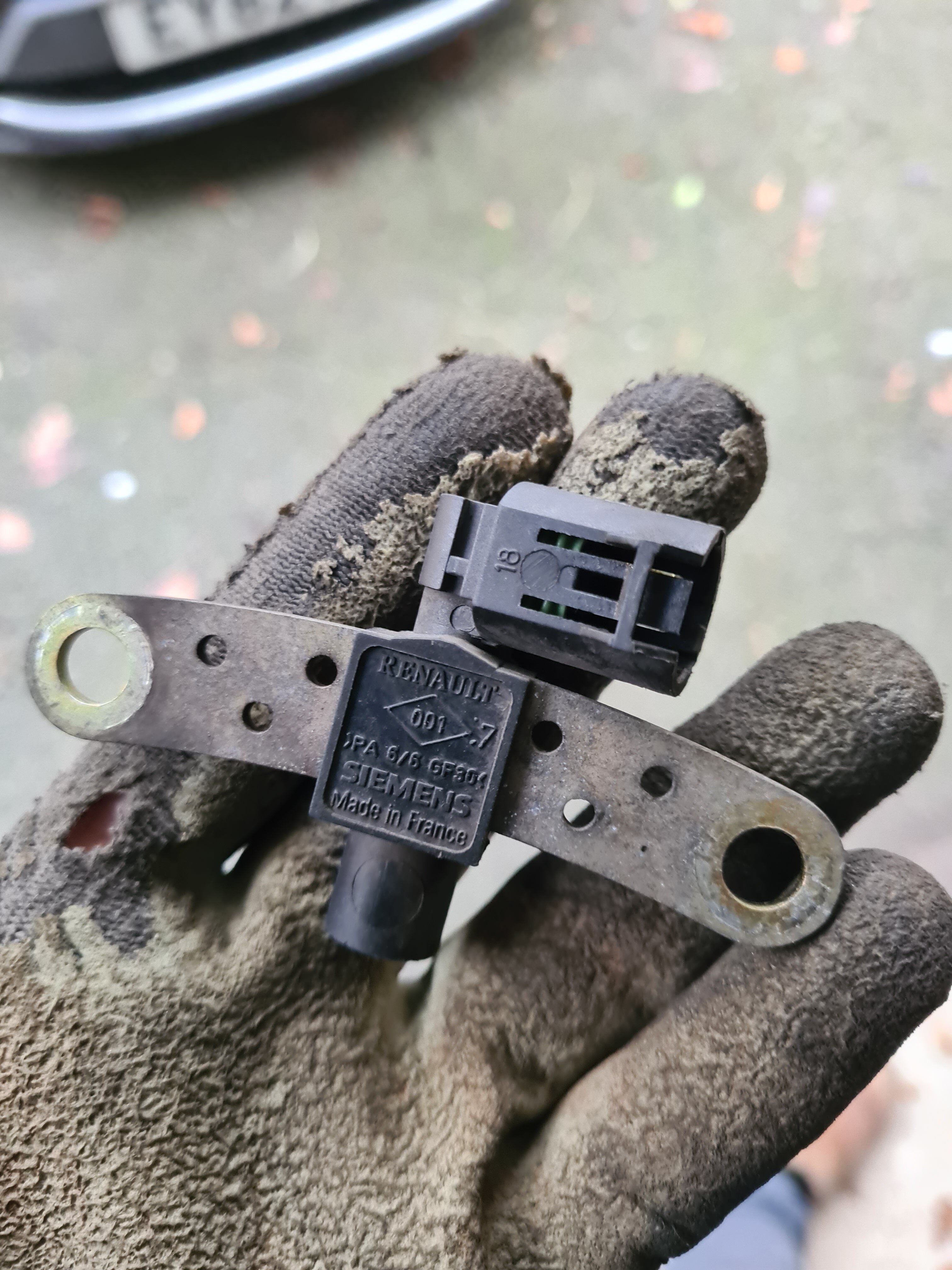

So when I had the TB off I took the TDC sensor off and cleaned with some wd40 around the metal nub bit.
Just put it all back together making sure all is connected and now it turns over but obsolete no spark at all.
So my question is have I found my problem with the TDC sensor or did I just break it?
It's weird that having reinstalled now it literally won't start for love nor money which is supposedly a sign of an issue with the TDC sensor so I'm hoping it's this and a replacement part is all it needs.

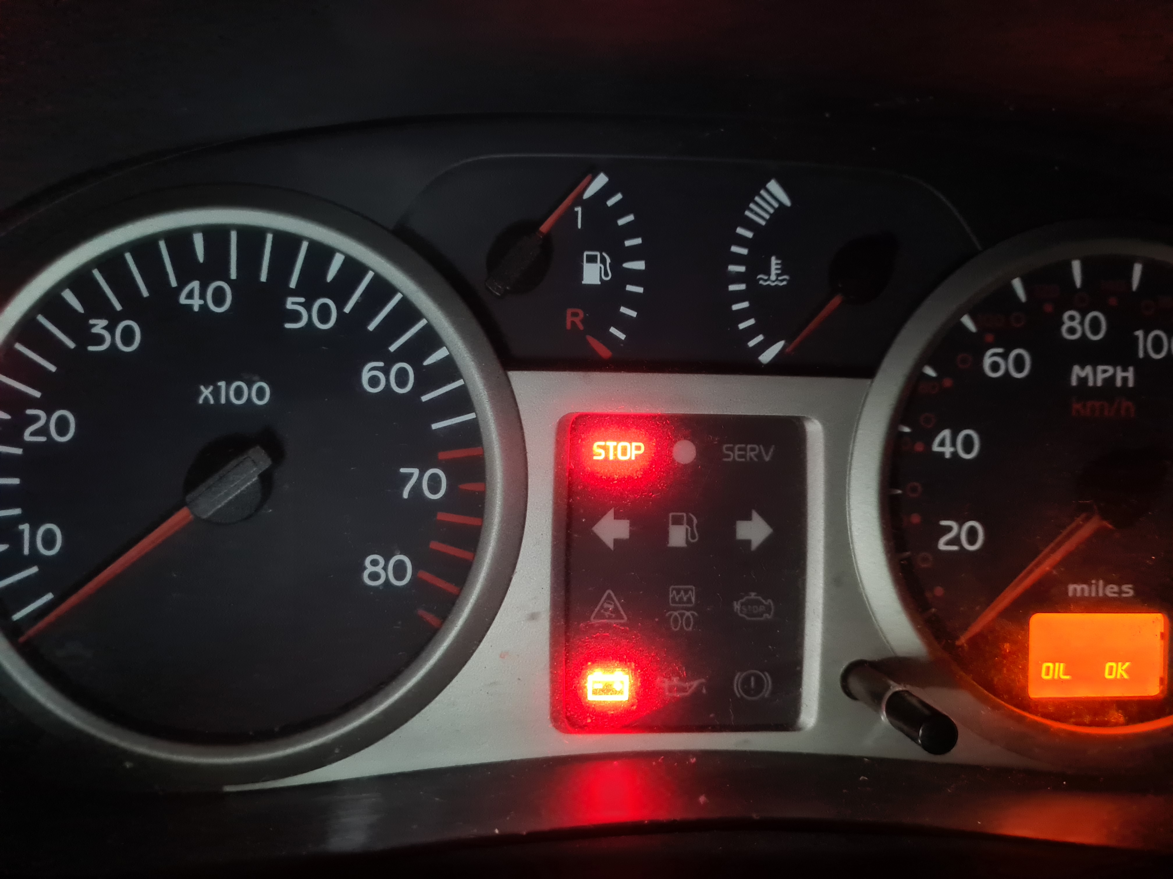

What colour crank sensor do you have too? And what is the immobiliser light doing?
Thabks for all the replies btw I really appreciate it.
So its the standard TDC I don't think it's ever been changed. The immobiliser light which I think is the one between stop start is blinking red. The light near the gear stick doesn't come on.
It may or may not be worth mentioning that for some reason every time I try and lock the car it locks but let's out a high pitch whine/beep and light near gear stick goes red. Doesn't stop the horrible whine until I unlock and open and close the door.

Ok tried disconnecting the battery both leads and everything comes back on but the car turns over fine but no spark.
I'm not sure if its an immobiliser thing as I've had issues with that before when the battery has died but it doesn't allow the engine to turn over does it? This is why I'm suspecting the TDC.

Tdc sensor plug might be the cause of non start.

No spark means it's likely a crank sensor issue or maybe the coil
