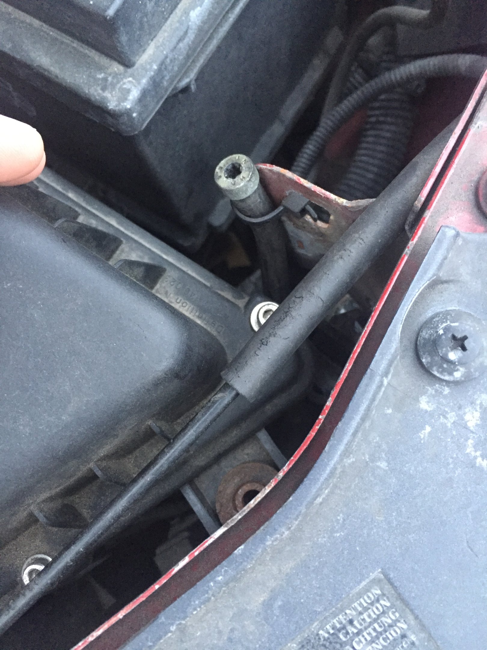

Also noticed a pipe that had been disconnected and bunged with a bolt from this area, pic for reference. Would this be to do with the acoustic valve?

The car seems to have had the acoustic valve blocked. Probably had a foam filter silcone type air induction on it at one bit.

The acoustic valve is probably stuck/held wide open, which isn't a concern.
