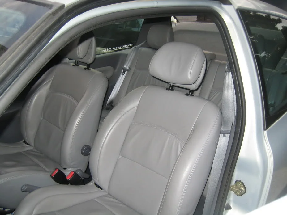

Im tempted to wait, have you got the sport interior if so have you got any pictures Mitch..?
Why yes I have Chorley, but mine are rarer than rare. They are full leather from the Renault Sport Clio 172 Exlcusive, of which only ermm............172 were made. :D
