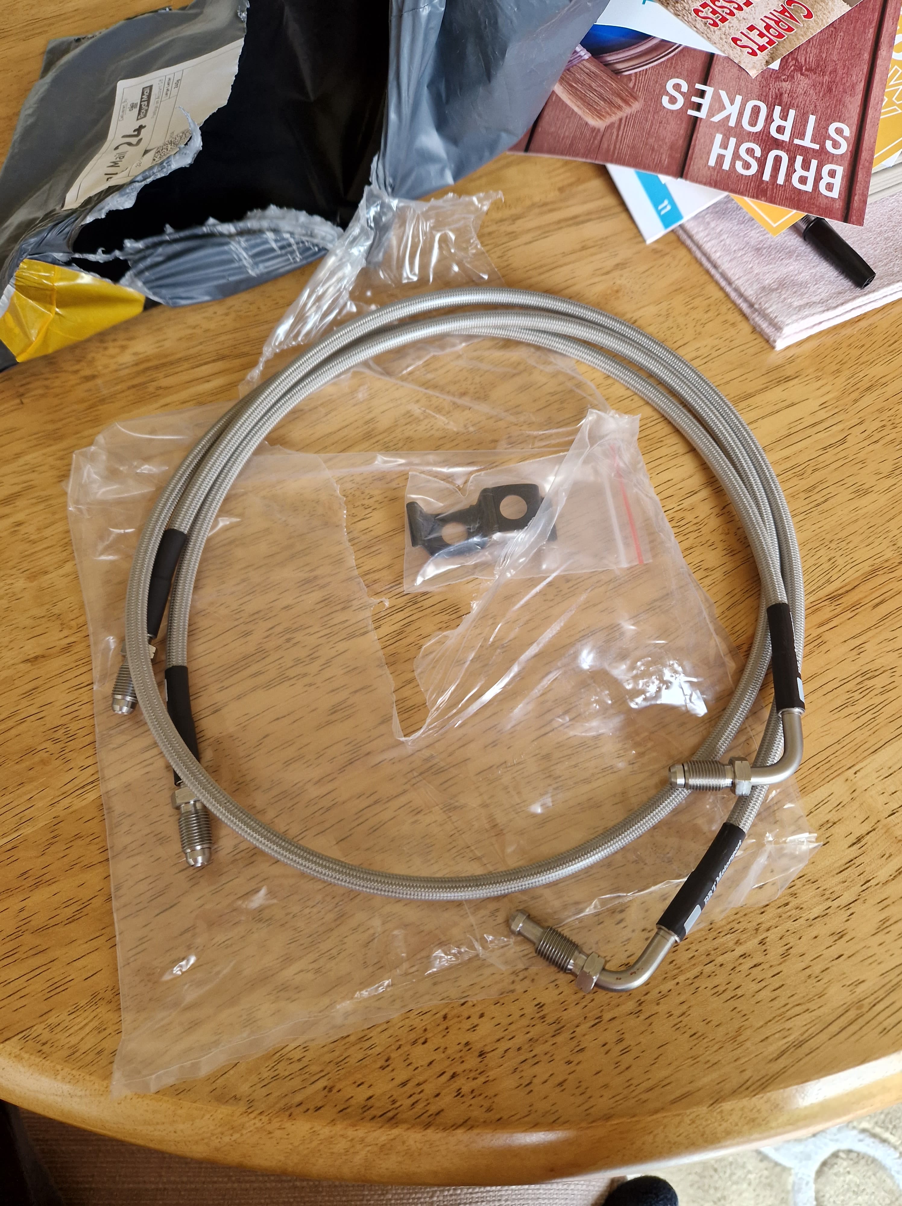

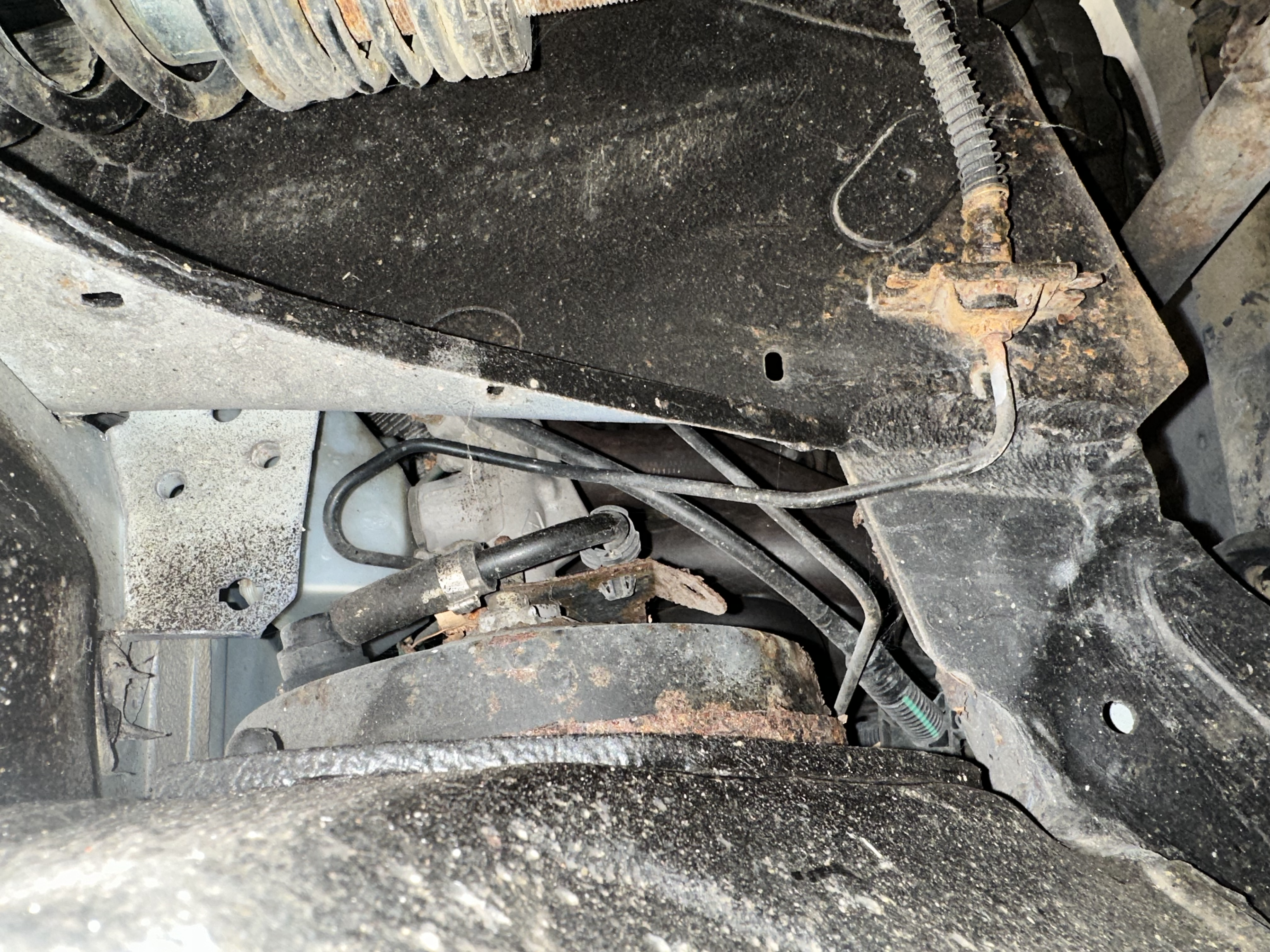

Hi all. I tried to fit some braided lines to my car this evening but when I tried to crack the brake line from the nipple it twisted the metal brake hose, this was in the wheel arch. Id like to know the part numbers or diagrams for the front brake hoses. Id like to replace the solid brake lines from the main brake cylinder to the wheel arch. I can't find anything online apart from the full braided set.

Speak to Paul BRT motorsport. He's a member on here.
I gave him the requirements for new braided lines from ABS pump to front braided lines.
Specs are as below, but mention my name and what you want and he'll remember.
1230 line (clear) with 90degree swivel m10x1 to straight swivel m10 x 1. Then the same with 580 line including 2 retaining clips.
