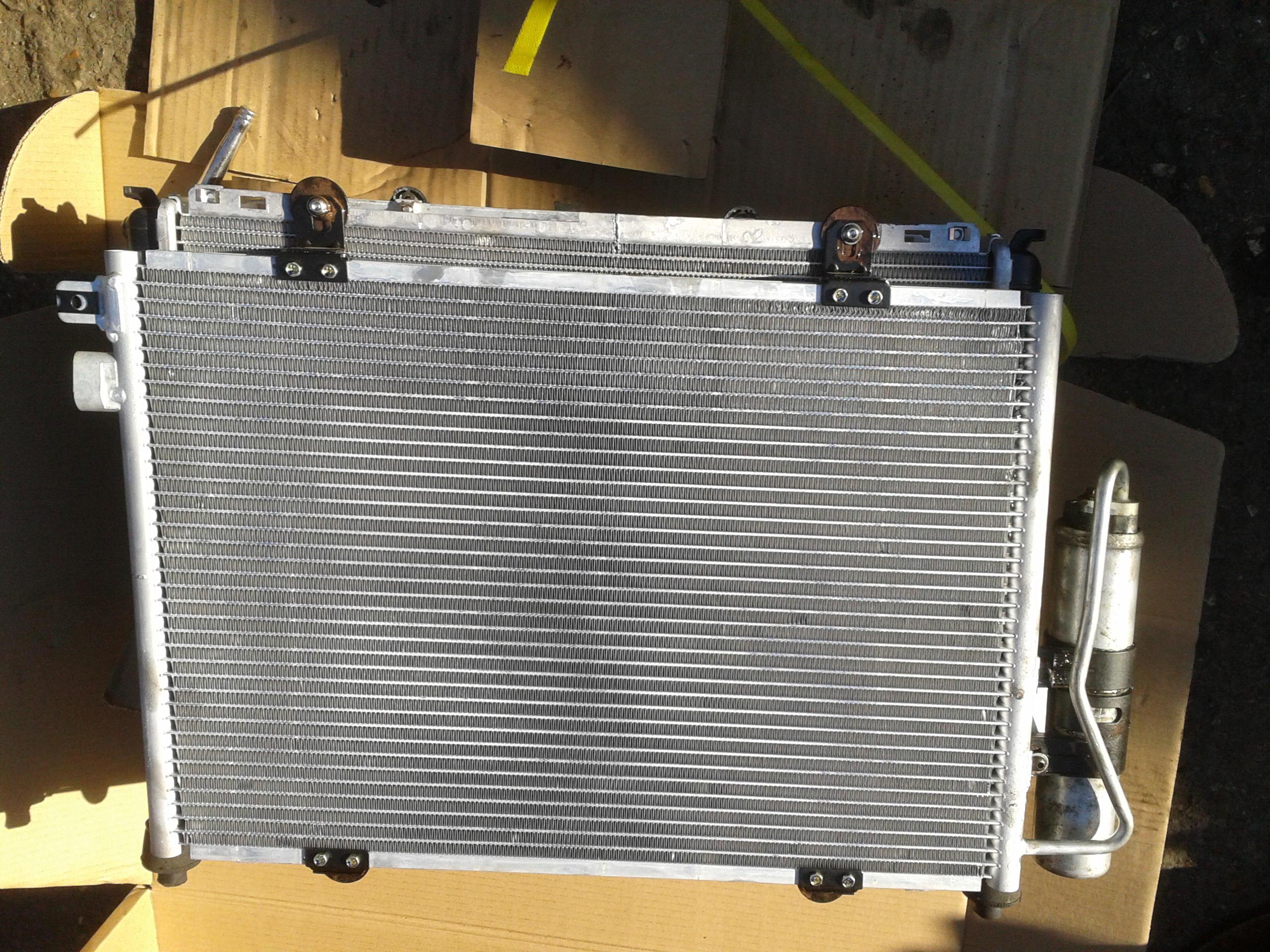

All new input is always appreciated, but where is the A/C pressure switch located on the condenser?
Hi Steve, many thanks. It's not shown on this photo, but is located in front of the air box air intake pipe. Had we not taken out the air box, we wouldn't have seen it. I can photograph our car if it helps, but don't know if this is universal on all similar models.

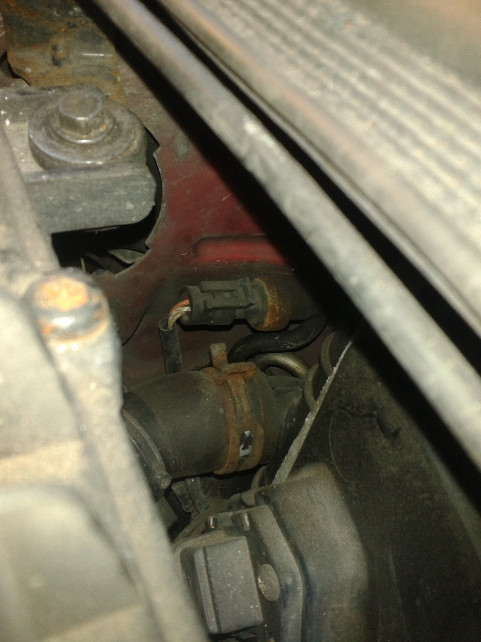

I assume it is this plug with 3 wires next to the rad top hose?
Which wire is the 5v feed, and what exactly was the fault.
Was there any other tell tale clue, such as the compressor not engaging?
Hi Steve, that's the one! I will have to come back to you about the three wires/wiring code if I can locate the wiring diagram we downloaded. All we did was disconnect this sensor and it finally allowed us to clear the engine codes which had placed the car into permanent limp. The air-con was not working on this car before this latest fault, but we think that was a gassing issue.
If this sensor is faulty then the air conditioning will not work. I am not sure what you issues are, but if its engine issues/limp mode etc, the best advice would be to disconnect the sensor anyway and see if other issues resolved.

Is it fair to say that you are not 100% certain that the switch is at fault, but that you have found that the fault is eliminated when the switch is disconnected?
Hi Steve, that switch is correct one. It is definitely switch which has short as if it was wiring or anywhere else on car, the codes wouldn't clear.
If you know the switch is shorting, fine.
Otherwise it could be downstream, as you have only disconnected it?
Hi Steve, no it can't really as the short that is evident would still be there whether the sensor was disconnected or not. Please remember it was showing a 5V reference fault/short which has now been cleared and not reappeared. Secondly, when the car is scanned (Search System) it now knows the pressure sensor is disconnected - that is only code showing.
